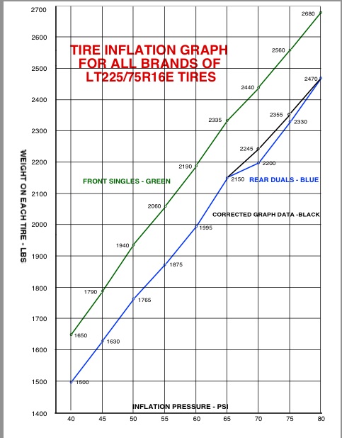

I think we actually aren't agreeing here. What I am saying is weigh your rig (which I think everyone should anyway). Once you have a front axle weight and a rear axle weight, plus the inflation chart for your tires (or at least for same size similar tires), then you read across and down and find your proper inflation.NUUKEEE wrote: February 8th, 2022, 3:02 pm Hey all,
TIRE PRESSURE: Agree with Blue-Go.
Go with tire pressure ratings on the tire.
I can pretty much guarantee it is NEVER going to be 80psi on a 21' Chinook. Why do I say that? Have a look here:
Okay, now for a couple of examples.
1) Let's work "backwards" on the chart for the rear axle. Four of these (stock size) tires at 80psi would be good for 2,470# per tire on a dually setup. That's 9,880#. But our rear axle is only rated (by Ford) to 7,500# MAX (or possibly 7,200 for some older E-350's). So you are either running *majorly* overweight on your rear axle, or your tires are very, very overinflated (reducing contact patch and harshening ride).
2) Let's do the same on the front axle. 80 psi (looking at chart) is good for 2,680# on a single setup (front axle). So that's the correct inflation for the front axle at 5,360#. But our front axle is only rated (by Ford) to 3,700#. So unless you are running the front axle at nearly 50% over its rating, the tires are overinflated. Boo.
Now let's go the opposite way. Let's say you have both the front and rear axle absolutely maxed out on weight. So 3,700# front axle; 7,500# rear axle.
Front axle weight at full rating divided by 2 (two tires on that axle) is 1,850#. Looking on the inflation chart for a single that would be a recommended psi of about 47#. Not 80.
Rear axle weight at full rating divided by 4 (four tires on that axle) is 1,875# per tire. Looking at dually line on chart that would be a recommended 55# of inflation. Not 80.
This doesn't mean you can't adjust them slightly if you want, but I can't see any scenario where 80# would be anything but very wrong. And this is for absolute MAX weight rating on our axles.
(Inflation chart for a larger tire would probably have you at a lower psi, but you can look at an actual chart and see).
IMO people who tell you to put them to 80 and then "adjust" either don't undestand how inflation charts work -- or think you won't understand and dont want to be bothered by details. Or maybe think they know more than Michelin et al? And hey, 80 psi is printed on the tire so there you goNUUKEEE wrote: February 8th, 2022, 3:02 pm The shop said the profile of the tire at 80 PSI will give an even wear (all alignment things being correct) and that if the ride is too stiff, I shoulda, coulda, woulda play with (decrease) the pressure till I am happy ...
