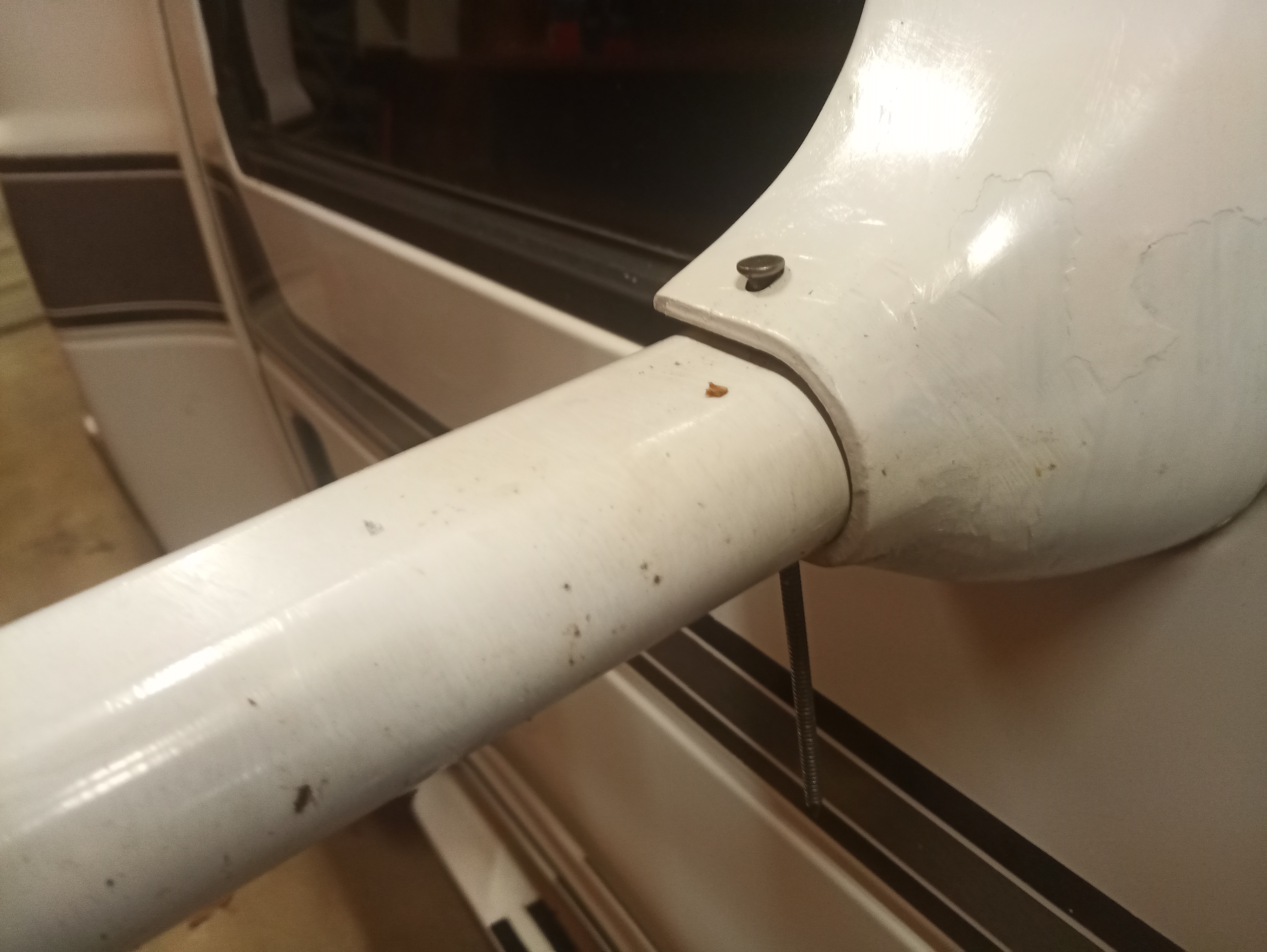

The mirrors folding in on me on the highway got old really quick. I'm not ready to upgrade to the telescoping mirrors yet, so I came up with a 10 minute solution to fix the problem in the meantime.

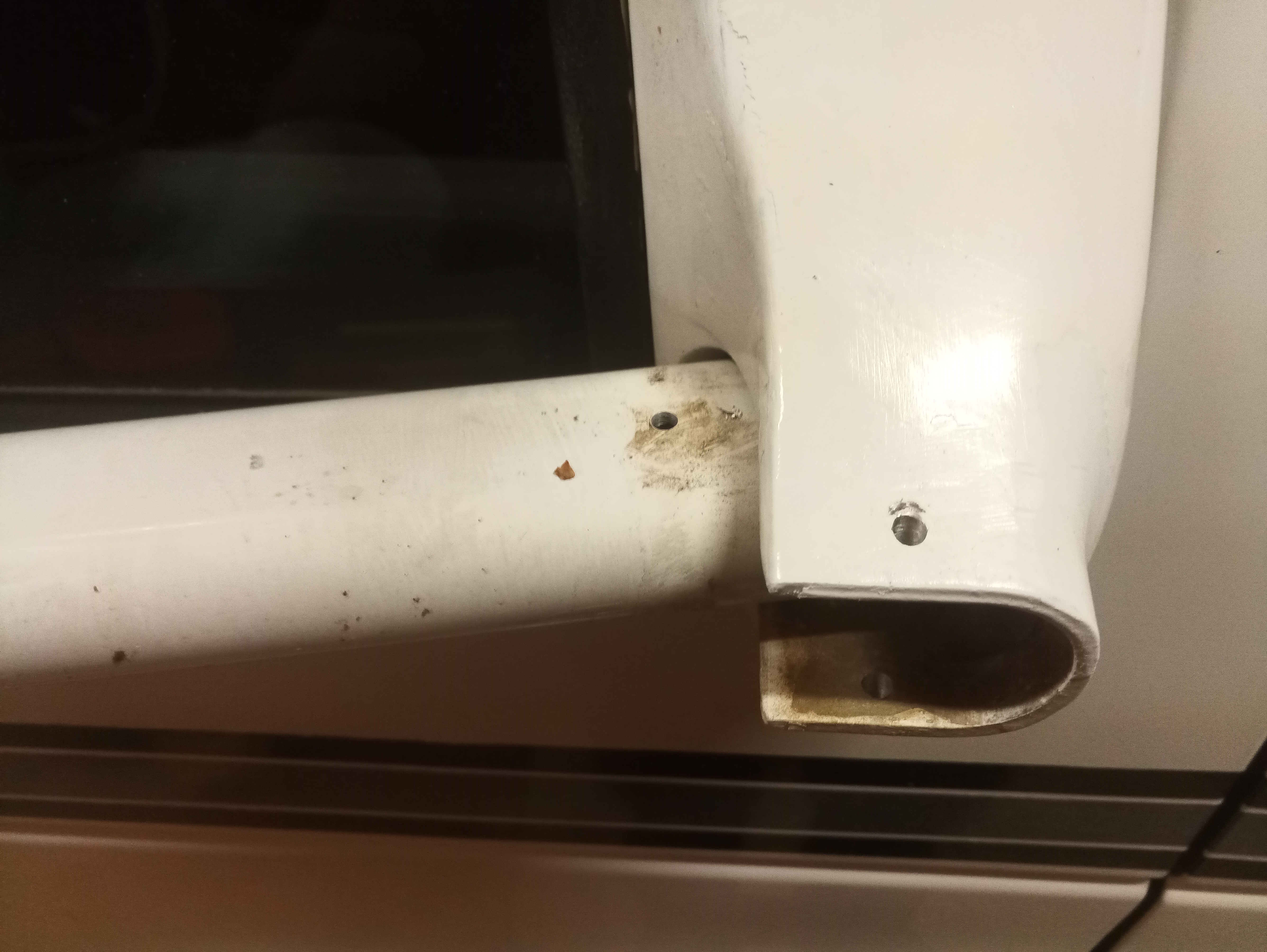

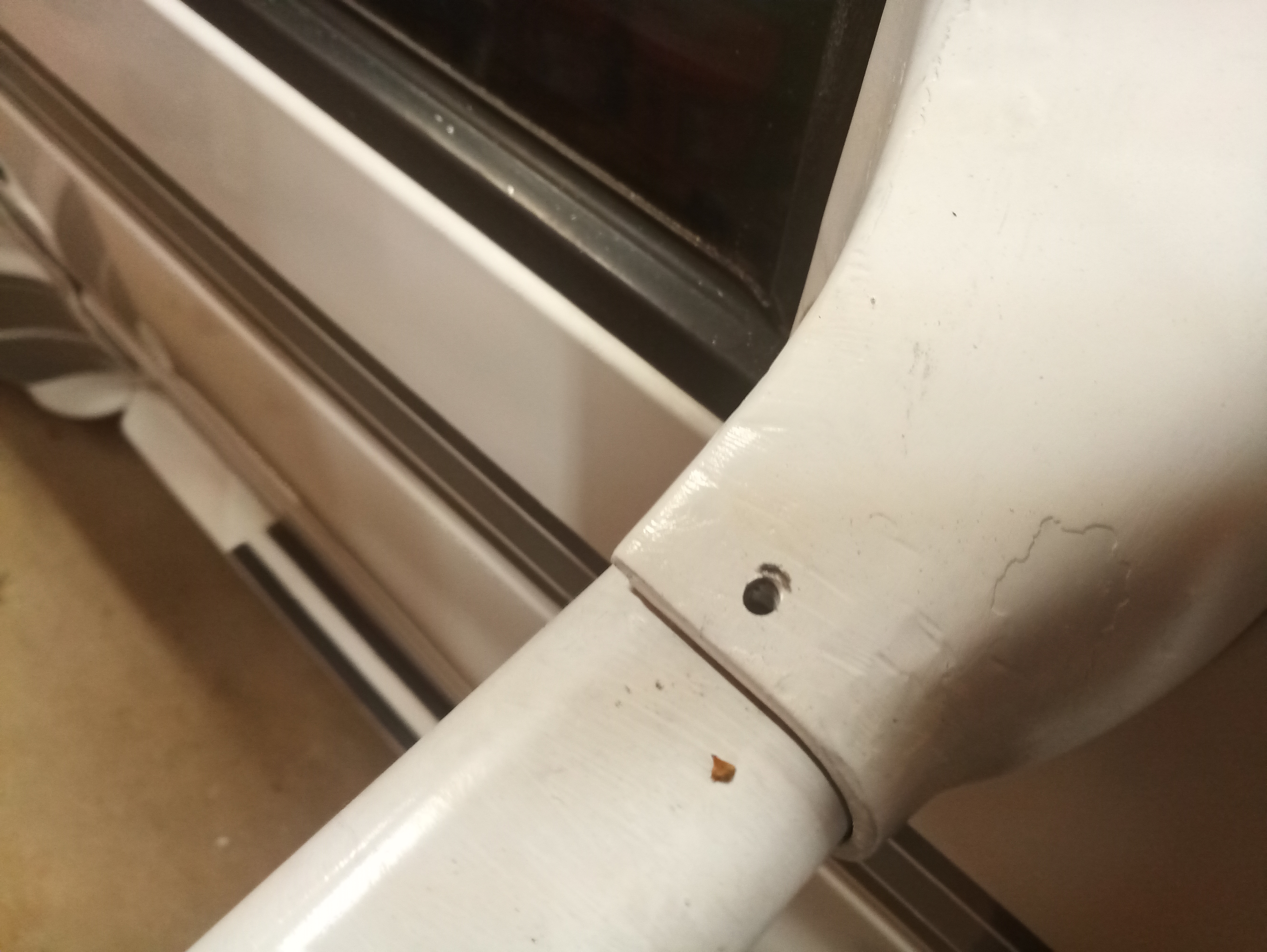

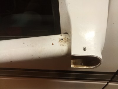

I drilled a hole straight through the top bracket, the arm of the mirror, and the bottom of the mirror. I wasn't sure if there were wires inside of the arm for the power mirror function so I was very careful not to stick the drill bit all the way through. I drilled the mirror bracket first all the way through to get a straight line, then I unfolded the mirror and carefully drilled through JUST until the drill bit broke through. Finished it off by sticking a large nail the same size as the hole through and voila! No more floppy mirrors. The nail head keeps the nail from falling through the hole. I may finish it off by trimming the nail so it doesn't stick out the bottom of the bracket so far.
All in all, a very effective, cheap, temporary fix for a very annoying problem.

There is an adjustment screw there. No amount of tightening was able to stop the mirrors from folding in on the highway. This is guaranteed to stop t hem from folding in and should I need to fold them, I can easily remove the nail.

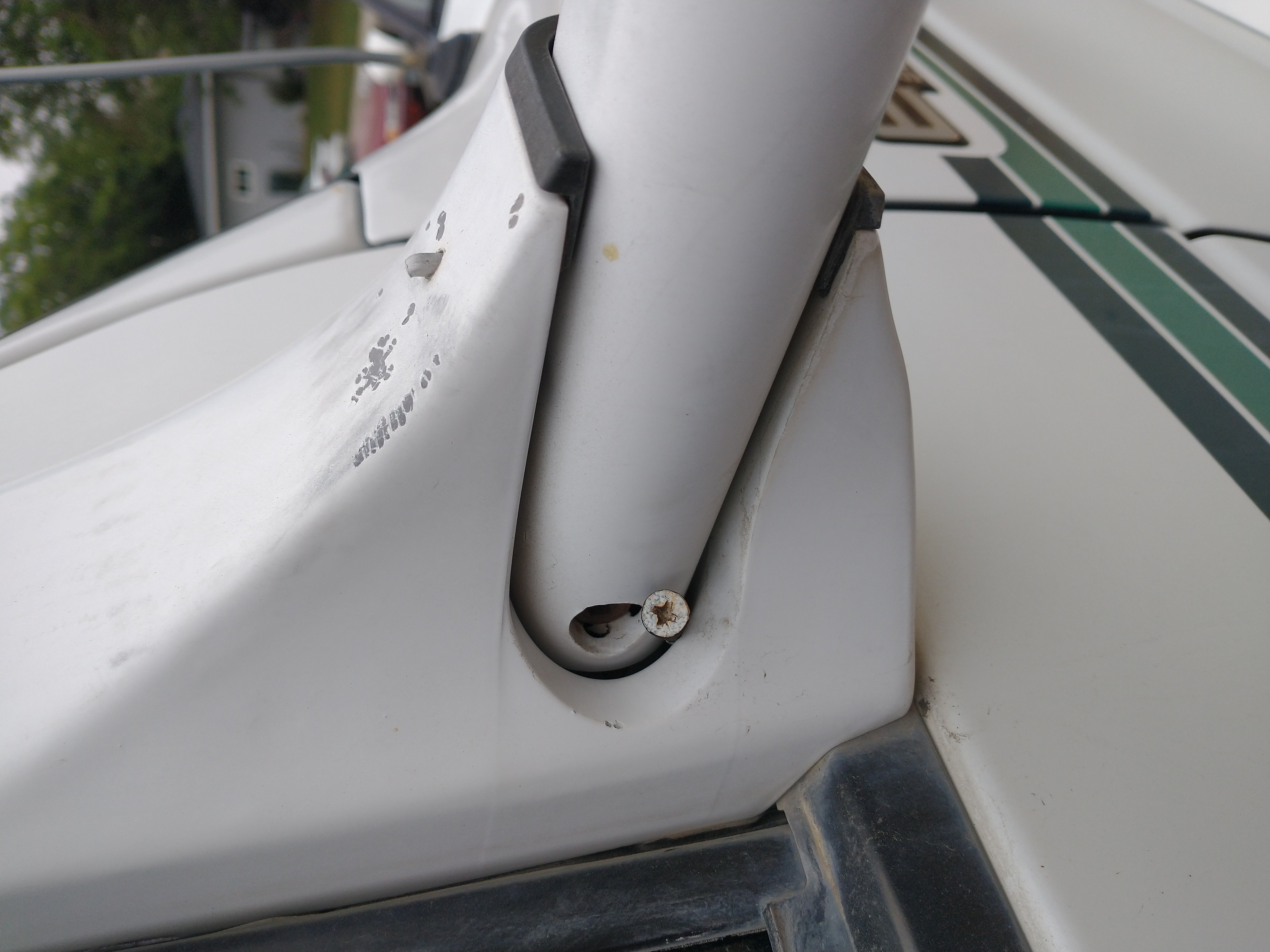

I just put a screw in the hinge by the door with a screwdriver. I too have thought of the break away problem. I will think on the rubber idea until I can replace mirrors altogether.

I think if the mirror we're struck,the screw would just strip out . It's a drywall screw and not hardend steel.

I'm pretty sure that screw is just being used as a wedge. It's not serving in its capacity as a screw, that is, holding two objects together with a clamping force.
