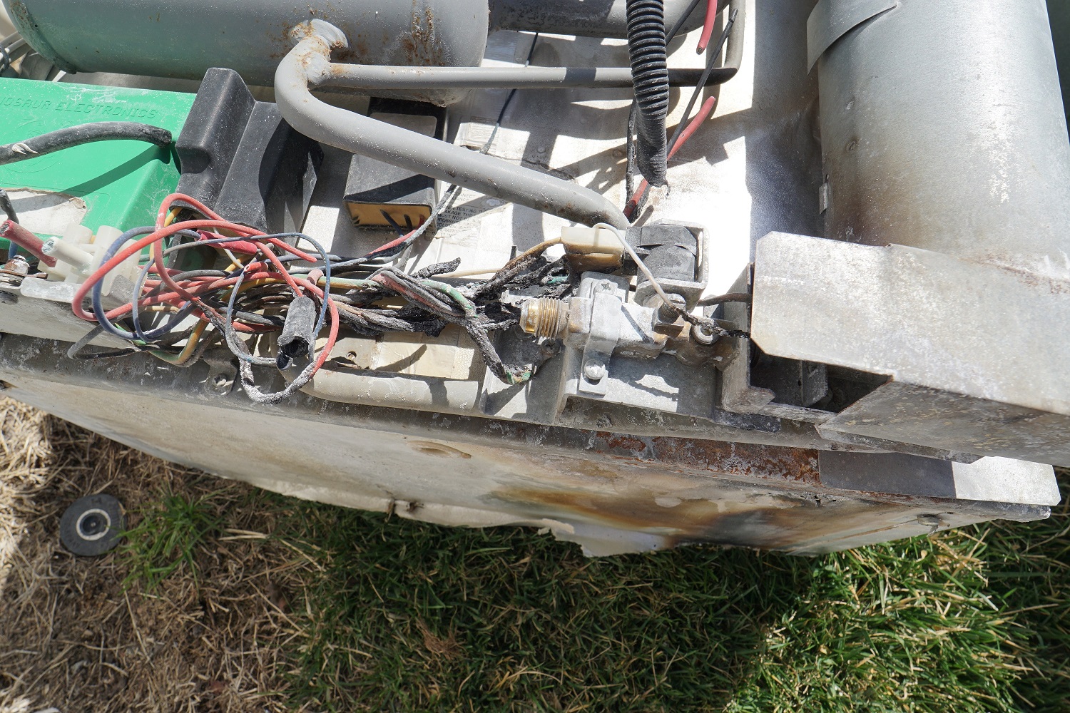

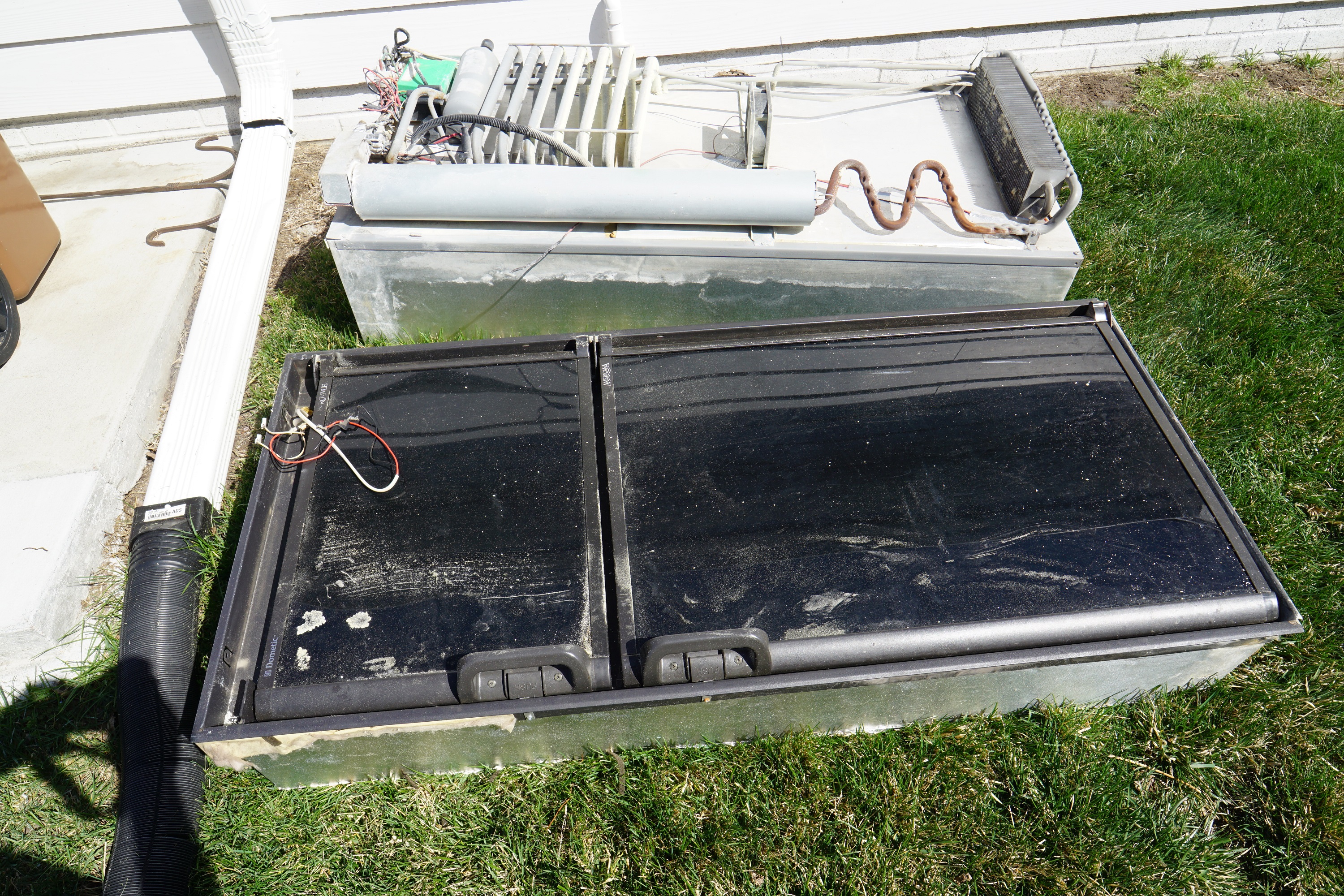

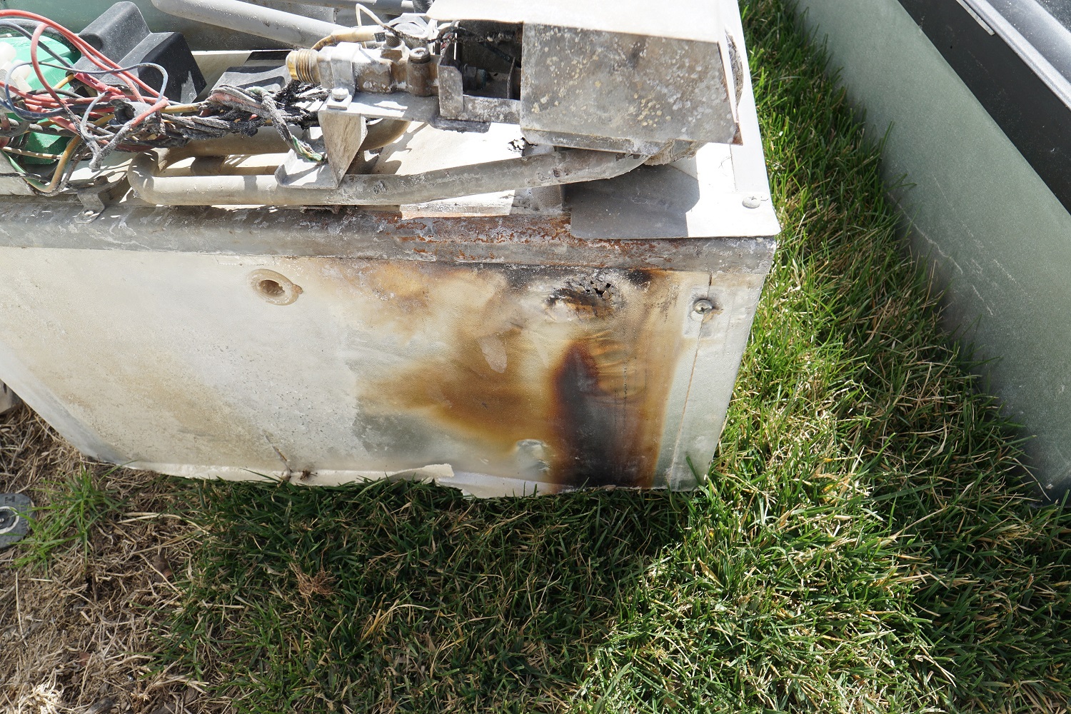

Im not sure how it started. The 110 AC outlet and cord to the fridge were fine. You can see the scorch marks on the bottom of the fridge from fire.
But then you can also see the wires near the propane solenoid all melted because the propane valve was on fire. Sometimes i would run the fridge on propane because it seemed to get cooler on propane than electricity. I cant recall if it was set to propane or AC that day due to all the panic, once the fire was out there was no more checking the panel to see what it was set on.
I broke the vent cover getting it off in a panic, but beyond the fridge being destroyed there wasnt any other damage to the rig other than an extreme mess to clean up from the extinguisher dust. All i know is i smelled a faint chemical smell at first and while i was trying to figure out what i was smelling the entire rig was full of overpowering ammonia chemical fumes. Only then did i actually smell something that smelled like something burning.

From the photo, it does not looks like it has the recall kit installed. It will be great if you have the serial number on the fridge and can confirm if your needs the recall. If it does not, it will be a service to current Dometic owners to let the manufacturer know about this incidence, so they can prevent similar thing from happening.
