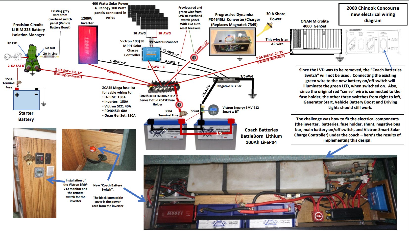

Attached is the design schematic that I came up with along with photos of the results. Pretty proud of myself. Except I have no experience in anything electrical, let along DC electrical. But we are lucky to have a good friend that is an experienced electrician as well as the fact that he does van conversions to RVs now as a living. He just finished converting a Ford Van to an RV that includes lithium technology that he is selling (see Milliganvans.com). Greg is his name and boy he has been a life saver; I couldn’t have done as good of job without his expertise. Wait, I couldn’t have done it without him!

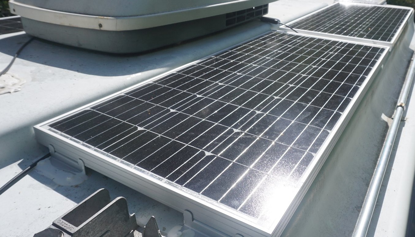

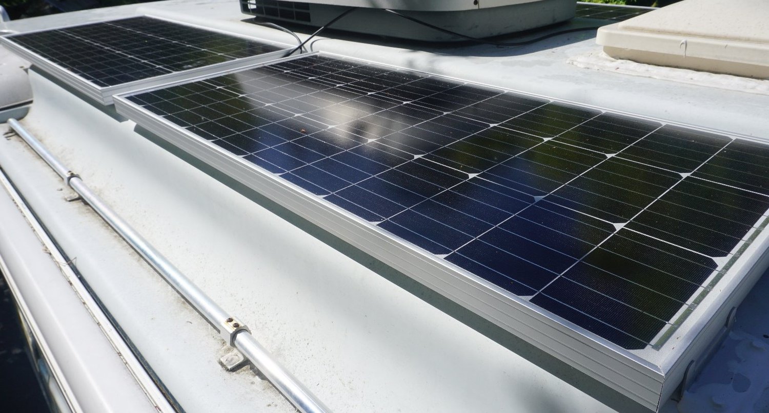

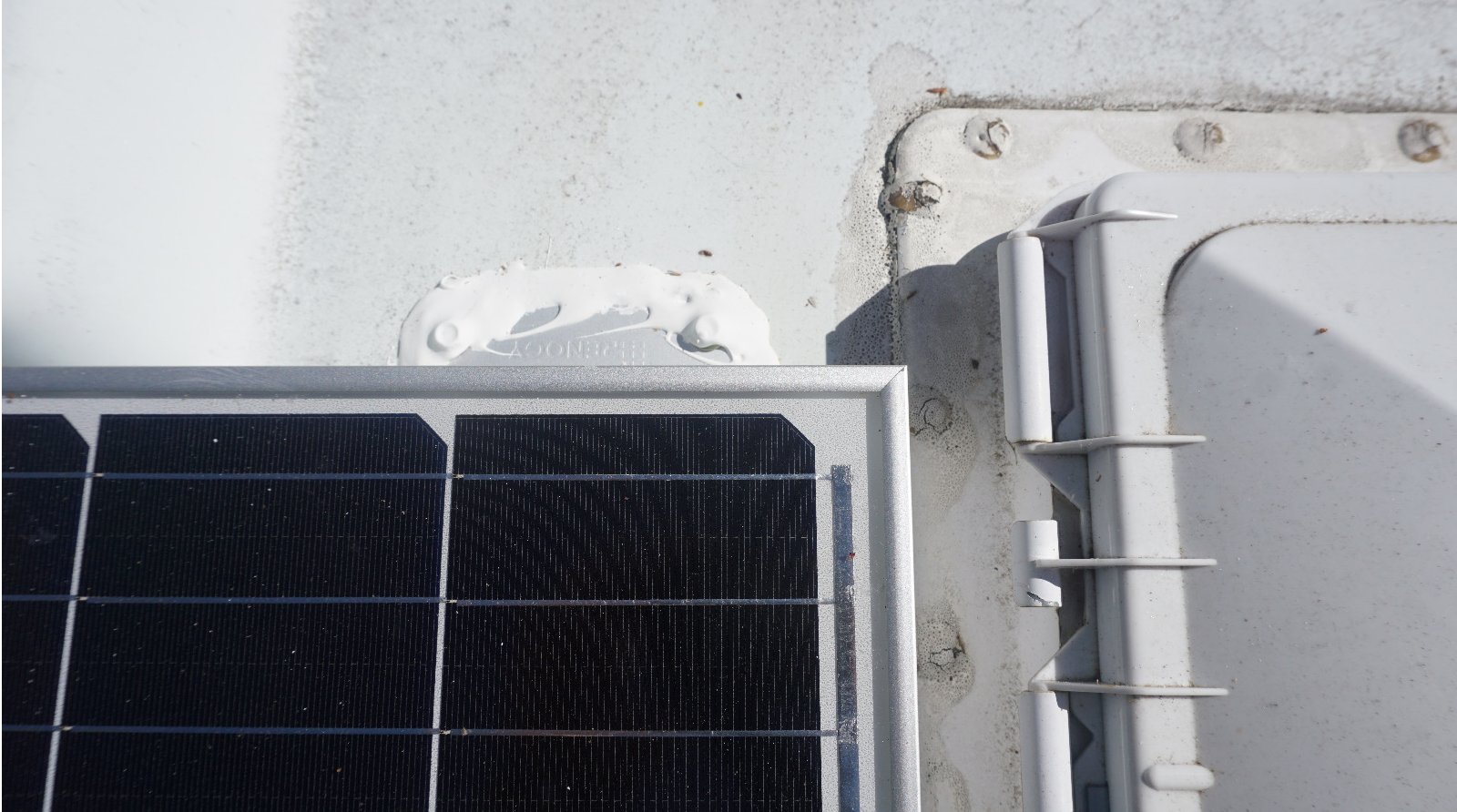

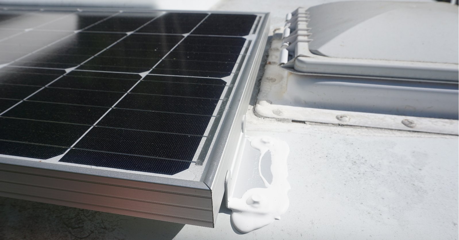

Photos of the 4 solar panels on the roof – they just fit!

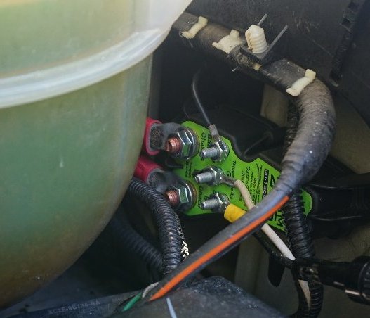

Photo of the installed Li-BIM 225:

I was about to get these 100W Renogy panels, but they listed two different width (1/2 inch difference), and that give me some hesitation. With your pictures, I think they will work well for me. I probably will get them soon.

Awesome job, schematic picture and write-up and , thanks.

I am looking for a battery isolation switch, and the Precision Circuits looks good. However, I really want one with the remote indicator (the original Chinook Surepower one have that capability) so I want to keep looking for the exact one I am looking for. I may end up getting a BlueSea Systems one, but not sure.
Thanks for the reply. The Renogy panels that we installed are the compact version. Their actual dimensions are 19 9/16 inches wide by 42 1/4 inches long. Renogy appears to round their dimensions up somewhat? Anyways they fit exactly on the crucial driver's side using the Renogy Z-brackets facing each end of the panels and the forward panel right up against the antenna base. I decided to not remove that base and use the huge 1 1/2 inch hole for the Gland and the 10AWG wires. Also, not seen is I had to use one of the Z-brackets on the side of the panel because the back panel is very close to the edge of the bathroom vent. See these photos of the back panel on the driver's side:
I do miss some sort of indicator that the isolator is doing it's job. I have been having some difficulty in testing the PC Li-BIM. I need to drain the batteries a little and then drive the RV and have my wife read the Victron Monitor to indicate that a charge is being applied.

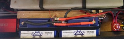

I did not have to move anything out of the way, including the plumbing components. What I did do is construct a little platform over the hot and cold water lines so I could put the Victron Shunt on it, as well as run the converter/charger positive cable and the inverter positive and negative cables underneath. This is a close up of that little platform:

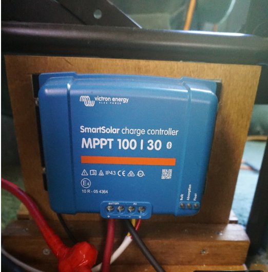

The other thing I had to figure out is how to place the Victron Energy MPPT Solar Charge Controller. It needed to be upright, not flat. So I built a little wall supported by 2, 1 1/2 inch by 1 1/2 inch pieces of wood sandwiching the wall. This wall platform is just inside the end of the couch frame so that the end panel with the wooden document holder fits right back where it supposed to be.
I put a piece of plywood to cover the carpet and the batteries were installed on top of that and they are flush right up to the original piece of wood holding the hinges that support the drop down panel so I can get in to view stuff, replace fuses, turn valves on and off, and so on...

How do you switch the load on/off with the new setup? With your cell phone? I don't know if you feel it is worthwhile to bring back the coach battery switch functionality over the driver seat. But if you do, see if the following is the right accessory for the purpose:

Both the Victron Battery Monitor and the Solar Charge Controller have built-in Bluetooth. I just download the Victron Connect Application to my smart cell phone, and I can monitor the voltage etc of the batteries and the charging of the batteries by the Solar Charge Controller. Don't need anything else. The Victron Solar Charge Controller does not have a connection to the loads, only the battery bank.
I still wanted to simulate control by the Coach Battery Switch on the overhead panel, so I installed the on/off switch on the positive line to the Progressive Dynamics Converter/Charger from the battery. I also connected the old green wire originally on the LVD to the "Vout" of the switch so the green light on the overhead panel goes on when I switch it on. Of course, when I connect to shore power the light does illuminate no matter if the switch is on or off, so I do have to be mindful of switching the switch on so the Converter/Charger charges the battery bank
I do not control the Solar Charge Controller, except when I would turn off the Solar Disconnect Switch, which I will normally always leave on. I would disconnect the panels only if I want to test other things that charge the batteries, or do some work on the electricals. For example, if I do drain the batteries to see how the BIM works, I would disconnect the solar array from the charge controller and start the Ford and drive off and have my wife Ann tell me via the cell phone what the Battery Monitor is telling us about the voltage, etc. It is very sunny here in Northern CA, and my 400 Watt array would be also charging the batteries as I chug along...
I hope this makes sense. My friend Greg also wanted to know why I added the new "Coach Battery Switch" since he felt it was not necessary, but I wanted it as a safeguard. Why would I leave the loads always on to drain the battery if we are not using the RV? The TV is on standby draining the battery and the other stuff is on, like the LPG Detector, etc.

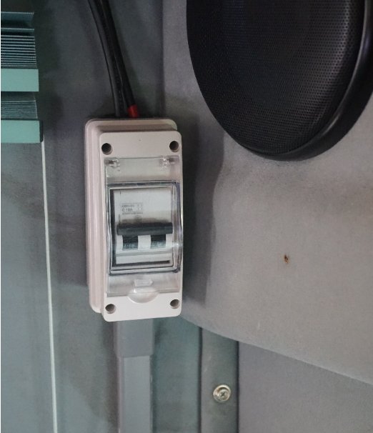

BTW: Here is a photo of the Solar Disconnect Switch, which apparently is required by code. In my case, I just used a low-voltage DC Miniature Circuit Breaker as the switch and put it inside a small distribution box:
I really, really tried to remove the pillar so I could run the PV wires down though it, but I gave up. I just got a conduit, painted it grey and ran a 10 AWG, duplex wire from the disconnect to the Solar Charge Controller. Not too elegant, but at this point only my wife and I can glare at it!

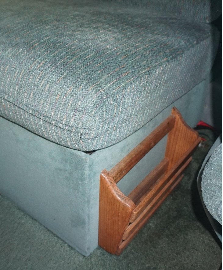

I decided to take a few photos of the lithium upgrade after putting the couch bottom back on. Boy what a job that was. I hope I never have to remove it again...

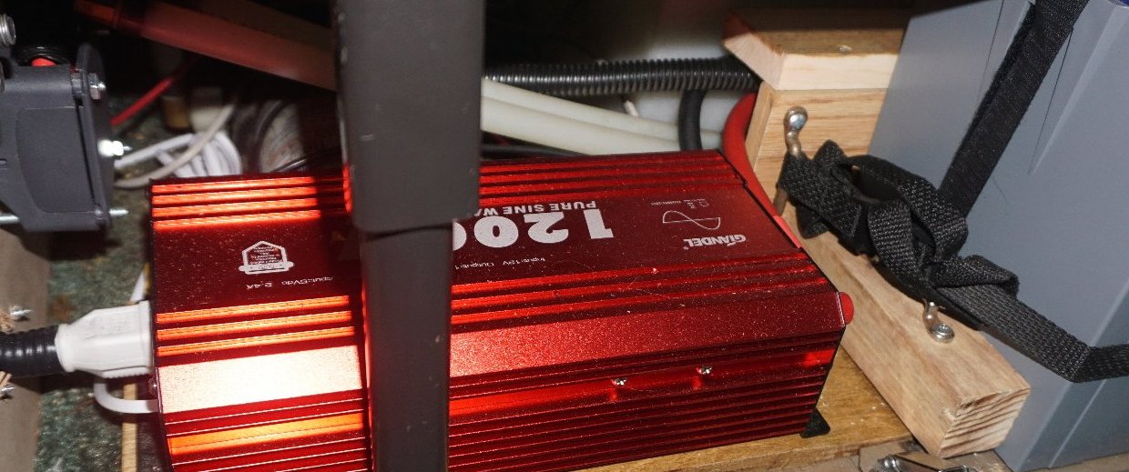

These photos show how everything fits tidy underneath and are reachable. One thing I should mention is that I had to search for an inverter that would fit on the aft portion of the couch. I could not be more than 6 inches wide or more than 11 1/2 inches long. The Giandel 1200 Watt Inverter fits perfectly being that it is 5.5 inches wide and 11.2 inches long. Also the batteries, of course, must fit and they do rather nicely. They are wider at the top than the bottom, so they fit flush to the drop down panel at the top, but there is little gap at the bottom.

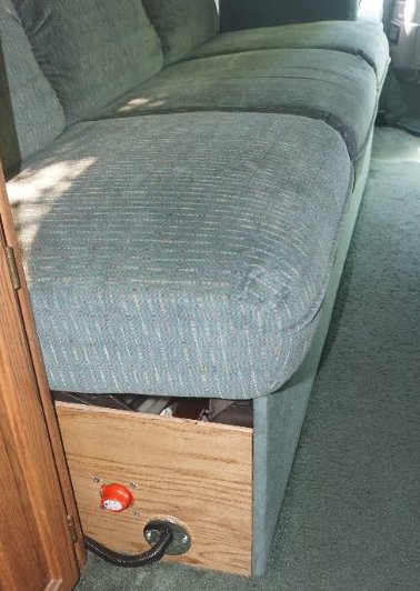

This first photo is the aft panel replacement. I cut the top a little shorter because the original panel was scraped at the top from moving the couch down flat, so I made it shorter. A little bit more than I wanted, but alas, it will let air in/out. This shows the new "Coach Batteries Switch" and the power cable coming out from the inverter:
This is the other side of the couch with the front panel back on:
This is the inverter - fits great!

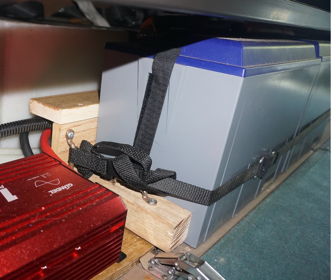

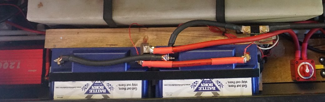

Here's the battery bank showing the fit and the braces used to hold it in as well as the little platform I made:
