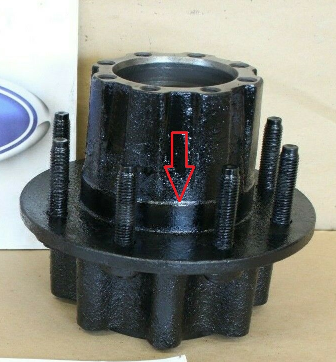

This is the hub-centric shoulder im talking about..
I feel i should also mention that if you manage to sandwich two aluminum Alcoa's on the the rear hub, make certain you do routine maintenance by removing the wheels periodically and smearing some anti-seize or similar product on that shoulder or you may never get the inside wheel off again due galvanic corrosion.
