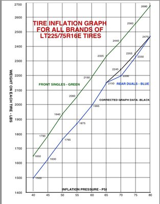

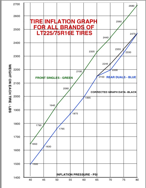

*These recommendations go by tire size, and by actual loaded weight on each tire, not by "door sticker" or the max inflation per tire. Basically, you weigh your rig (which is good to know in any case) by axle, and then divide that figure by the number of tires on each axle (to get weight per tire). Note that you want to inflate all tires on a given axle to the same psi, so don't "individualize" them but rather just divide axle weight by number of tires on that axle (if your weights are really off side to side, then it's better to adjust the load in the rig to even them out). Then you look at the appropriate chart and inflate accordingly. This matches the air in the tire to the load (which is the whole idea behind inflation numbers). Here, for example is a generic chart for the size tires I have on my Concourse:

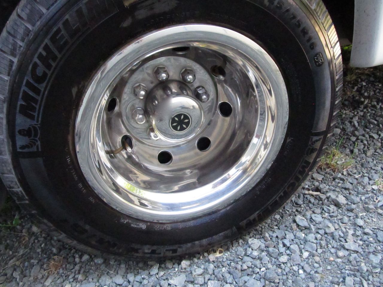

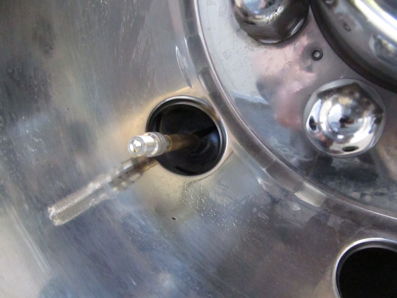

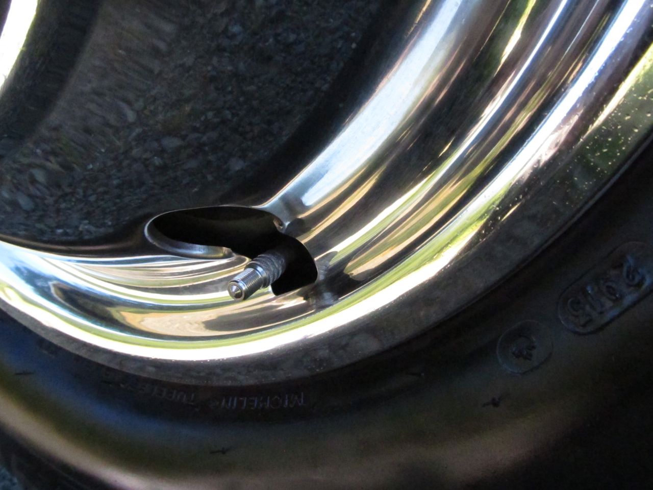

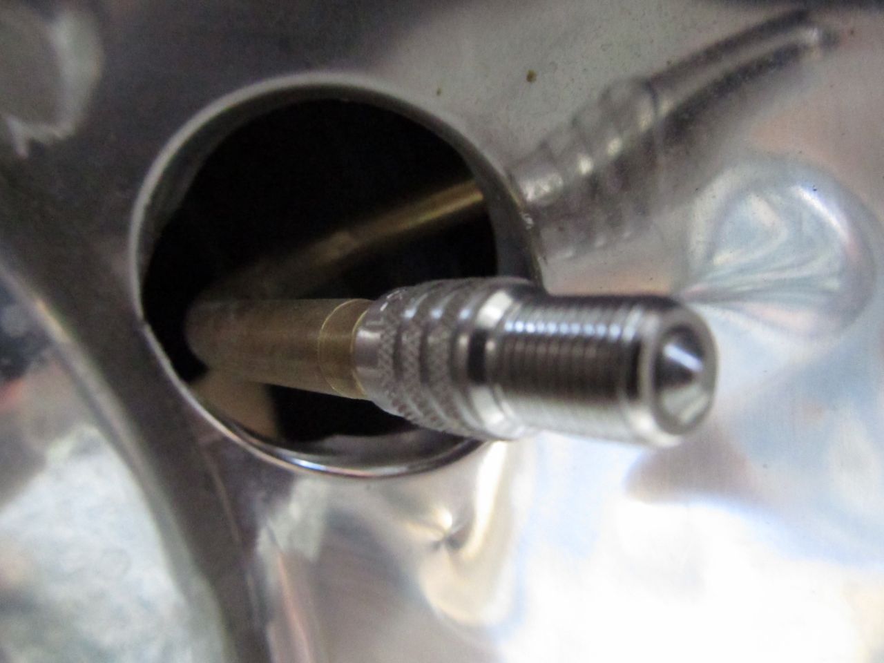

Here are some closer images:
Rear inner wheel stem:
Rear outer wheel stem:
Front wheel stem:

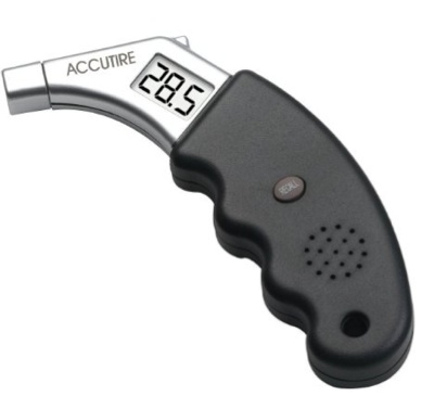

1) A "talking" tire gauge a friend gave me. This displays the tire pressure in digits, and also "says" it out loud. Very handy as I can just put it on and off quickly, and then be on my way to the next tire while the tire gauge "tells" me the pressure in the tire I just checked. Mine looks something like this one (an Accutire MS 4441GB, which is now just under $12):
Accutire MS-4441GB.jpg (27.09 KiB) Viewed 14176 times

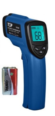

2) An IR thermometer. This is handy for so many things - I consider it a must-have (and they are relatively inexpensive now - I think mine was around $25). I shoot the tires, etc. with it from time-to-time when underway, because some issues will show up as heat. They generally have a red laser pointer, so you just aim that where you want to check and press the button. Here is just one example, a Top G TG8380 (now under $20). Really great tool for much more than tires.
TopG TG8380.jpg (24.05 KiB) Viewed 14176 times

I know this is an older thread... I recently replaced my tires and at the same time had the Borg/Duallyvalve valve stems installed. I used Discount Tire which has been great for my cars but they were at a loss with the Chinook. One result is that my wheel simulators are now on the floor instead of attached to my wheels. The valve stems are positioned in a way that the simulators can't be reattached. The valve stem instructions say you might have to bend them (carefully!) to get the simulators back on. Another option I suppose is to dremel out the simulators. Anyone have any advice, experience here? Thanks, Jeff

Mine all fit just fine. One of them might have taken a very slight (millimeters) bit of Dremeling on the back lip, I can't remember now if that was me or someone else (been a few years).
On the other hand, when a buddy of mine had them put on (at Discount Tire no less), they apparently were not able to read and follow the directions, and they put the stems on counter to the way instructed, and so the simulators would not go on at all. He took the RV back to Discount Tire and they re-did them all while he watched them (the first time he just assumed they were competent and stayed in the RV, reading). No charge but he did have to take the time to go twice :(
At least on mine (Tireman brand) they are specified to go a certain way so that the simulators will fit. I have not installed the Borgs so not sure how they describe the process.
When I bought two new front rims a couple of years ago, I put the stems on myself, prior to bringing them to Discount Tire for them to mount the tires. (That way I could just bring the rims/tires in, and then put them on the Chinook later myself.) There was a precise way described to orient the stems in the instructions. It was not at all difficult - I just had to read and follow the instructions.
So I guess it depends: If they were not oriented correctly when installed (which did happen to my buddy at Discount Tire), then I would not be bending them or Dremeling my simulators, if it were me. I'd have them re-do it correctly. On the other hand, I think it's possible to install them correctly and still have to tweak slightly on one or two.
