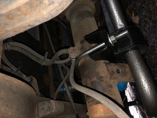

I just got done having a Hellwig 7085 Rear Sway Bar installed on my 2004 Premier. I went with this particular sway bar after reading the various threads on the forum--choosing this as the option that was the not too harsh E450 spec, not too soft as in none or stock, but just rightly made for the e350 (Blue's 3-Bears Description). At the same time, I replaced the original rear shocks with Bilstein comforts, and added a Roadmaster Front Sway Bar to replace the original stock whose bushing were totally shot. I had already put Bilstein comforts on the front. Didn't touch the steering damper cuz what I have seems to be working just fine. I've only driven the Rig for an hour or so with the new sway bars and rear shocks, and it feels nice! Next will be a full set of Michelin 235/75 r16 Cross Climates with Road Force Balance and a new front alignment (just to cross all the T's and dot the I's). All in preparation for what I imagine will be several cross-country runs from Boston to Colorado over the next year or so to visit our grandchild and her parents. Want to make sure that the Rig is in tip-top condition for these trips, especially during the winter (the Cross Climates have the added advantage of being 3 peak snow rated for Colorado, so I won't have to worry about chaining-up as required by the new laws there).
...And now to my question, and the reason for this post.

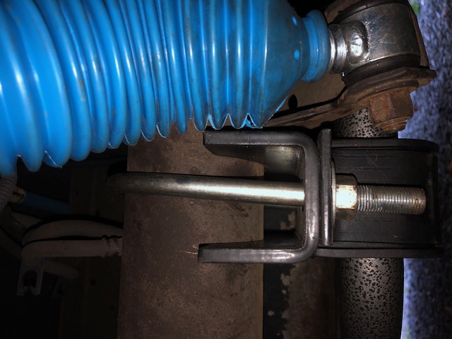

When I picked up the Rig, I had a good chat with the mechanic, who said the install went well. But he did bring one issue to my attention that he suggested that I keep an eye on--he told me that the u-bracket that attaches the rear sway bar to the axle on the driver side was a tight fit (getting it as close as possible to the bottom support for the rear shock), and consequently the top of the u-bolt was pushed up against the rubber section of the brake line just after the top coupling. He did not make it out to be a serious problem or anything like that--just a closer tolerance than he would like to see. And he wanted me to keep an eye on it for any chaffing the rubber brake hose. He said that if I did notice any unusual wear I should let him know and he'd work to come up with a fix. SO, that got me to thinking that maybe one of you all who have installed a rear sway bar might have noticed the same thing...and that you might have a fix in mind.
I have attached two pics of the bracket--one is a rear view, clearing showing the u-bolt up against the rubber brake hose, and the other is a front view of the bracket mounting next to the lower shock absorber support.
As always--any and all advice requested and welcome.

Remove the hose from the fitting that sticks straight up. That hose is a vent line for the axle housing. Remove that fitting and then slip a nylon washer similar to whats on your oil pan drain plug underneath to raise the brake lines up an 1/8th inch or so, screw the fitting back in and tighen it back up. Dont get carried away tightening it up or you will pull the threads in the axle housing. You could also use a copper washer for that matter.

Doug...perfect! Thanks.
