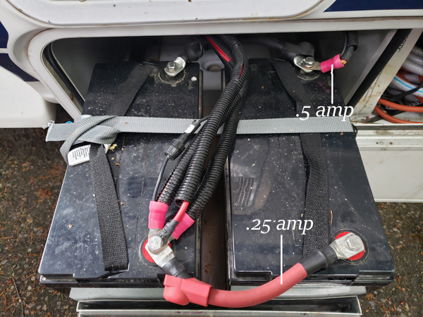

Since we first purchased our 2000 Concourse, I've noticed a coach battery drain during brief storage. I've disconnected CO detector, fire alarm is separate battery, fridge is off. I keep the coach batteries charged with a small smart battery charger (4 stage), so it takes quite a while to get the batteries up if they haven't been charged for awhile. They are 2 100 AH Windy Nation deep cycle, new just 8 months ago. Unfortunately, after the batteries are fully charged, according to the battery charger, the voltage drops to 12.5 - I believe that should be closer to 12.8 to indicate a full charge. Could I have a defective battery?
Previous owners added a monitor (not tv) and a Sony radio in the cab, so some re-wiring was done.
I made some current tests this AM with the clamp-on ammeter and will add an illustration of the results - I am wondering if these current readings are normal. If .5 amp is drawn continuously, that adds up substantially.
We will be adding two 100 watt solar panels and new MPPT controller soon, so I want to work out any phantom load or battery problems before doing so.
Thanks in advance for any and all advice!

The mystery continues...I measured 1 amp at the negative cable first thing this morning and then systematically removed each 12V fuse with both the Coach Battery switch on and off - no difference in any circuit with switch on or off. I did find that the TV circuit was drawing .5 amp and I removed that fuse - the TV had been replaced with just a monitor connected to the original Kenwood VCP.
I also tested with the start battery disconnected - no change.
But there is still .5 amp being drawn even after removing each fuse. Where in the world could that load be if I have removed each circuit's fuse?

Just about all that's left is the LVD and possibly the solar controller, especially if you still have the original. There are two wires from the battery to the LVD, one smaller sense wire and one large distribution/charge cable. You could measure each of the two independently with the meter, and you could temporarily try disconnecting them one at a time and see if the current draw goes away. You should also remove the in-line solar fuse near the battery while you are measuring to get the solar out of the picture.
There might also be a partial short somewhere. There are a couple of circuit breakers between the battery and the LVD that have been know to corrode over time. You could also try temporarily removing the rear connector from the Kenwood unit to eliminate any connection between the coach and truck power systems that may pass through the unit.
