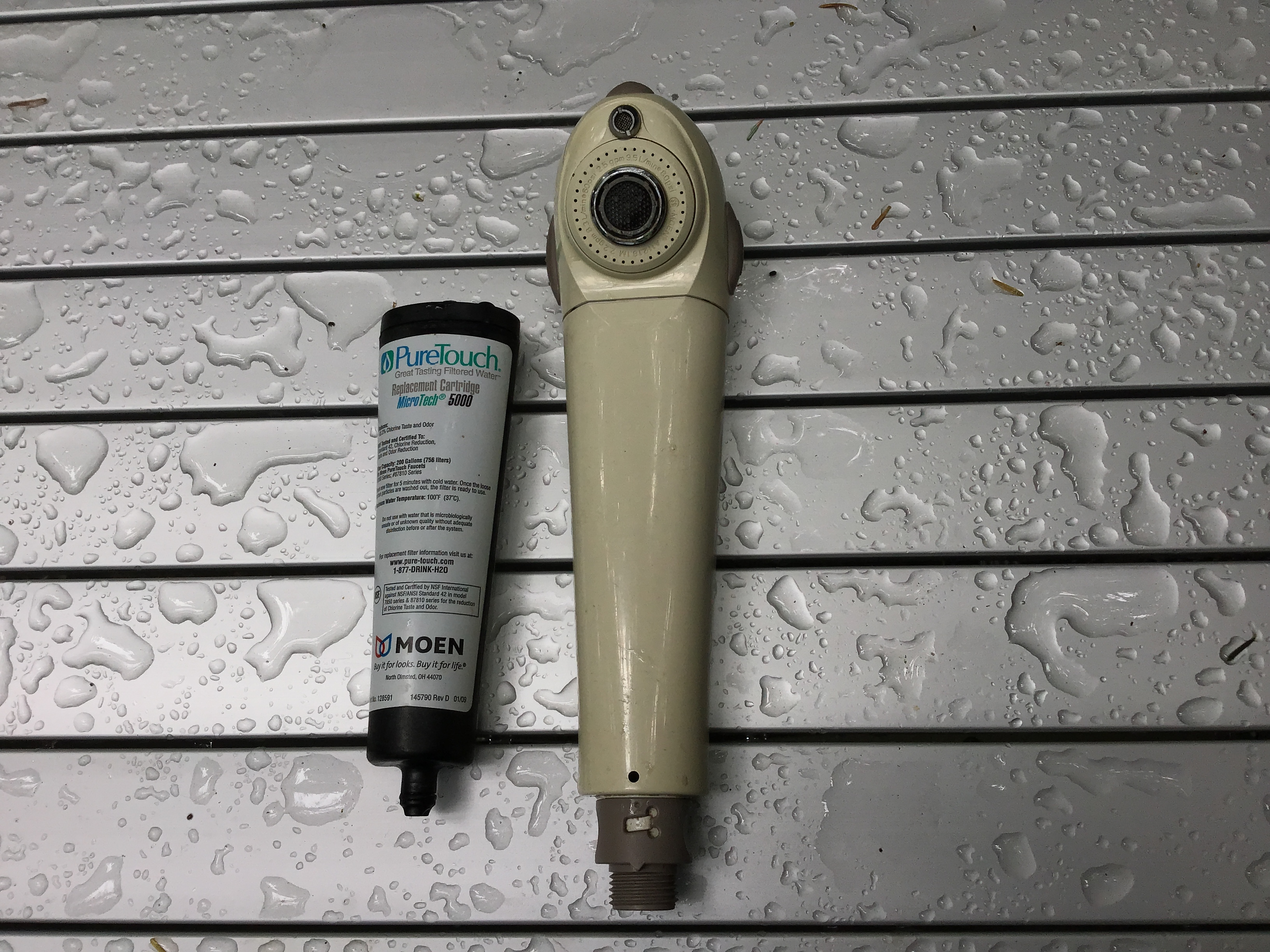

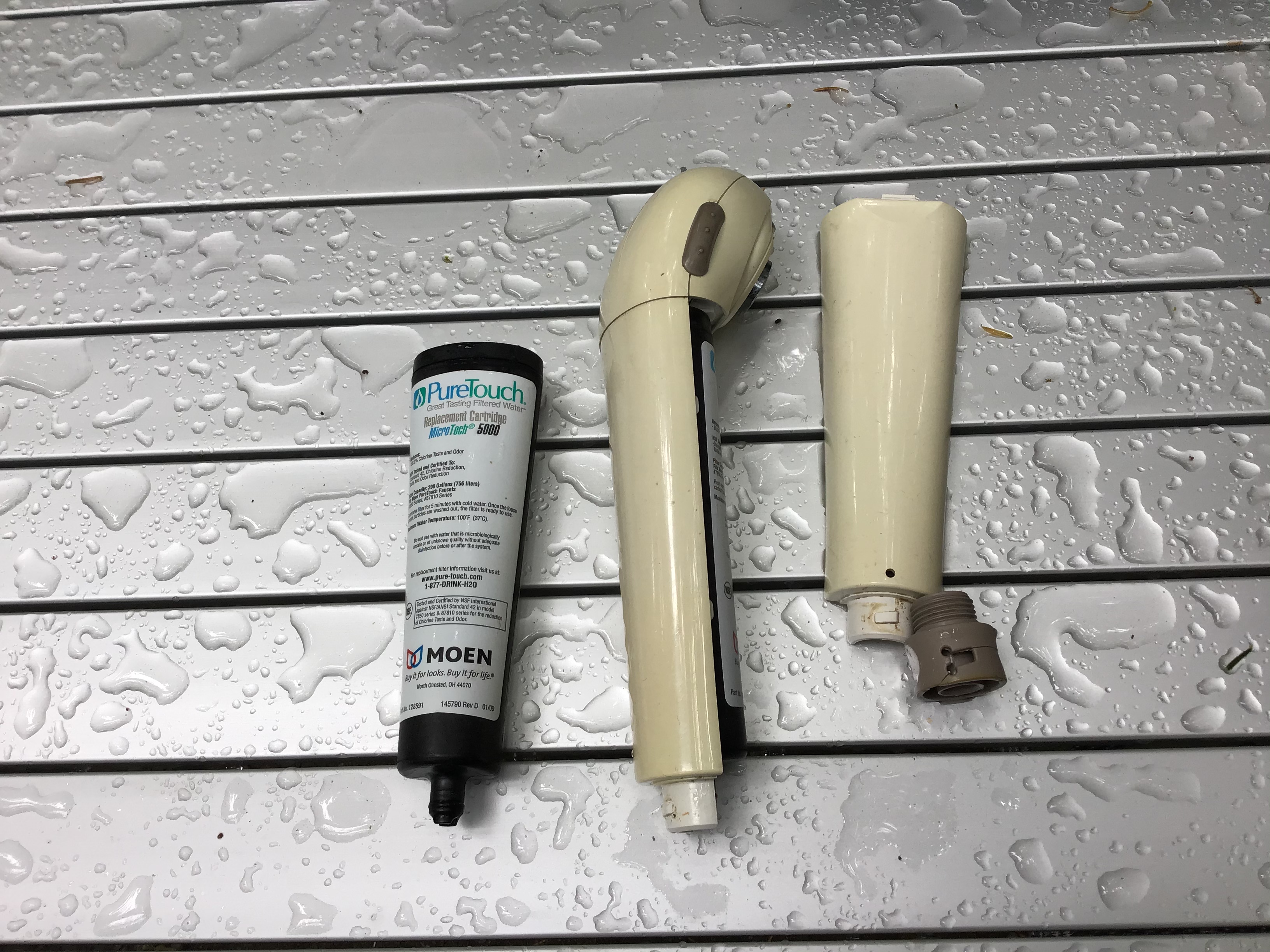

First time use since last fall and our kitchen faucet started leaking in our 2001 Chinook Concourse. Took faucet apart and discovered a crack where it was screwed on and also that there was a filter cartridge inside the handle. Had not known there was a filter Inside. Also discovered a new filter in the cupboard! Decided might as well put the new filter in and see what happens. To our surprise the faucet does not leak anymore! Nice!
Re: Leaking kitchen faucet
Nice. You can still find new old stick filters on ebay occasionally. I picked up a couple two years or so ago.
