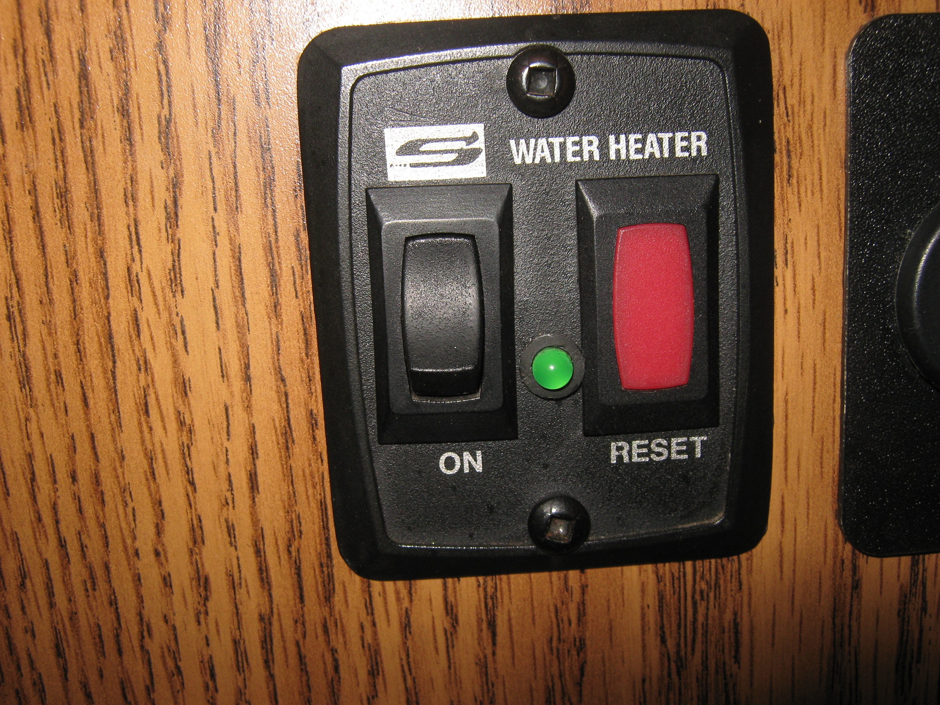

I don't know who designed the status light, but what other said above is how it works. When you turn it on, there is no light that let you know it is on. The only light that will come on is when the automatic igniter comes on. It will light up for a few seconds, and when the flame is going, and the igniter is off, the light will shut off. Why label it "reset" I have no idea. Maybe it can fit shorter than "igniting" or something. But at first, I thought I need to do something when the red warning light is on, and it made me nervous unnecessarily. :oops:
Some people added a LED to let them know that the heater is on, BTW.
Re: Reset Water Heater
Chin_k, that jogged my memory of how it worked (and the odd light and label). As you say, I've seen people drill a small hole and add a green "on" LED. Sounds like a good idea.

Here's mine.
See attachment.
