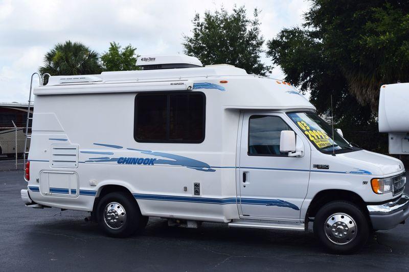

We just put a deposit down in a really nice one owner 2003 Chinook Premier. It was purchased without a generator from the factory - my question is this - do you know if its prewired for one? I see a place for the switch over the drivers seat. The generator compartment appears almost ready for a generator - life would be much easier if the wiring was already there. The dealer is researching but I thought id reach out and see if anyone here knew -

I don't know, but I just removed the original generator from my Concourse, so there are a few things you could check:
1) AC wiring. The junction box is in the closet on the floor (the deep section under the carpet which pulls up). Chinook solid core wiring would come to the box (Onan stranded pigtail went from box through gen compartment wall).
1b) Is there an AC breaker for it in the brown electrical box?
2) DC wiring on your year would come from house bank. (This is power to start generator.) Something like 6AWG. It comes into gen box from rear/side. Positive from house bank, negative to area on rear frame rail where other passenger side chassis grounds are.
3) Mine had a remote start panel in closet wall (Onan panel, hours, etc.) Wiring was extended by Chinook with Onan color scheme (small wires, IIRC red/orange/yellow/brown/black - or similar - about 16AWG) Also switch in cab but that was pure Chinook.
4) Importantly: Gasoline line. This comes from top of Ford gas tank to gen compartment aft side. To add this you would need to at least partially drop gas tank I believe. Yet it's hard to imagine Chinook just having a capped off line?
5) Sheet metal (fire resistant) enclosure on sides and top of compartment, sealed from interior. Does yours have this or is it just a plywood storage compartment, or....?
If I had to guess I'd say this is beyond "pre-wire." The roof air on units without it is pretty easily pre-wired. A breaker, a junction box, some wire in the roof (etc.). But the generator requires more and doesn't seem as likely (but maybe? now you know some of what to look for).
PS: Minor point but also the two side sections of that compartment door would be expanded metal (air intake) vs solid like the center (I can see at least one of yours is solid and has matching stripe).

Thank you for the detailed reply - Its still at the dealer right now - (small local consignment rv dealer). When I opened the compartment it had metal walls and looked like it was ready for one but no wires that I saw. I will share the details of your reply with him now. Thank you so much!

I think the Onan unit cost extra $4k on the Chinook, so if they only charge you $5k for it, it is a reasonable. I am not trying to convince you not to do it, but just want you to have the info if you want to negotiate with the dealer in case they did not give you a good price on the Premier or the genset upgrade.... I see the sticker price says 29995, and do not know how good of a negotiator you are.
