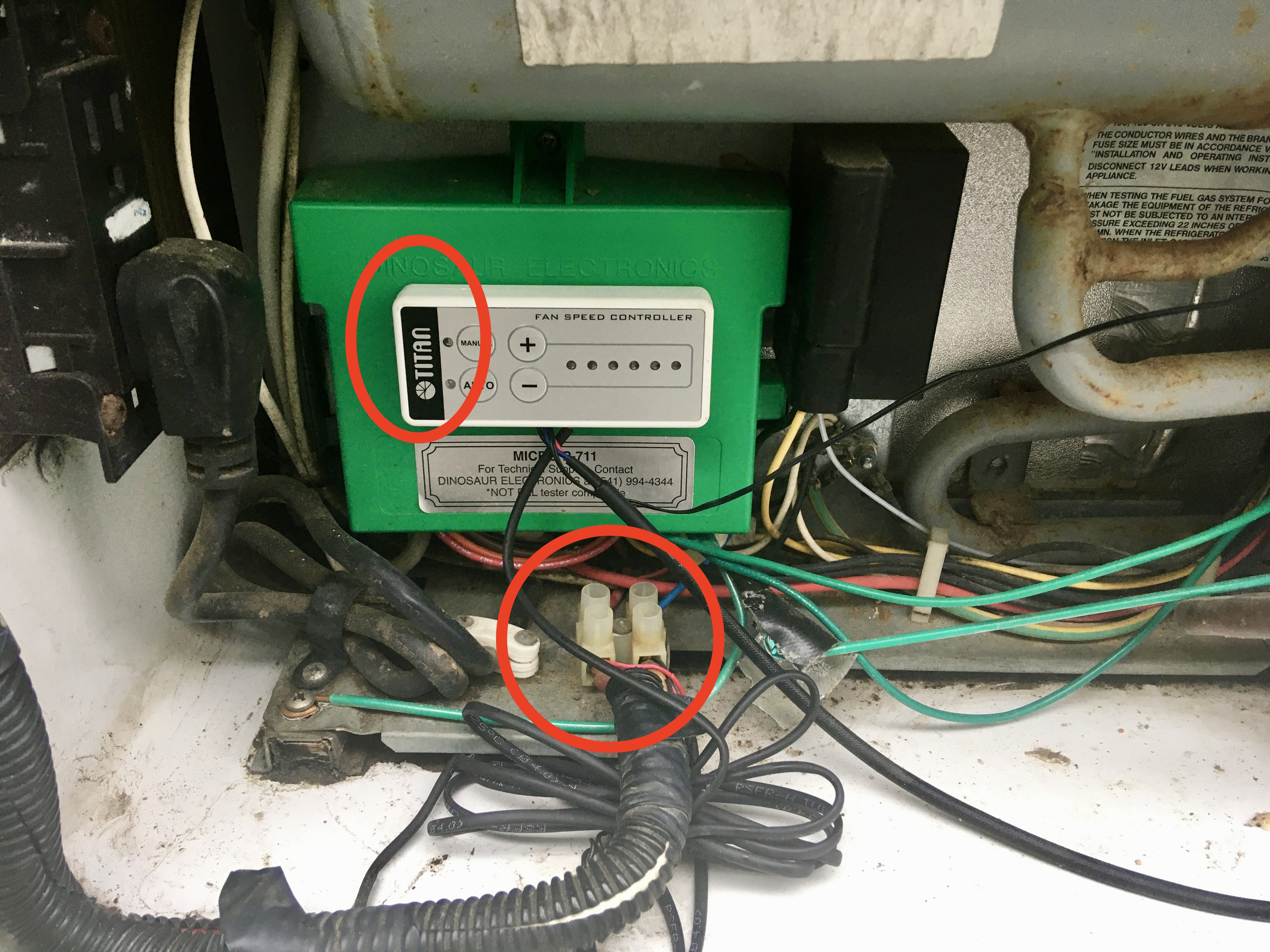

To hook controller up, I used the double sided tape and stuck controller to green electronics box cover behind refrig vent on side of rig behind refrigerator. To run the electrical power and thermostat to the top of roof I cut a small hole in mesh vent and ran a straightened coat hanger down, then I taped cords to coat hanger, went on top and lifter coat hanger and cords to top and connected to fan. For the thermostat cord, I simply came up through top then put down thru mesh so it hung just above cooling fins, 6" or so, and zipped inplace.
The 12v electrical was last and the connection is shown in below pic, it is under electronics cover:
