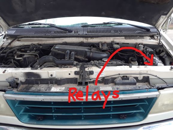

OK. By now you're eager to hear about my tryst with Serendipity. I saw months ago a reference to a little bank of relays related to the trailer package but hadn't really put two and two together yet. Last night, I was exercising my curiosity and located the bank of relays under the hood behind the driver's headlight but inside the engine compartment. Ho hum. Yes, there are three relays. I guess I'm what is called "handsy" so I ran my fingers underneath the relays to see where the wires ran. THERE WERE NO WIRES CONNECTED TO THE RELAYS! I fished around for a couple of minutes and found two big lonely plugs that needed relays. Woo hoo! Running lights and reverse lights all work now.
General Location of Relays
It was a good night. I still have the mystery of a third relay with no plug but I'll figure it out some day. For now, victory is mine and I'm going to gloat. Thank you all for the help in this forum.

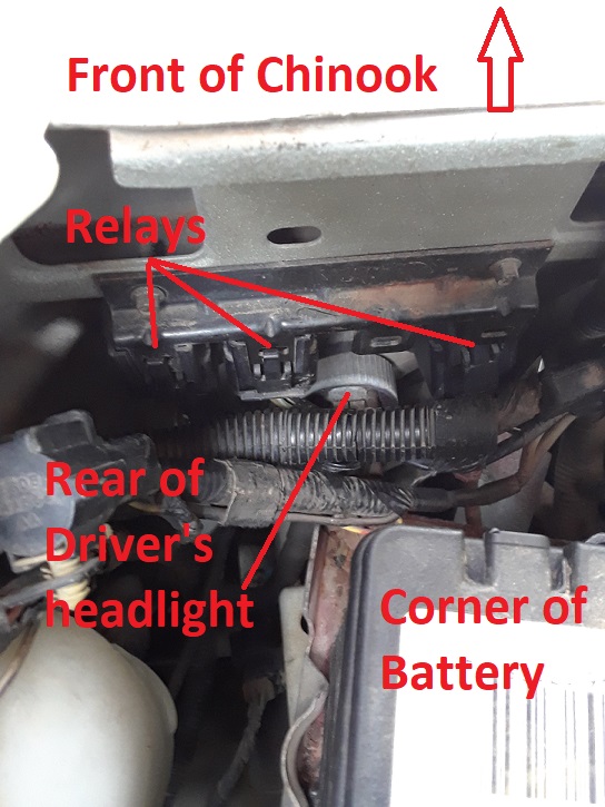

Standing beside the driver's front fender looking to the front of the engine compartment you can see the relays.
