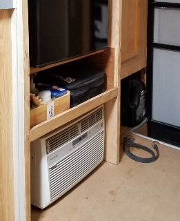

I hastilly removed the generator almost as quickly as I removed the jack knife sofa and rooftop air. In my 1994, the generator compartment is gel coated fiberglass. There were several holes so I covered the whole floor with a piece of plywood, painted the inside, and sprayed undercoating underneith. (search rockrover + generator. I think I posted a pic).
I purchased a 6k Frigidaire air con unit from that store with the orange buckets. It has a remote cotrol, which has been usefull for turning the blasted thing off in the middle of the night when I start shivering. The condensate collects in a reservoir just below the condenser core. The hot-side fan blades pick up the water and spit it onto the core, disipating the condensate while maximizing evaorative cooling. I had a drain line going for a while, but it wasn't worth the work. There's more to that story, but that's the idea.
The venting on the hot side was adequate but I wanted more, so I wired in a short extension cord that swtches hot when the compressor activates. That's connected to an 8 inch box fan which works in tandem with the factory fan. Not required, but certainly an improvement. I open the hatch when it's running. The AC unit had to be fully disassembled and a bunch of other things that required waiving the warranty, such as tampering with the wiring and drilling a few holes in various places.
Removing the unit takes three minutes with a screw driver. I saved the removed panel and can seal it off with vairous fittings. I would use 1/4 turn dzus, but I don't remove the AC because I don't need the storage. The tail end is supported with a block screwed in place.
The AC unit came with a comically huge GFCI plug (i.e. it wouldn't plug into my exterior outlet which is already fault protected). I wired a new cord, which plugs into my Honda 2000 generator directly, or into the rig's 110v.
It works very well. Better than the ancient Coleman that was on my roof. Way better. But the project was quite involved. If one can remove their generator with fair competance, then the rest is up to personal tolerance for experimentation (and failure).
Installing a window unit on a stilt in a cab window is probably the easiest way to go for ocasional use. But you have to set up and break down, you're cooling off a very hot cab, and I don't want to attract any more attention than necessary.
For the way we camp, there is a long list of advantages with this setup. It might sound minor but removing the roof unit gained 10 inches of vertical clearance which has been helpful more than a few times. And the skylight is just swell.

Edited to add a pic while hiding from rain.
