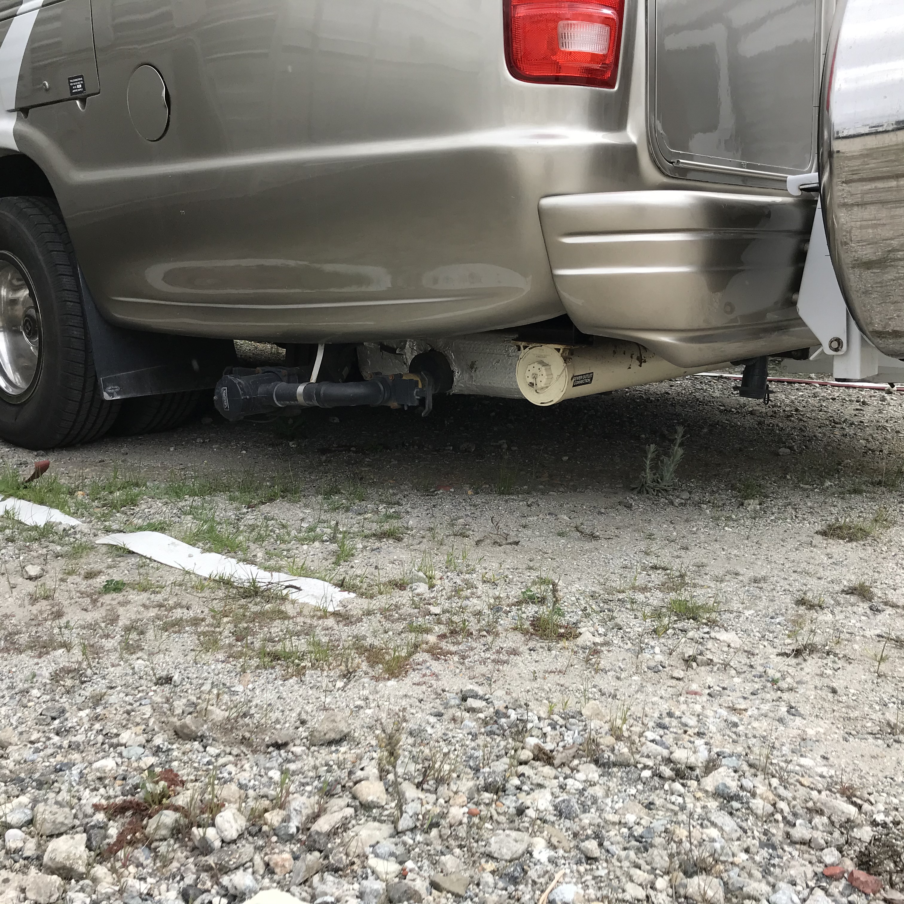

This is my first post. Been observing and reading from the sidelines. Got my long lusted after 2003 chinook concourse about a year ago.
Pondering how to lift the rear end just an inch or two. My unit appears to be all stock with original shocks, MORryde rubber leaf, and standard Michelin 22/75R16 tires. Only 13K miles.
As you all know the rear kwikee steps and black / grey water drains are the low point in the system. I know how to approach a steep driveway or dip in the road to minimize the rear end dragging ...But it just seems a matter of time before a tear off the low hanging dump valve.
Is it possible my 17 year old rig even though low miles is sagging a bit low due to age of the MORryde rubbers? Shocks ? leaf springs ?
I have read the posts about lifting the whole chinook. All new leaf springs, fox shocks, lift blocks, weldtech Baja grocery getter lift etc.. etc.
I am just looking to raise that rear end one to two inches. Seems like a reasonable solution to do a 1 inch or 2 inch lift block. Quick and inexpensive. But after reading the different posts it seems it is never that simple.
I know many of you have gone down this road ..... what would you recommend ?
Thanks for your comments in advance.

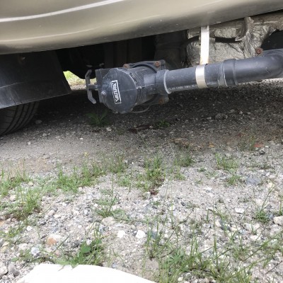

IF you have the opportunity...in order to compare rig ride height ...would you be willing to pull a measurement from the flat bottom side of the T handle dump valve housing.? Or any other reference point?
That way I can compare my rear end ride height to yours... my rig is at a rv storage yard to I need to go down and pull that measurement ....but I do think that would be interesting as a comparison.
I am configured with a fully stock rig with stock 215/75r16 Michelin tires. I will get a measurement sometime early this week.
Thanks again for your input.
Ps Chin-K I am in Rancho Palos verdes.... where are you in SoCal? I would love to look at your rig if in the area.
Thanks Doug

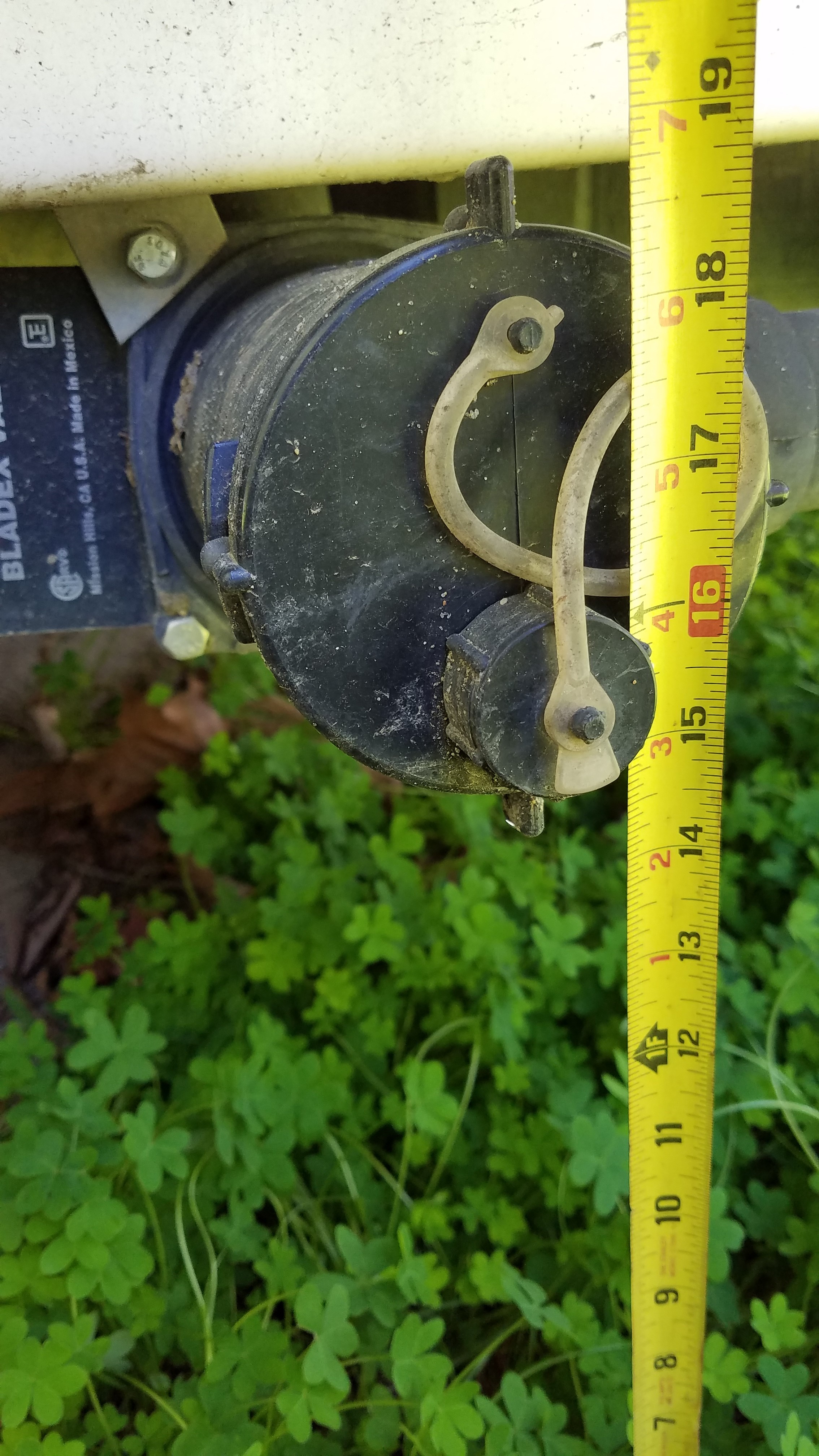

Hi Doug. Hope this photo helps.
Don't expect huge gains from the moryde adjustment. If you really want to gain height, new springs are the way to go.

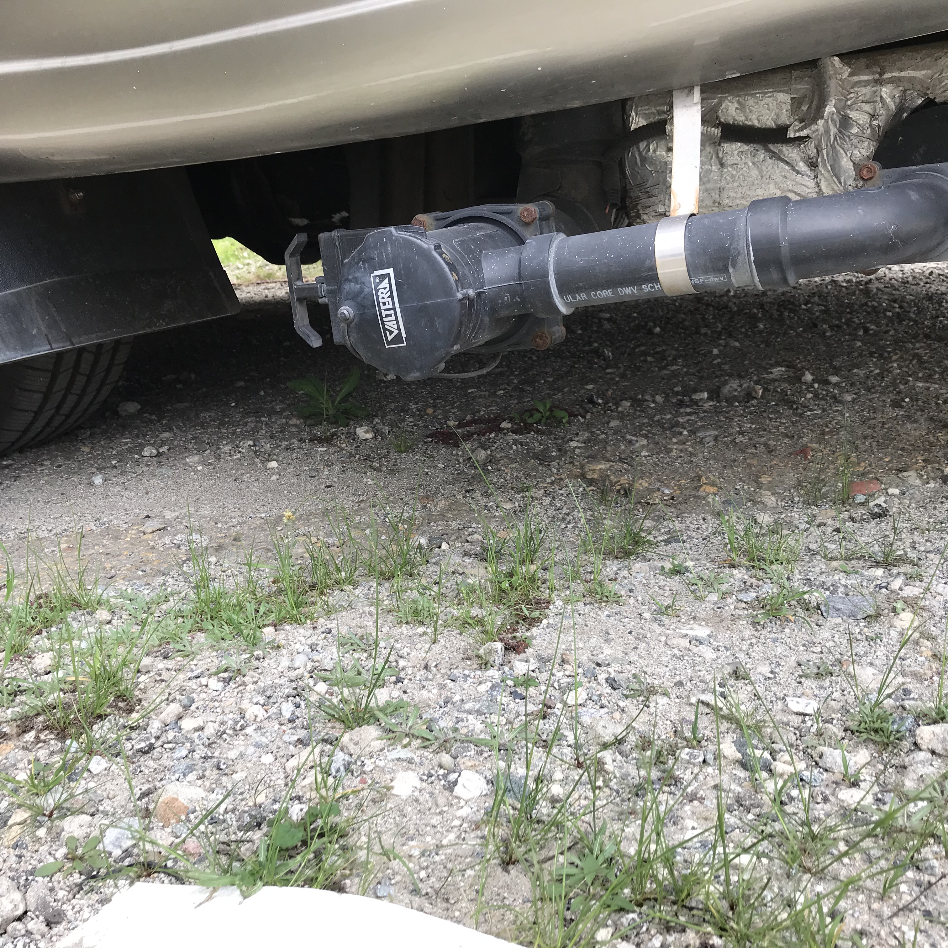

Re: How can a LIFT this Chinook rear end
Post by Doug777 »
Scott and manitou thanks for the input.
Scott I can see your drain valve low point is way higher.
Your photo shows about 14” at the low point.
I am closer to 10” plus or minus at the low point.
Imagine when I am fully loaded ! too low for my comfort and that is why I want to make some changes.
I would like to get those rear electric steps and tank drains another 2” higher.
I will take an exact measurement on level ground tomorrow and post my findings.
Scott are you stock or lifted a bit?
Thanks again for the valuable input.
Doug

BobW9
Posts: 270
Post by BobW9 »
Doug, did you notice that Scott's drain valve itself is positioned half an inch or less from the fiberglass above it? From your pictures it looks like yours hangs down 2 or 3 inches, so that is where some of the difference is.
Hi Doug. I should have mentioned that my rig is not stock. My apologies. The suspension and tire profile are stock, but that's about it. I've removed a lot of weight. Also, a 1994 Premier like mine (with zero options) is vastly different than a loaded '03 Concourse. Further, I don't have moryde, and I have the 9 leaf spring pack. There are a lot of differences going on here, so it's probably not useful for us to compare our relative ride heights. Plus what Bob said.
I constantly fret about knocking out the poo valve when I'm off-road, so I know where you're coming from.
In my reply, I was more focussed on the opinion that if you really want to boost your tail end, just get new springs. With the moryde, I can't say what that would entail. Blocks work for sure, but I think you're looking for more than a couple inches of lift? Lifting the rear is pretty straightforward. The front requires pro-level fabrication unless you just do the springs for an inch or two.
