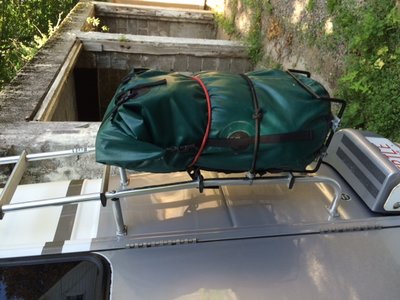

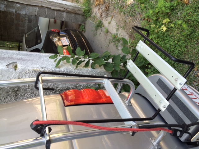

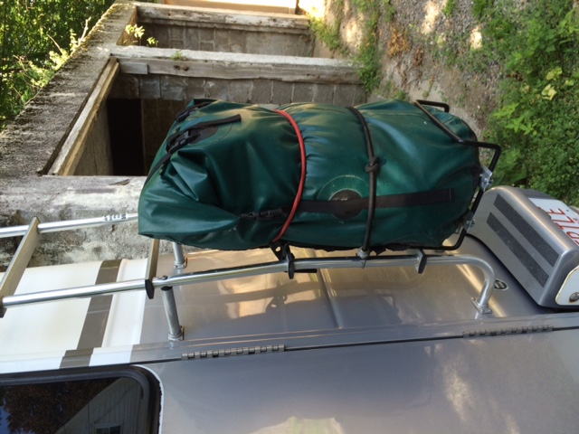

I finally came up with a simple, effective solution to the lack of outside storage that is protected from the elements. I fastened a couple pieces of metal threshold to one of those hanging racks for chairs and bikes that just clamps over the back ladder of our rig using some 3/8" double-screw connector clamps that I found in the electrical section of Home Depot. I shimmed the clamp screw lengths with a couple of washers and used a lock nut so as not to have a sharp end sticking into the bag; also filee the edges of the cut pieces of threshold smooth. I use an NRS Dry Bag that is attached with bungy cords, but container options are varied. I can double capacity by just adding another bag to sit on the first! Pictures attached.

Ooh, good idea! I've been waffling because I would like to put a solar panel in the logical spot for a "gear pod" near the rear of the roof. On the one hand, I didn't really want to "encourage myself" to climb up and down the ladder with stuff in my arms. Not that I'm not nimble but... just why. On the other hand, I was a little bit reluctant to take away my place for a pod.
This is great because it's storage I can reach from the ground, super handily. A better idea for me.

Yes, I agree...better for me too than shimmying my way up and down the ladder carrying stuff. And I have used these dry bags for years on serious whitewater canoe trips. They are certainly waterproof. The 2.2 cubic foot bag I have mounted in the pic fits nicely and carries a tent and sleeping pads (for company), as well as PFD's for canoe.

Agreed on the drybags. I've used them too kayaking and etc. and they are tough and work fantastically. One note if anyone else is going to get one: It's so easy to fall into the trap of thinking "holy cow, that size is HUGE; I'll get a smaller one" only to then find out that once you fold it down (you have to fold it down to fasten it in weatherproof mode) it's much smaller. Not that I've ever done that
