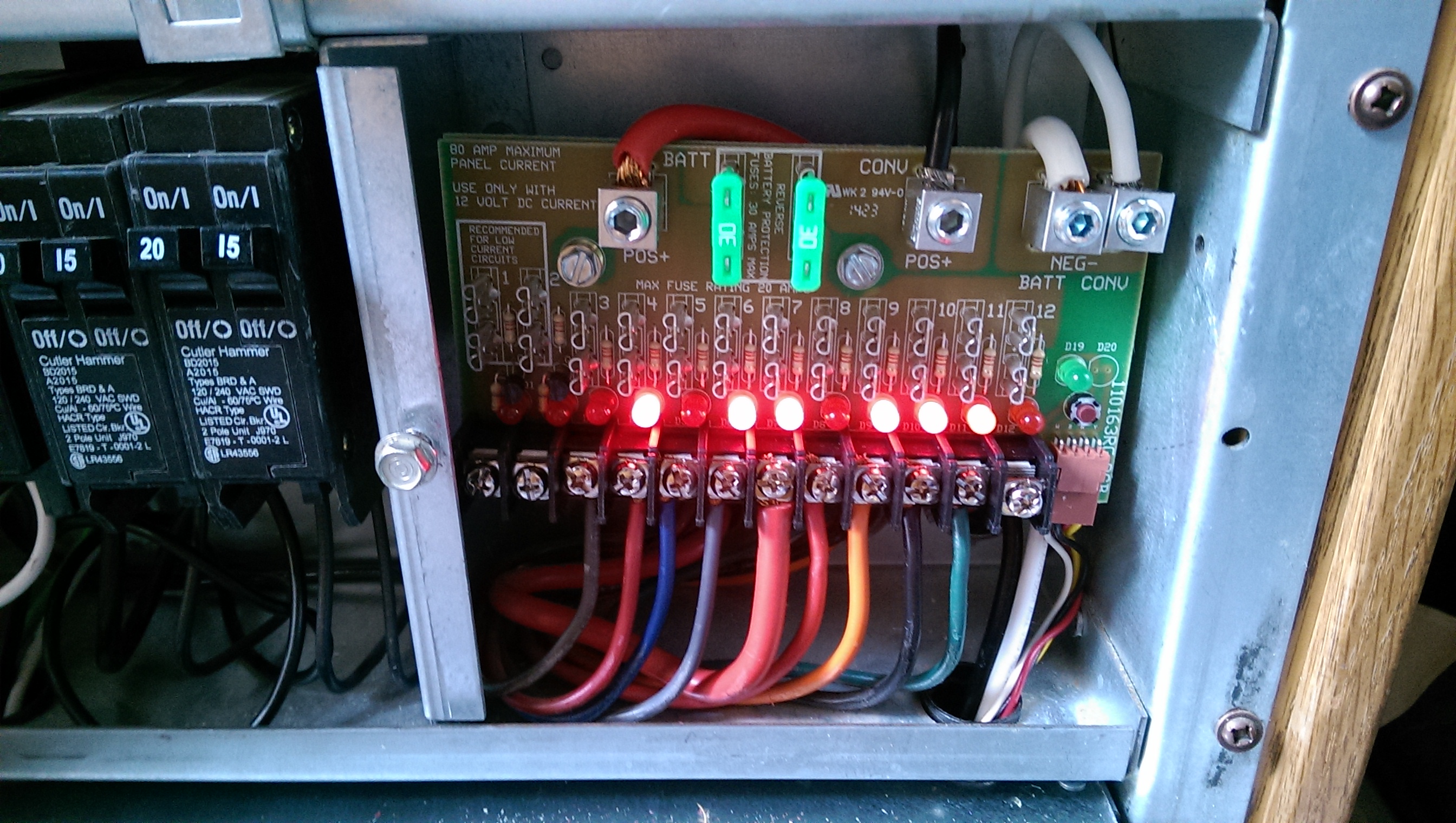

I described the procedure in my blog, with some pictures:ngpsaki wrote: August 31st, 2019, 11:31 pm How hard is it to replace the converter-charger? Any tips to make it easier? Any cautions I should know?
http://clayrushing.com/2017/01/21/chino ... -upgrades/
It was pretty straightforward, except I should have pulled a little more slack in the main DC power and ground wires before installing the DC distribution card to make it easier.

caconcourse, I studied the pictures on your blog and need a little clarification. On the Magnetek board, I see two white wires coming up from the bottom. On the "after" pic, I see three white wires, one from the bottom and two from the top. Where did the third wire come from?

There are only two white wires on the "after" pic. The wire you see on the bottom goes behind the back of the card and is the wire on the top right, on the connection labelled "CONV" (for Converter).ngpsaki wrote: September 1st, 2019, 3:46 pm caconcourse, I studied the pictures on your blog and need a little clarification. On the Magnetek board, I see two white wires coming up from the bottom. On the "after" pic, I see three white wires, one from the bottom and two from the top. Where did the third wire come from?
The black wire also comes up from beneath, behind and over the top of the card, to the connection labelled "POS+". In the 12V RV wiring, whites are usually grounds (-), and black is the hot wire (+), but often wires are modified, so you need to test and not assume. In the case of this conversion, it is simply a matter of moving wires from the + connection on the old board to the + connection on the new board, etc. Taking before pictures helps in case you forget.
The large red and white wires are the battery connections, and are the ones that needed an extra inch or two to reach the new connections that are on top of the new card instead of the bottom of the old card.
