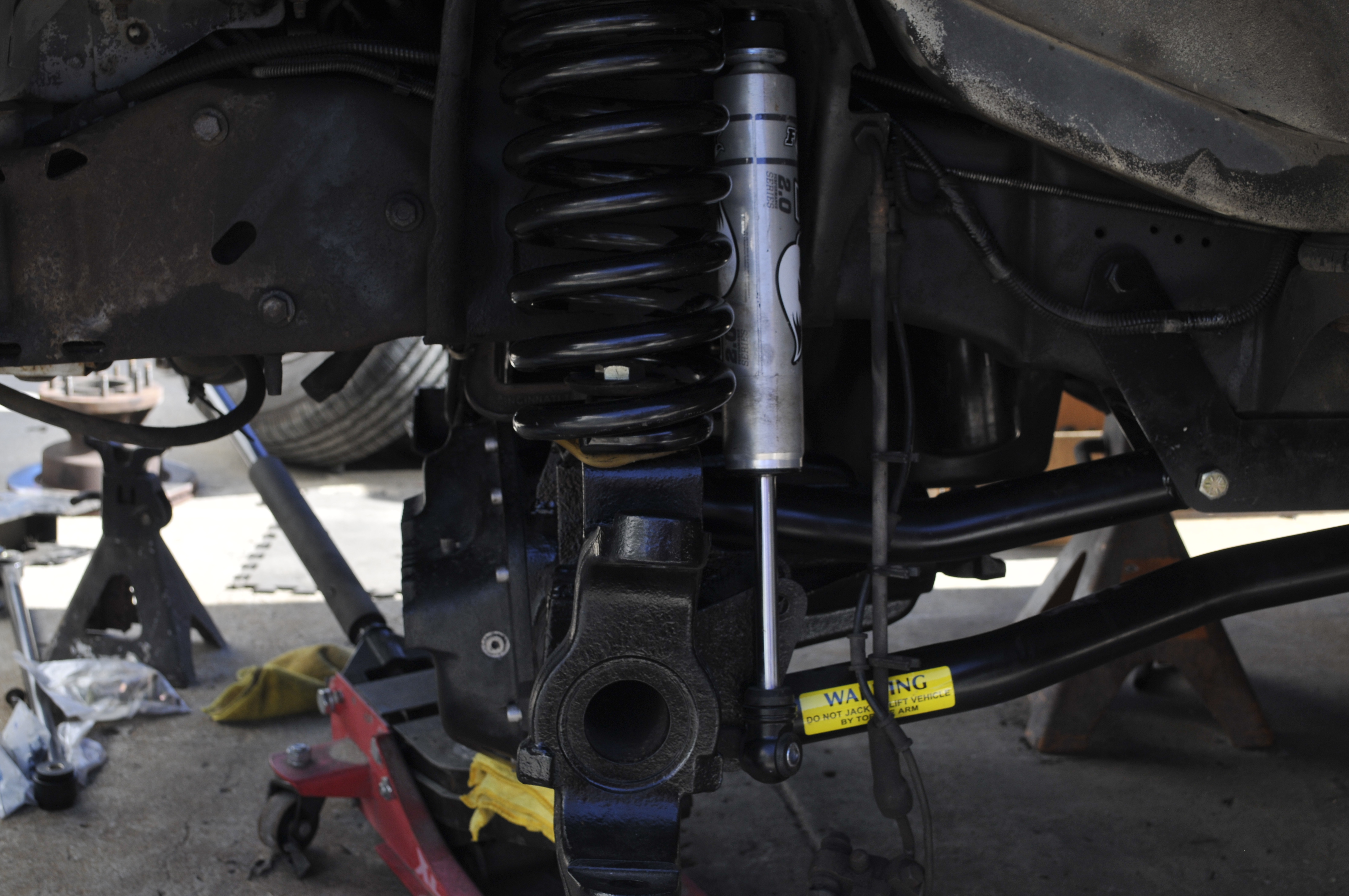

Just started the 4x4 conversion on my 2000 7.3 diesel concourse. I have a lot of work at the shop right now so this will probably progress slowly. So far the axle has been rebuilt(new 4.10 gears limit slip and inner axle seals). Also added a mag hytec cover. Axle is now hanging with coil springs, radius arm brackets and arms installed.

Nice! Looking forward to seeing the process.
edit: I know its only your first post so im going to hold the questions for now to see if you answer them later. But am interested to know about those radius arms and frame hugging brackets.

You can purchase those brackets and arms brand new from Quigley. Many Quigley parts are obsolete/discontinued but these are currently still available. Mark

markatherton wrote: July 2nd, 2019, 8:13 am You can purchase those brackets and arms brand new from Quigley. Many Quigley parts are obsolete/discontinued but these are currently still available. Mark
Oh that's slick! and it utilizes the factory spring tower and shock mount. That looks way cleaner than the SK leaf spring setup......

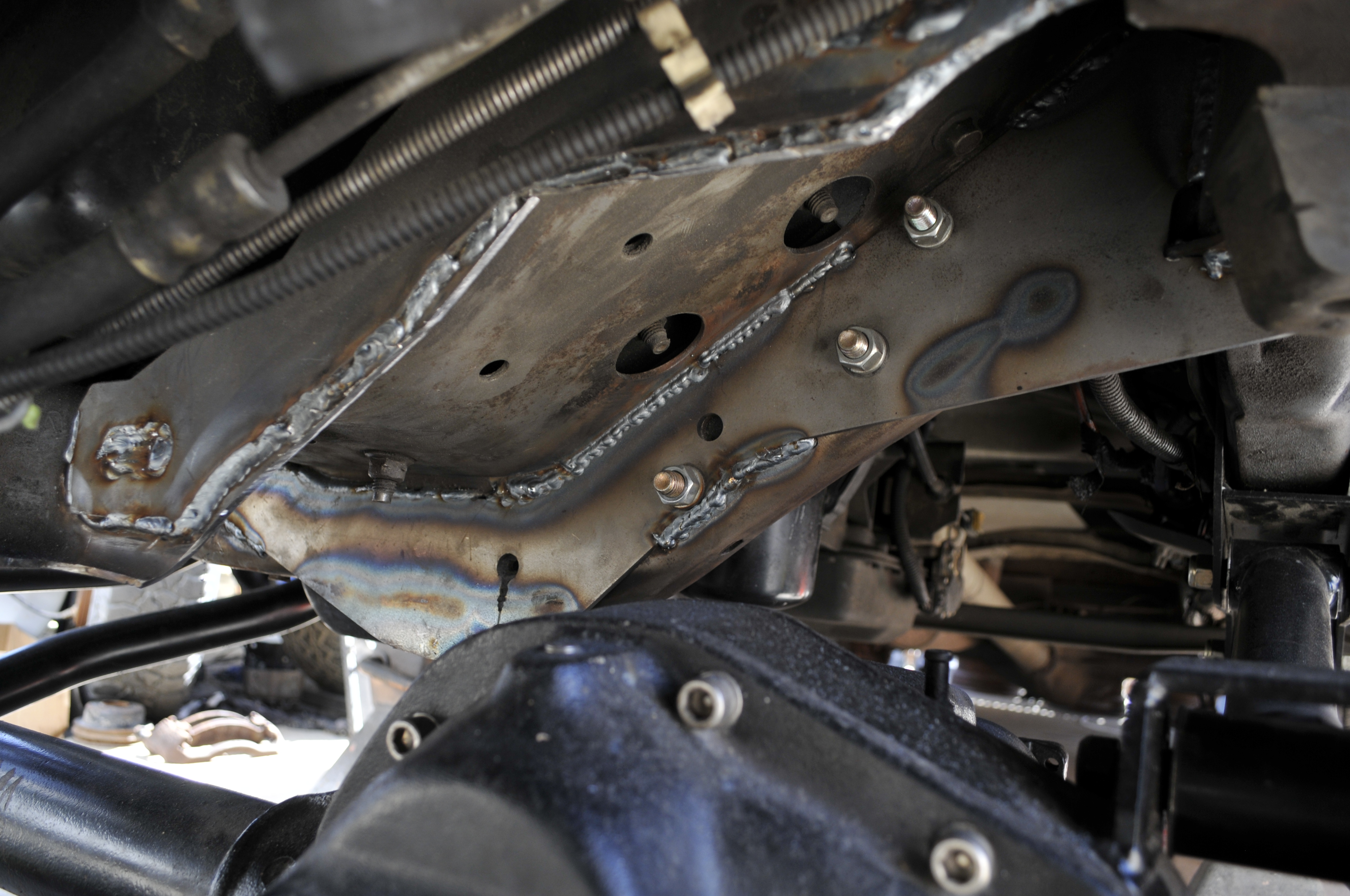

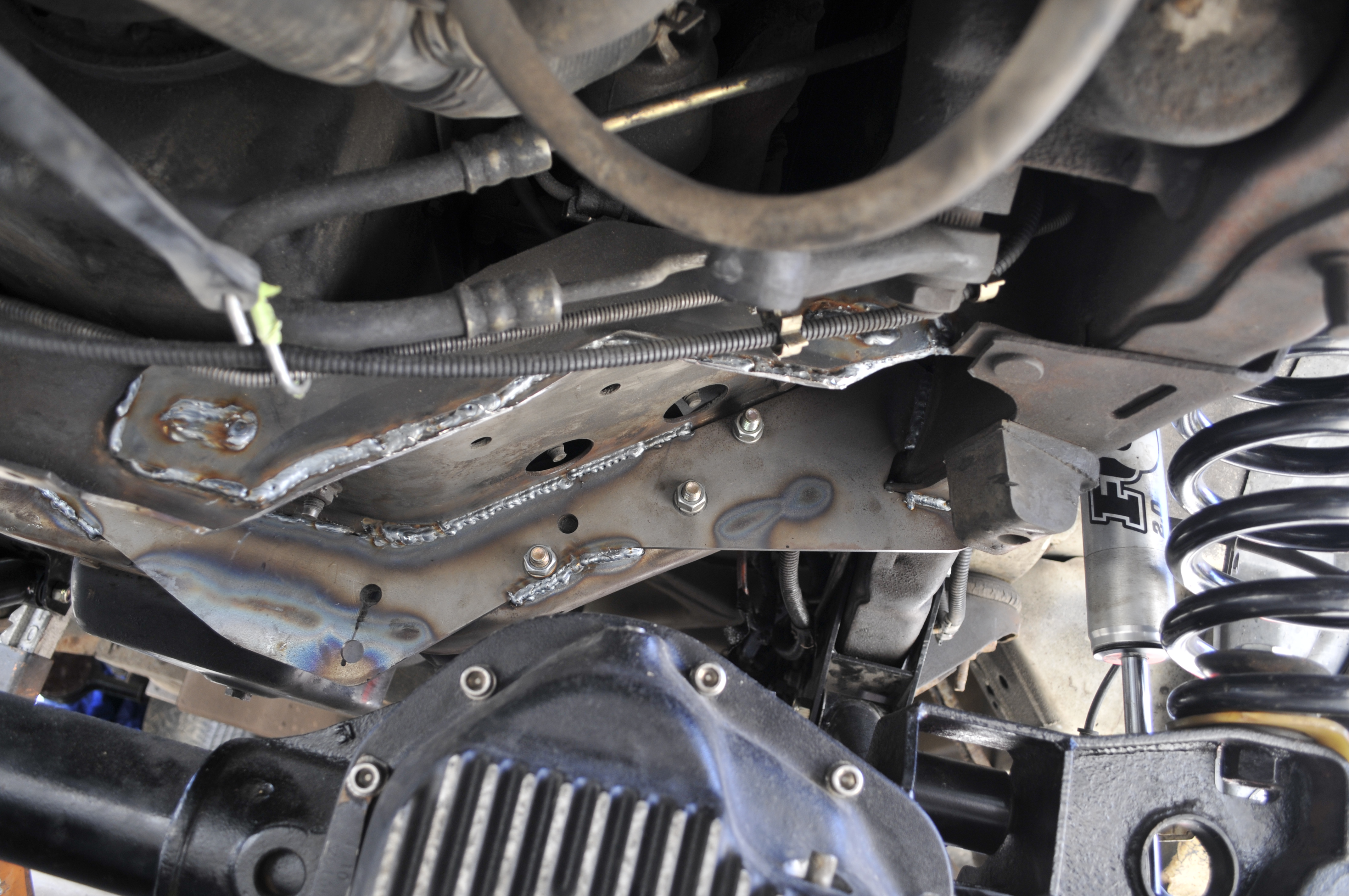

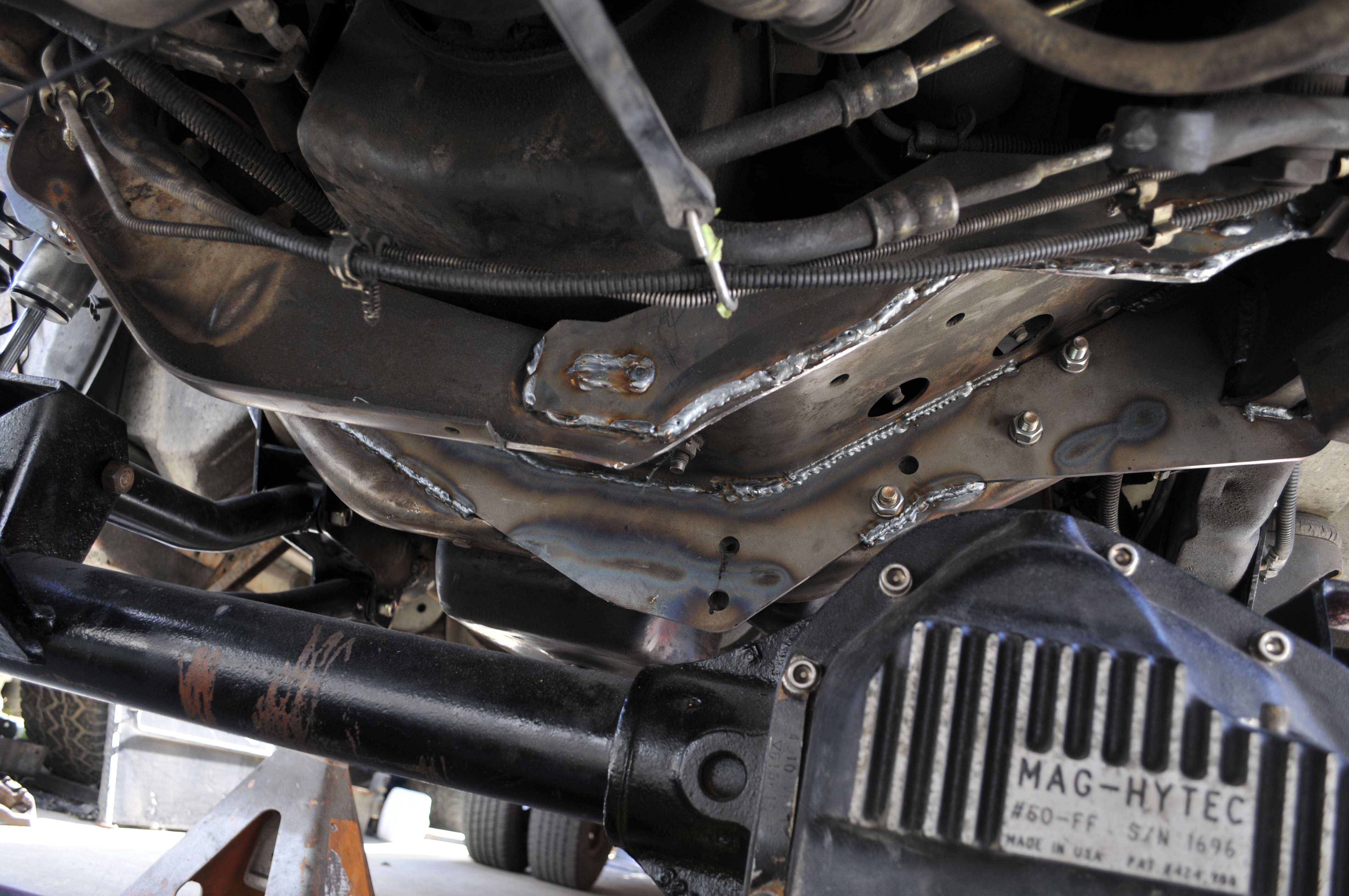

Went into he shop this morning and welded in the Quigley crossmember reinforcement braces. Then trimmed the crossmember for clearance for the dana 60 front axle.
