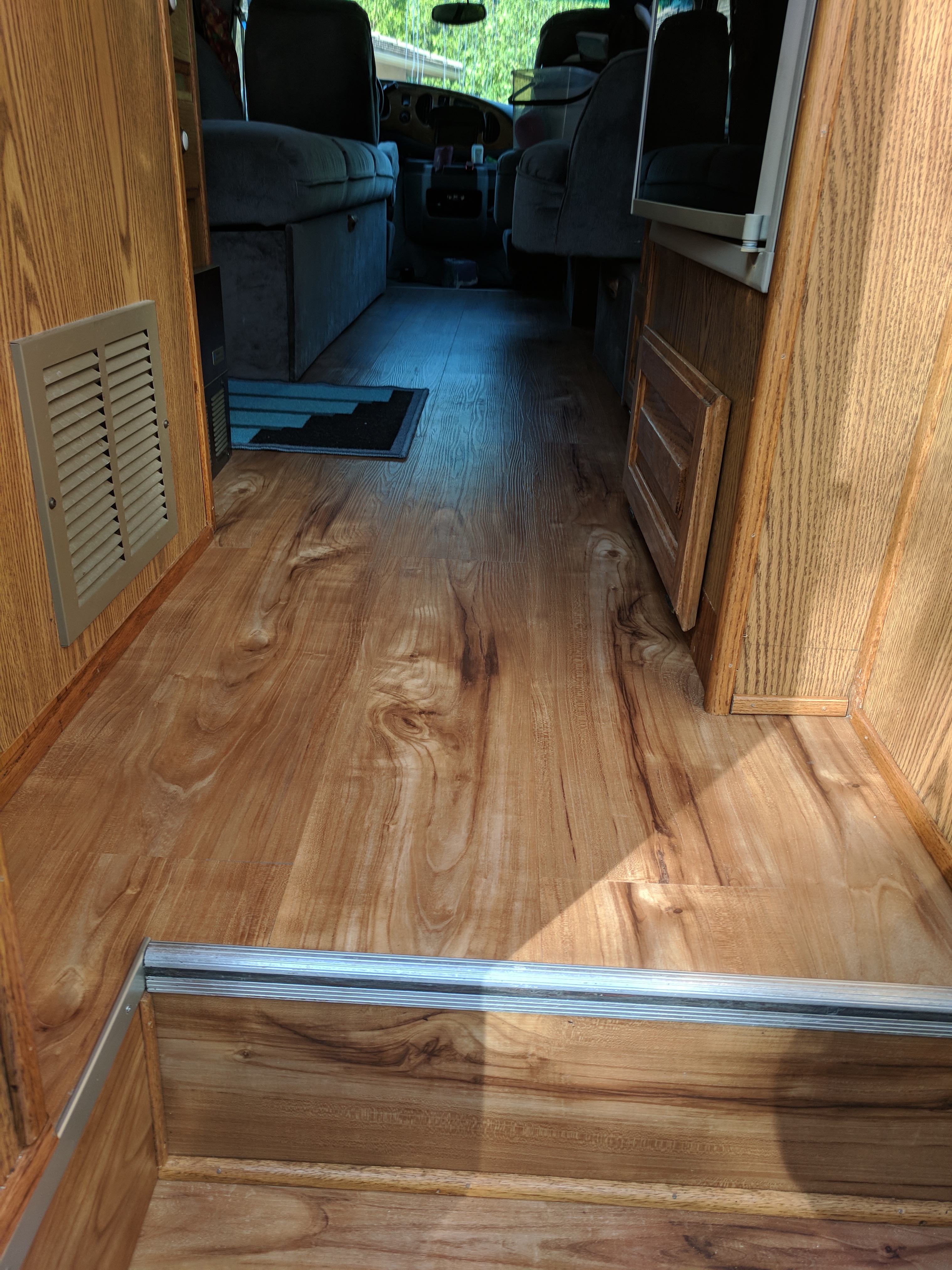

I saved the trim piece and lights when I replaced the carpet with vinyl planks, and I stripped the brown paint and left it bare aluminum because I used some aluminum trim around the step.

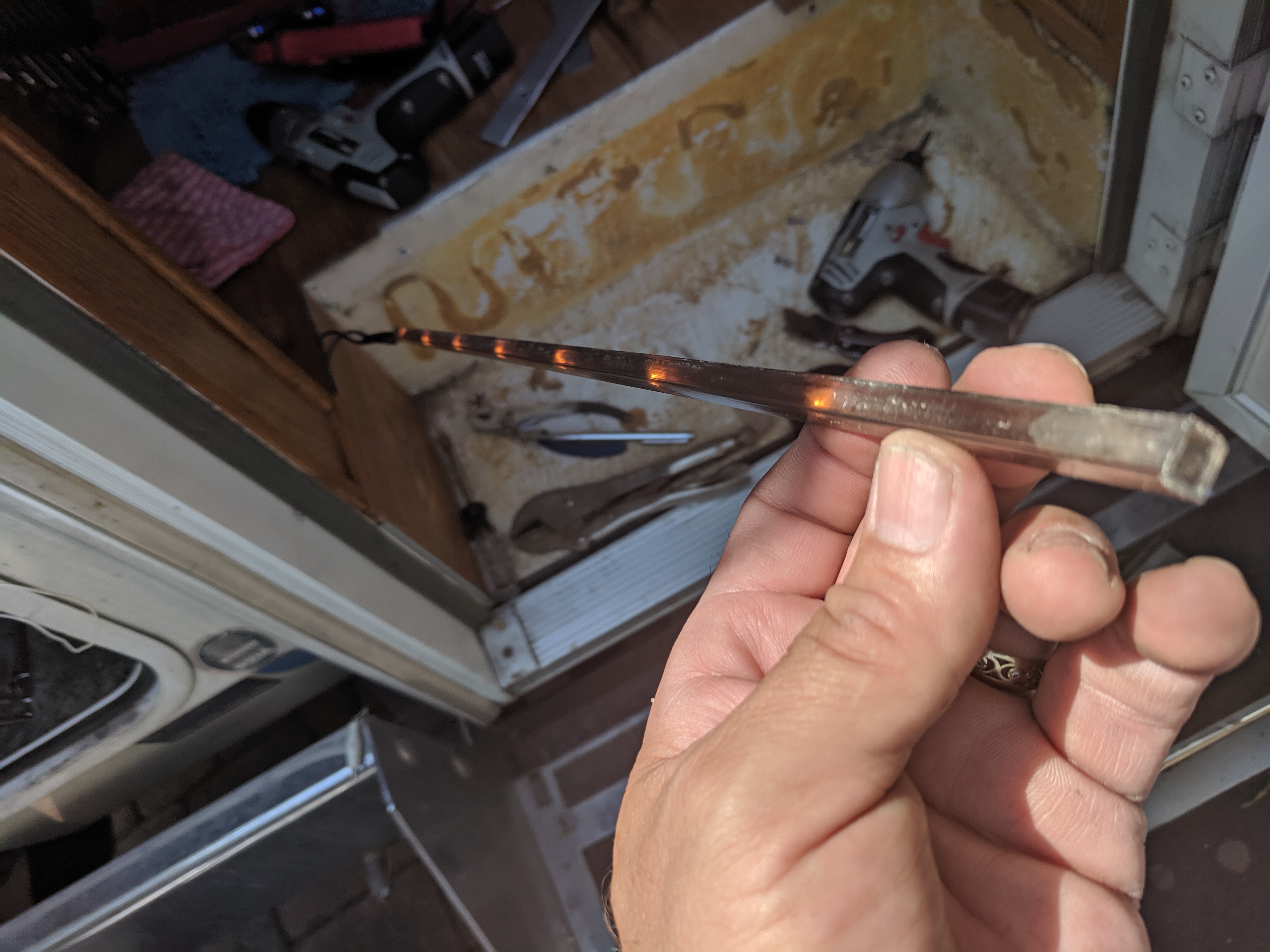

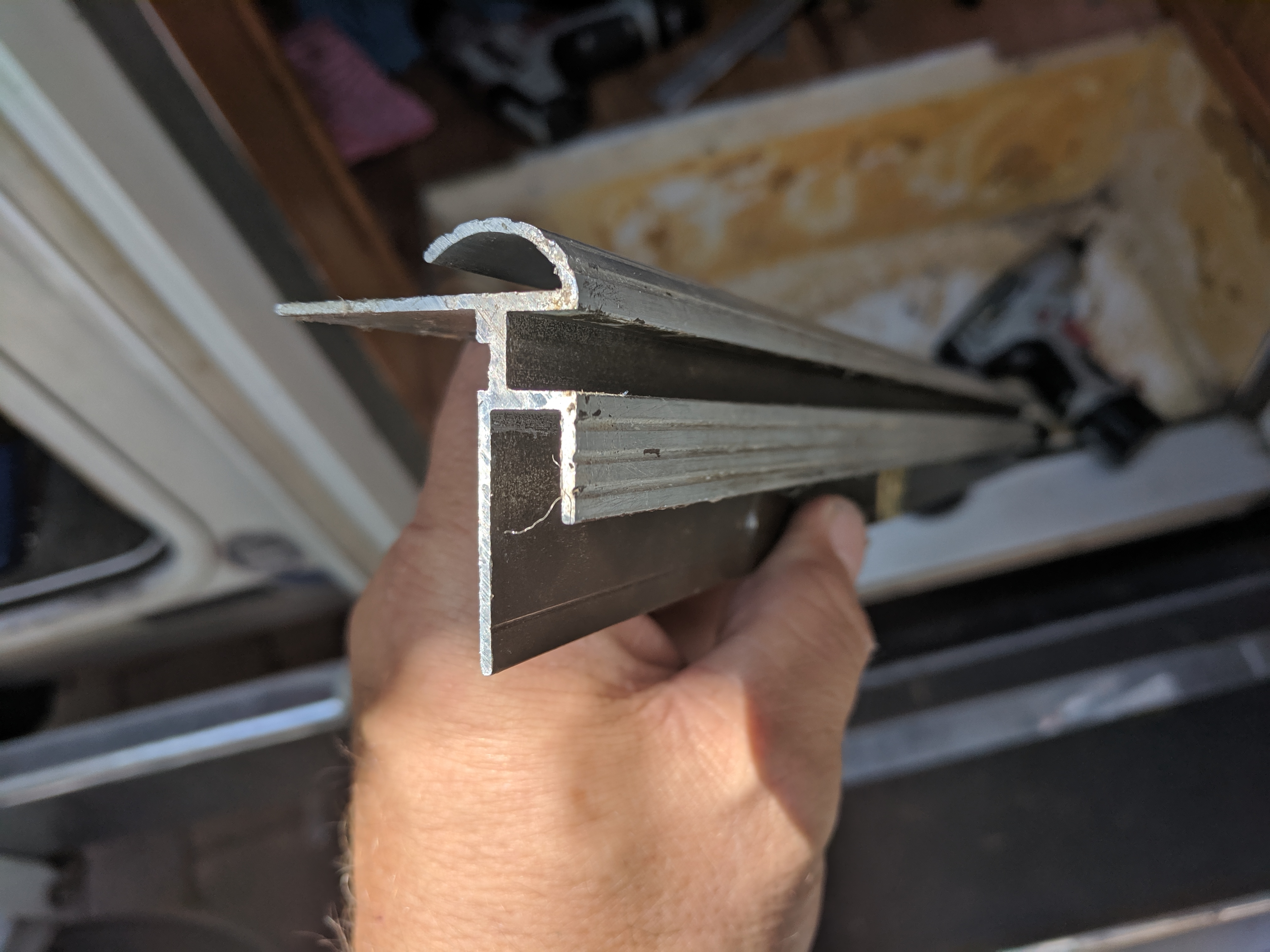

Here is more details about the step light strip. By a bad coincidence, my step lights shorted out sometime before our last trip, and I had to dismantle the step flooring to fix it. The light strip is in a (looks like 1/4") square channel. The lights are strung inside a square plastic tube with a seal on the right side which bonds the light strip to the plastic tube. You can pull the whole tube out from the right side if you get a hook inside the plastic tube and pry it out gently.
I am not sure what would be a better replacement, but a 1/4" light rope would probably fit in the channel, but would not be flush unless you put the new lights in a square plastic tube like the old ones. I really like the look of the original lights myself. I guess I like the golden light tones and the fact they are not over-bright. Not going to use much power for me, since we only use the porch light for short excursions outside the RV at night.
My short was cause by me, when I put the aluminum molding along side the left of the lights, I didn't cut enough clearance for the wires, and the aluminum edge sliced the wire insulation, and the two wires shorted together.
Here are some pics of the light tub removed from the channel, and an end view of the nose trim showing the square channel the lights slip into.
Also the nose trim had screws on the top (that I am not using under my vinyl floor), and I have two screws in the front holding it on. I am not sure if the front screws were original or if I drilled holes so I could mount it from the front instead of the top.

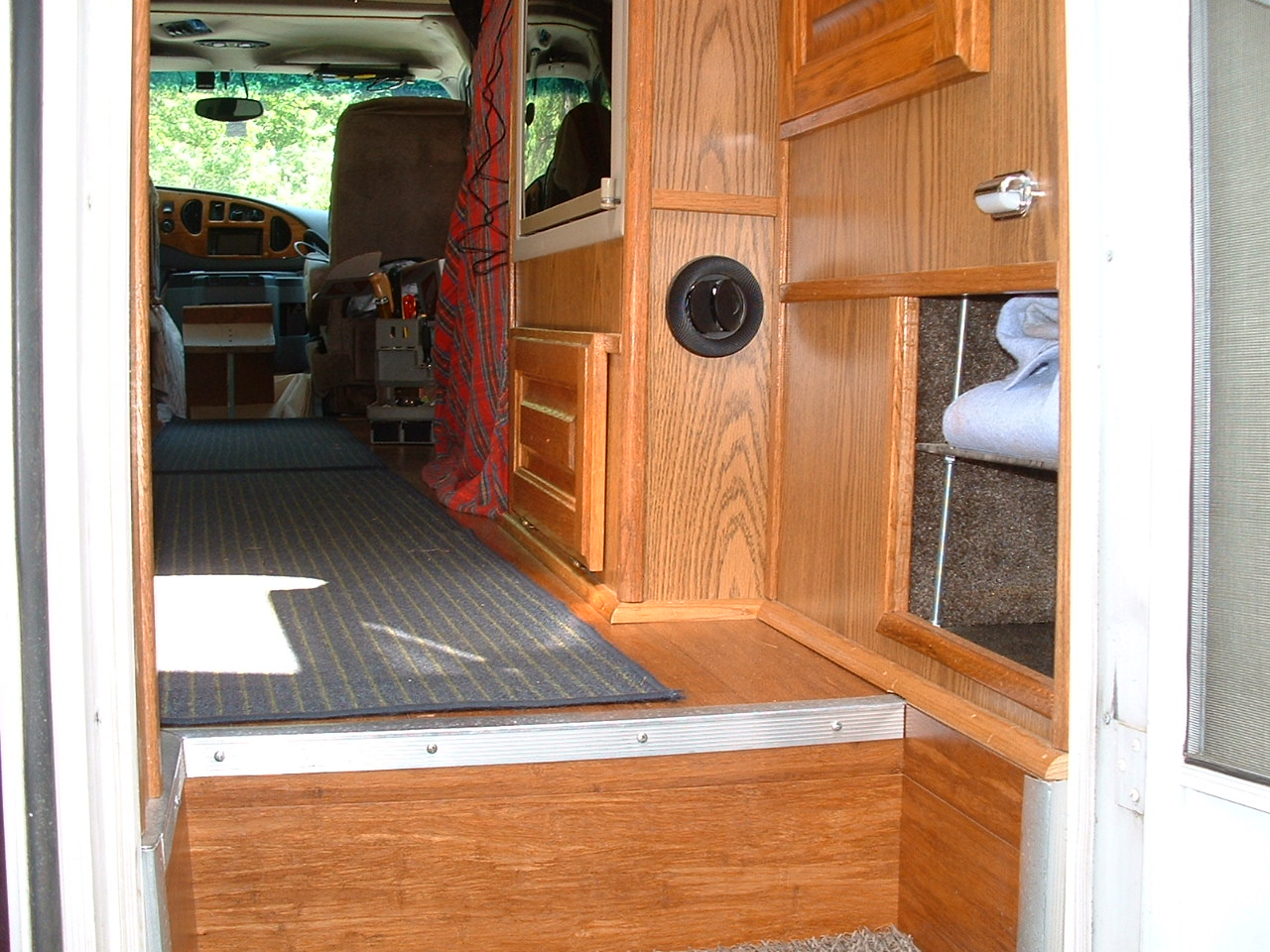

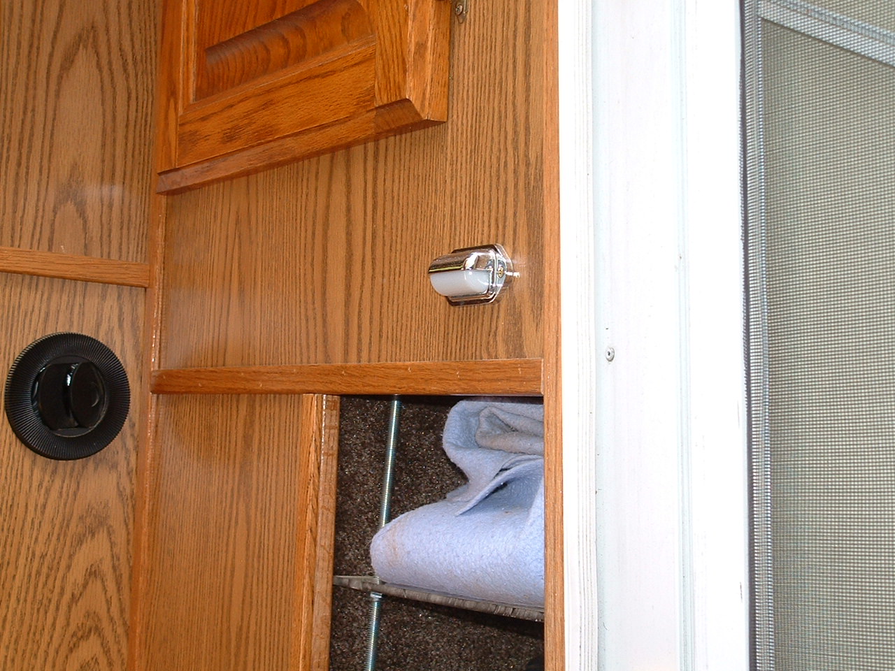

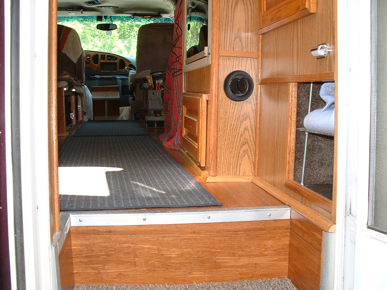

If you haven't already committed to placing LEDs in the step metal trim piece, here's an alternative. When we replaced the flooring in our 2000 Concourse, I rerouted the power supply for the old step lights over to the bottom of the closet. I installed an LED fixture from a marine supply store so that it illuminates the steps. The fixture I'm talking about is the small chrome unit just above the opening I cut into the closet wall to provide better access to the "trough" area inside the closet. Just something to consider.

I made an access opening there too. It's my shoe nook so I don't have to trip over them all the time

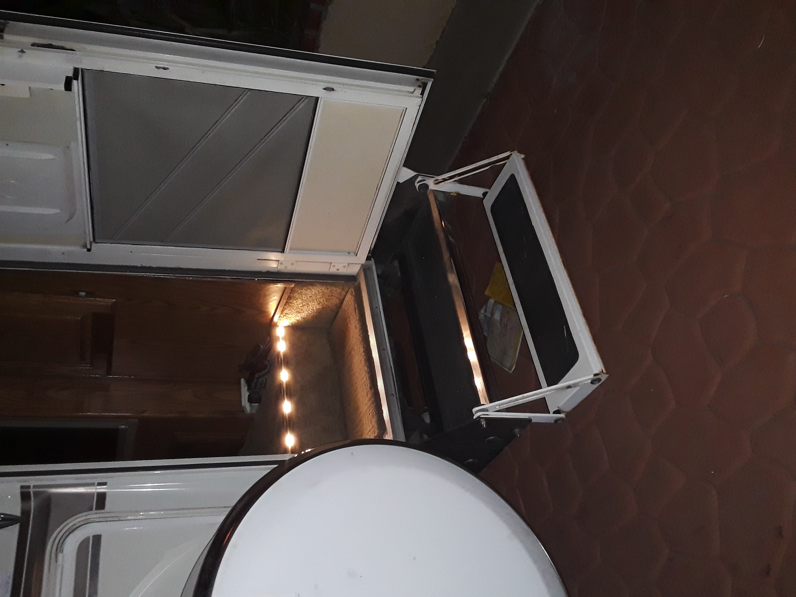

Re: The lighted step

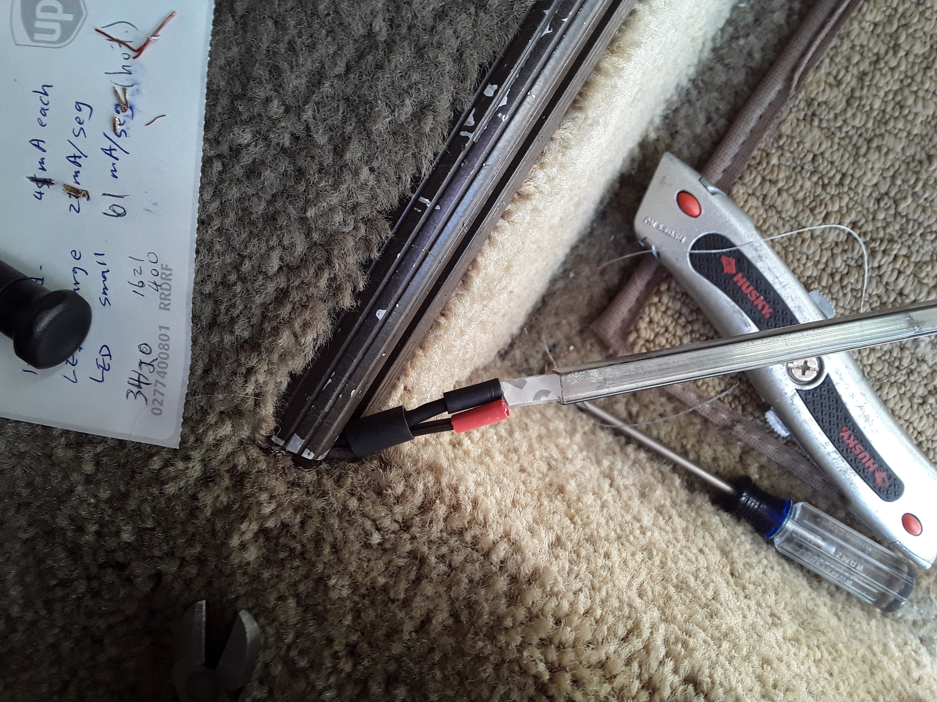

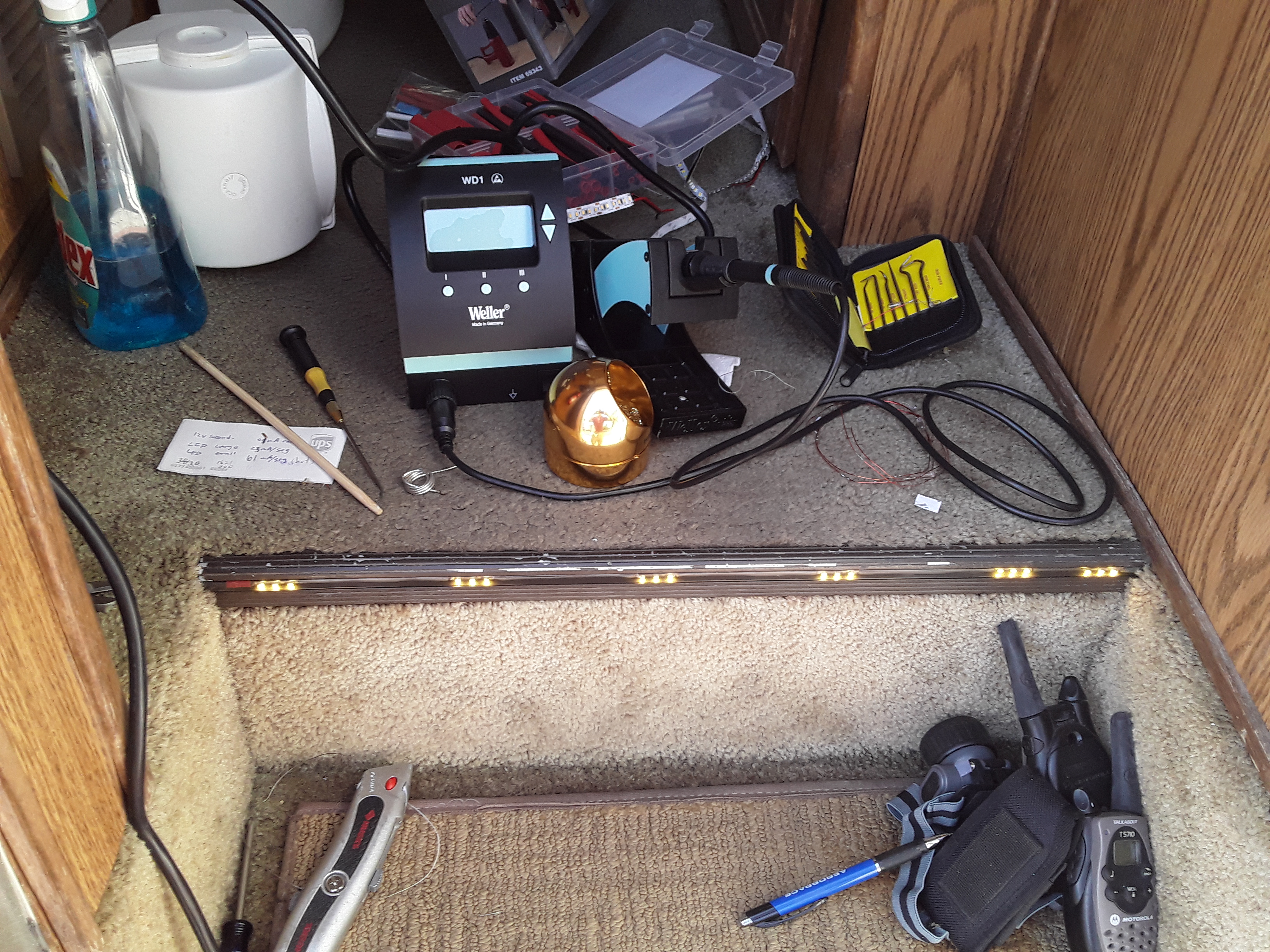

Here is what I end up doing. The result is kind of too bright (see attachment below), so I ended up getting rid of two of the lamps segments (not shown).
The bulbs are pointing 45 degree down onto the steps. If I ever do this again, I would do a little bit differently.
1, use smaller, dimmer LED
2, use narrower LED so that it is easier to slide into the square tubing.
3, use single LED instead of 3 per segment.
4, not use the red shrink tub so that it will not show up too well.
