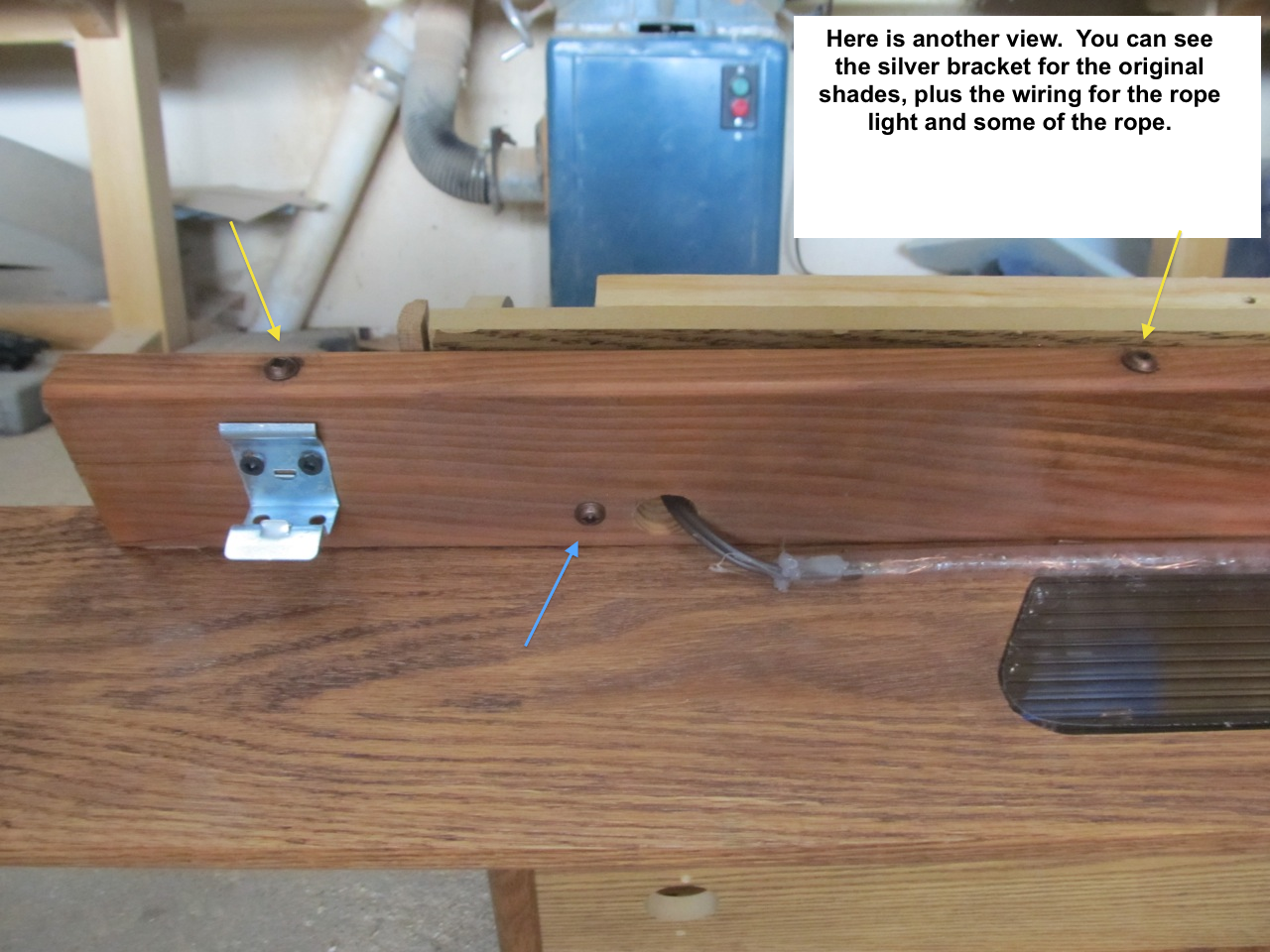

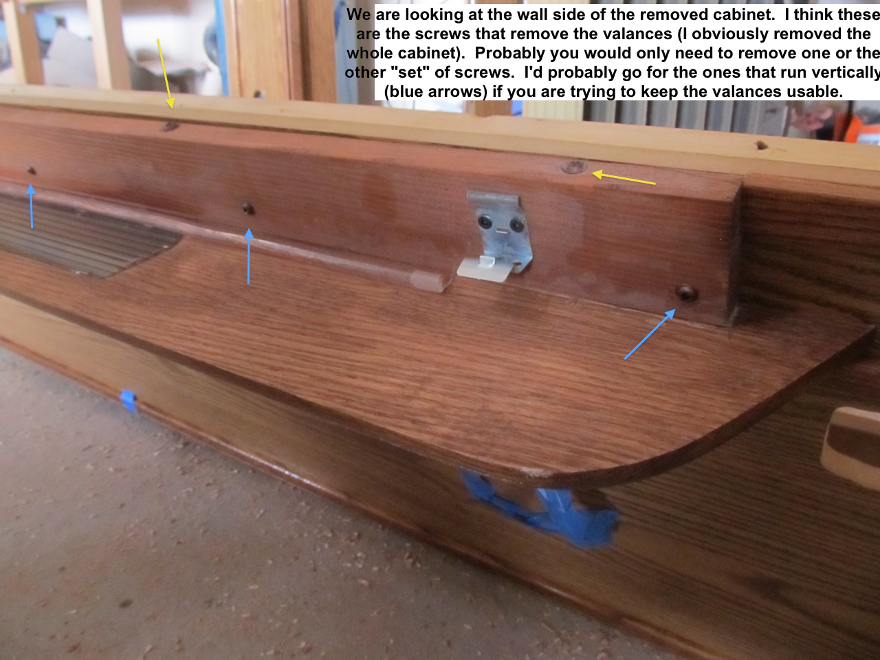

We want to remove the oak valances in our 2001 Concourse so we can do some cabinet modifications. Can anybody who's done this (Blue-Go?) provide any hints? When I shine a flashlight up behind the valance, I see screw heads running alongside the track for the day/night shades. Do these screws attach the valance to the underside of the cabinet?

BG here. Yes, I removed mine. Now I can't remember how (it was four years ago), but let me see if my photo files jog my memory.

Thanks, BG. Decided just to go for it and removed those screws. The valance dropped right off! Actually one of the easiest things we've done so far. :)

This is so frustrating! In this case I made a reply with some description along the lines of "OK now I remember why I don't remember specifically removing the valances, because I removed the whole cabinet" and the photos. I always Preview to make sure it works, plus refresh the thread after I submit. They appear just fine, then apparently the whole post disappears, not just the photos. It's happened a few times; one other one I remember specifically was posting photos of the new front end parts.
I will try again here in case this can help someone in future, but if I'm not posting photos anymore now you know why. Grrr.
Click once or twice to enlarge.

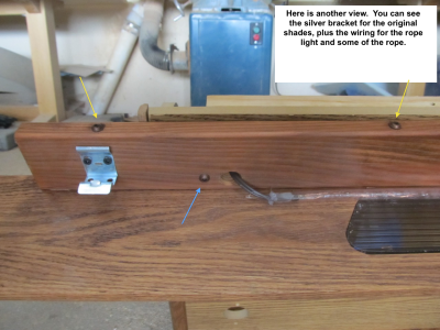

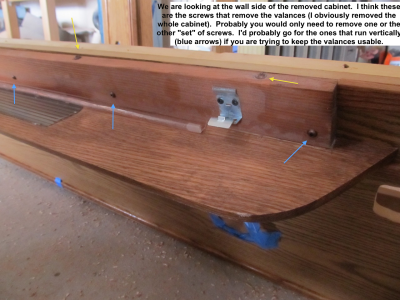

Sorry for the aggravation, BG. I always find your pictures and explanations to be extremely helpful, so thanks for persevering when posting them. Strange thing - I can see the pics and text when I read your post, but when I enlarge them, the text just appears as a black box!

When you say text is black box, do you mean the text that I put right on the image? If so, that's so weird, because I made it part of the image itself. When I click on it now it enlarges and so does the text, but then it's my image. But still.

Blue~Go wrote: May 29th, 2019, 8:01 amWhen you say text is black box, do you mean the text that I put right on the image? If so, that's so weird,
Yeah, the text on the image was redacted. I can illustrate with a screen shot but can't post it because broken. The "attachments" tab has no options anymore. (Using Windows 10) Oh well. ;)
