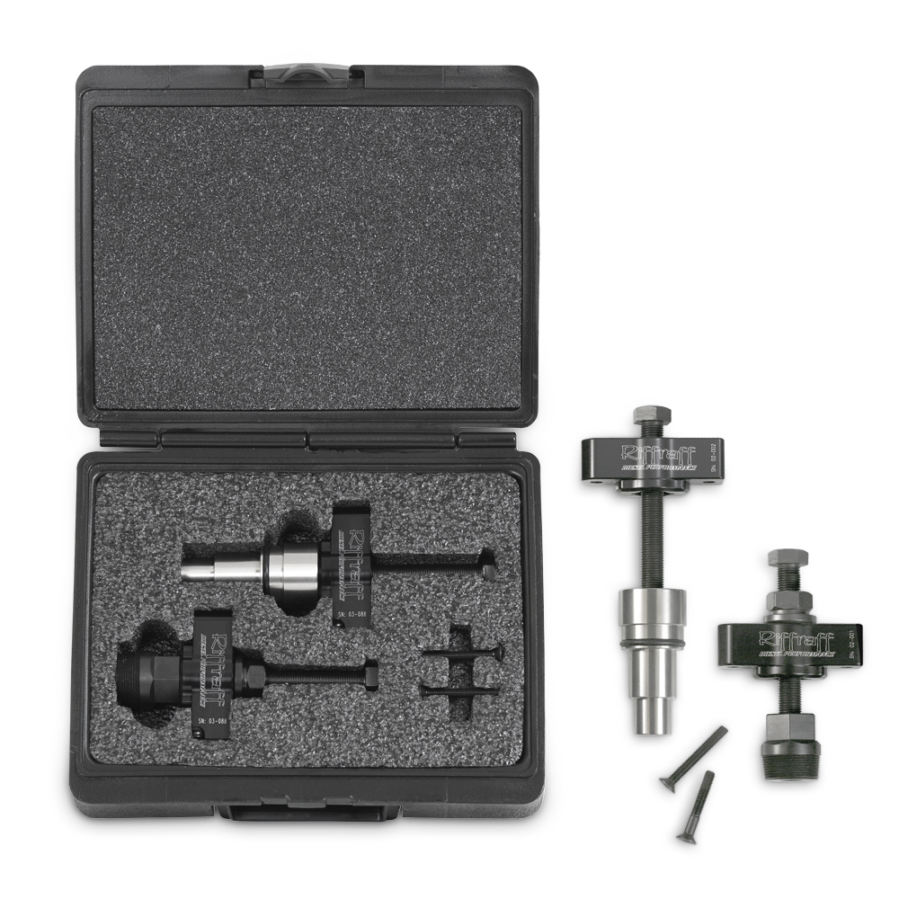

With the riffraff specialty tools the job is easily done with heads in place. The installer tool uses the injector hold down bolt holes and effectively screws the cup into the hole perfectly square.

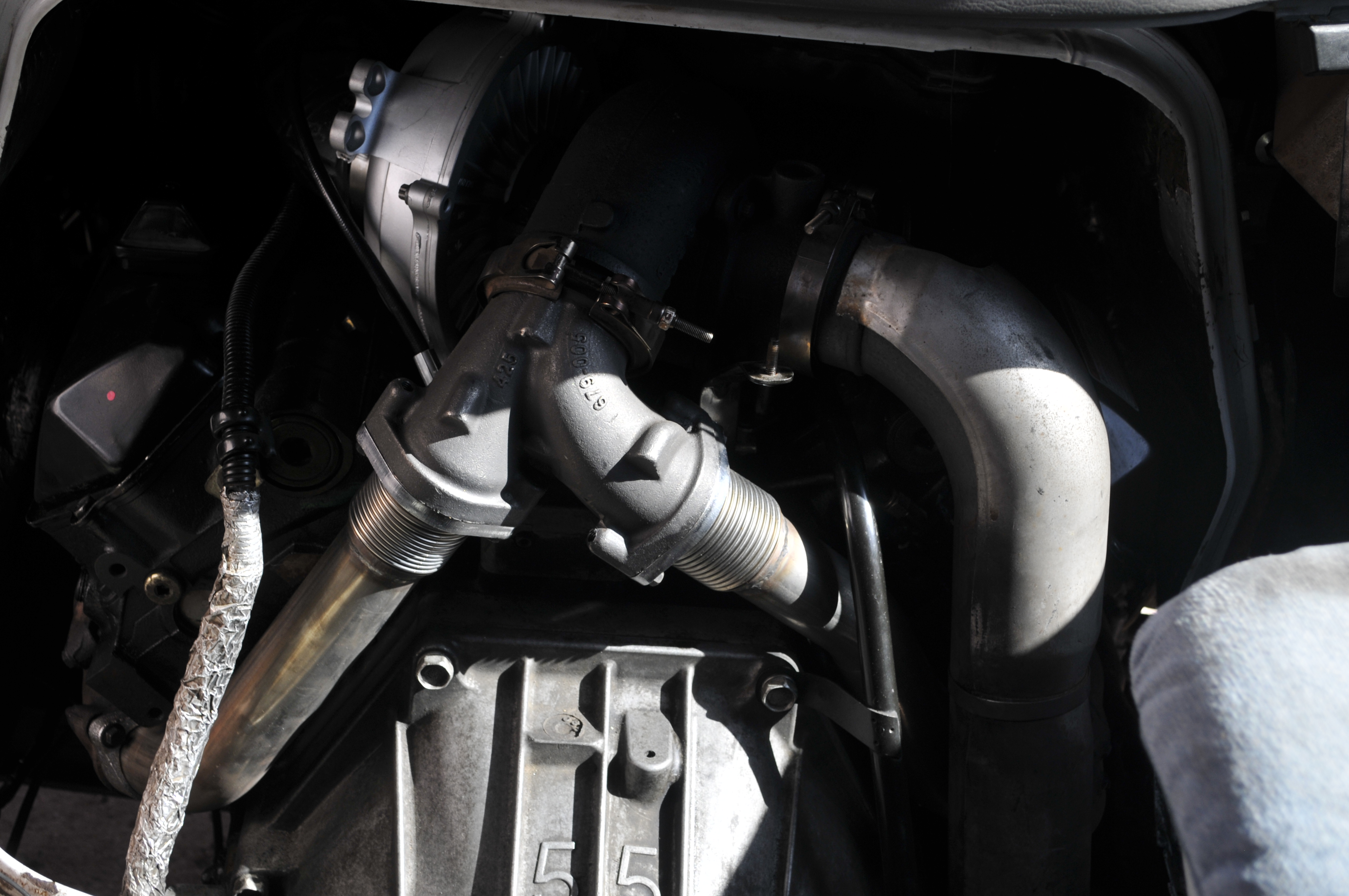

Almost everyone carries the up pipe set. You can get them at oreilly or just buy on ebay. I think I paid under $100

I Will have to lookup that tool and see how it looks. I cant believe there is a tool out there that can pull/install a cup in no.3 cylinder up against the a/c evap box while still installed. It must have been a tight fit at least??? The bellowed up-pipes were a topic of conversation awhile back. There seemed to be an opinion of aftermarket bellowed pipes vs international ones in the quality dept. I had been tempted by the low prices of the ebay ones but had heard some unfavorable reviews about them, Am curious to see how they treat you in the coming bit.

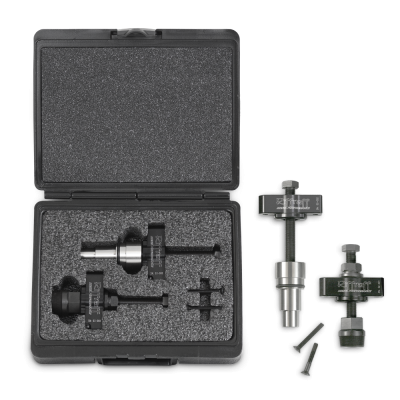

You have to remove the coil top from the injector to get it in and out on number 3; The cups are no problem at all;
sm350bl
Posts: 264
Re: freshening up the diesel
Post by sm350bl »
Good Morning Mark, Is this the tooling you used on your van?
Rich
markatherton
Posts: 266
Post by markatherton »
yes
