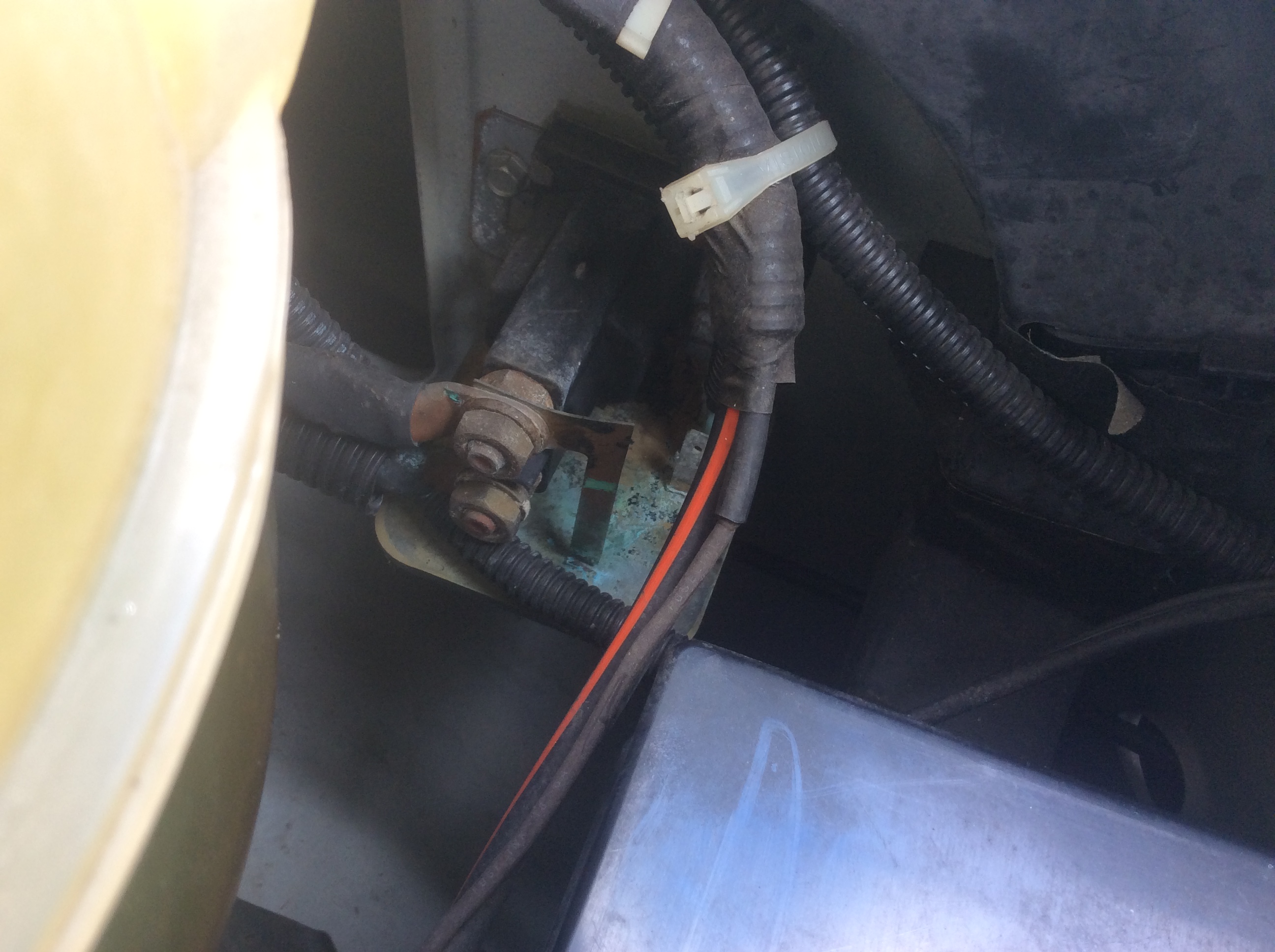

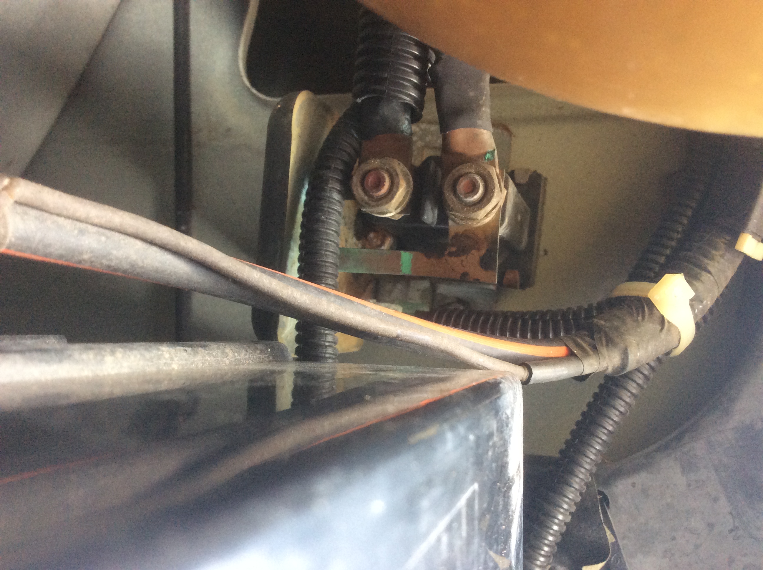

I think I’ve found the battery separator...and if it is, it looks pretty shot. To replace, should I go with the same surepower 3015a, or as many discussed a blue sea? I don’t want to get into new wires, etc., just drop in and go. Blue sea makes a si-acr and a ml-acr. What makes the most sense?
Photos attached of what I think is the separator.

The 7662 would be the typical choice. You need the high amp capacity for self jump starting.
There is no "easy" with that location though - geez that was tight. I couldn't wait to move it. You could consider moving it and just rearranging the wires on the original to effectively make it a power post. (You'd still have the original small-and-thus-unfusable wires, but at least you wouldn't be putting it back in such a poor location (heat, water, and inaccessible in general plus inaccessible lockout switch)
Electrically it can go anywhere on the wire between start and house banks.

I had to remove the plastic reservoir to get to the solenoid. Not to bad after it is out of the way. The tricky thing about relocating it is that you also need to consider the control wires for jumpstarting if you want the "battery boost" feature. I guess if you want to test it, use a battery charger on the chassis battery until it is fully charged, and see if the current spill over to the coach batteries. If nothing happened after the voltage is high enough, then the solenoid probably is bad. You should be able to hear it clicks when the solenoid is engaging/disengaging. If you bypass the solenoid by put a jumper across the solenoid (warning: large current and sparks! may melt the wire if not the right size.), you should see the coach battery should start charging. To avoid the fire show, I would disconnect the chassis battery at the neg terminal, and use a charger (lower current) to see if it can start charging the coach batteries via the by-passed solenoid.

The SI is fine but only rated to 120 amps, so not big enough for our Chinooks.100str8 wrote: April 10th, 2019, 4:35 pm Is there a need to add new wiring for the blue sea 7622 or can I use the original? Blue sea also makes a si-acr. Any good?
You can use the original wiring, but it is not large enough to support safe fusing which is why Chinook left it un-fused. Whether or not to accept that risk is up to you. The small wiring will also impart some additional voltage drop on your charging line.
I up-sized the wiring for the above reasons. I also abandoned the fenderwell location, so running the new wire was not difficult as there was a clear path.
