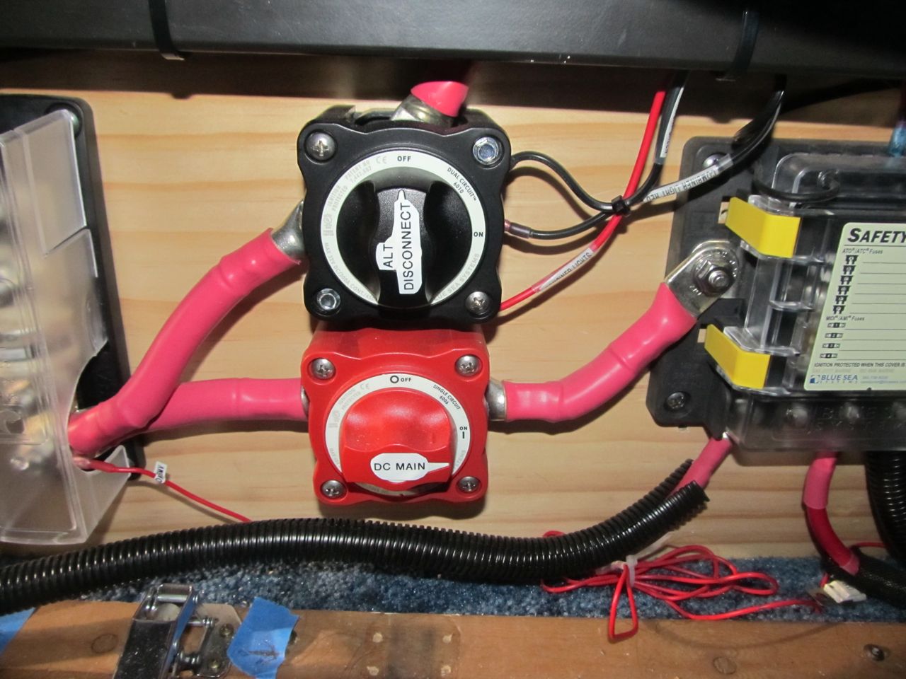

This is my "temporary" system I set up (temporary because I'll be tweaking the layout and also the battery box shape is going to change at some point). The red switch is the main battery cutoff, and the black one is the combiner line. The main positive lead from the house bank comes in stage left through the Class T fuse. The yellow and black thing to the right is the main fuses and distribution. Negative bus and battery monitor shunt are out of view to the right.

Pretty work Blue! What gauge are the large red wires you use?...dano
Re: Parasitic load loss fix
Thanks, Dano. I might make some changes now, but isn't that always the way when you look at something you did in the past? If I remember correctly, that's 1/0. The battery jumpers themselves (which you can't see) are 2/0, but I think I stepped down to 1/0 here for the slightly easier workability. I could do that because 1/0 still has the ampacity for the fuse sizes I needed to cover my potential loads (namely self jump starting as my combiner line runs through that main fuse and one of those legs).
It can be easier to stick with larger wire a bit longer rather than step down and have to re-fuse again. Eventually obviously that happens when you get to your load distribution bus and much smaller wires start to happen, but the later the better in terms of convenience and taking up space (not always but often and in this case).
