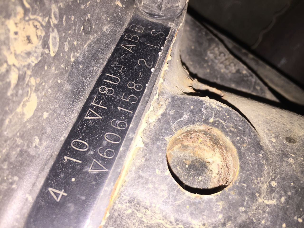

PS: There is an identification tag on the axle. On mine it's a vertical strip on the passenger/rear side of the pumpkin bolts. Like so:

Thanks dougm and blue-go, Looks like I should have the rear end serviced as I don't know the history. 71000 miles so its probably time. Thanks again for the info.

So, you may want to arm yourself with info. The part number for the Ford friction modifier. The number of ounces they should put in (I feel like it was 3.x ounces but check me), specifying the 80/90W "regular" gear oil, making sure they know that more is NOT better, and a photograph of your axle tag showing the "LS" as you see on mine.
No, none of this *should* be necessary (and it wasn't at West Coast Differential), but at a Ford dealer I'd want to go in prepared. 100% of our experiences (granted that's only two) say this is true.
