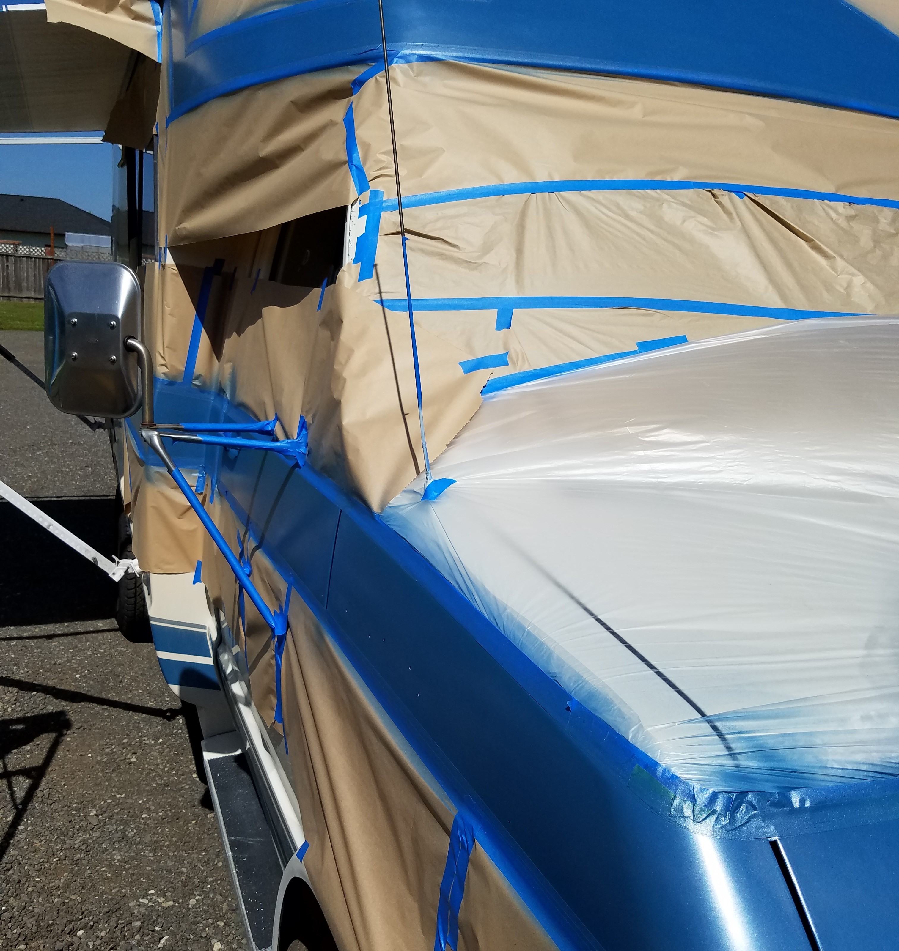

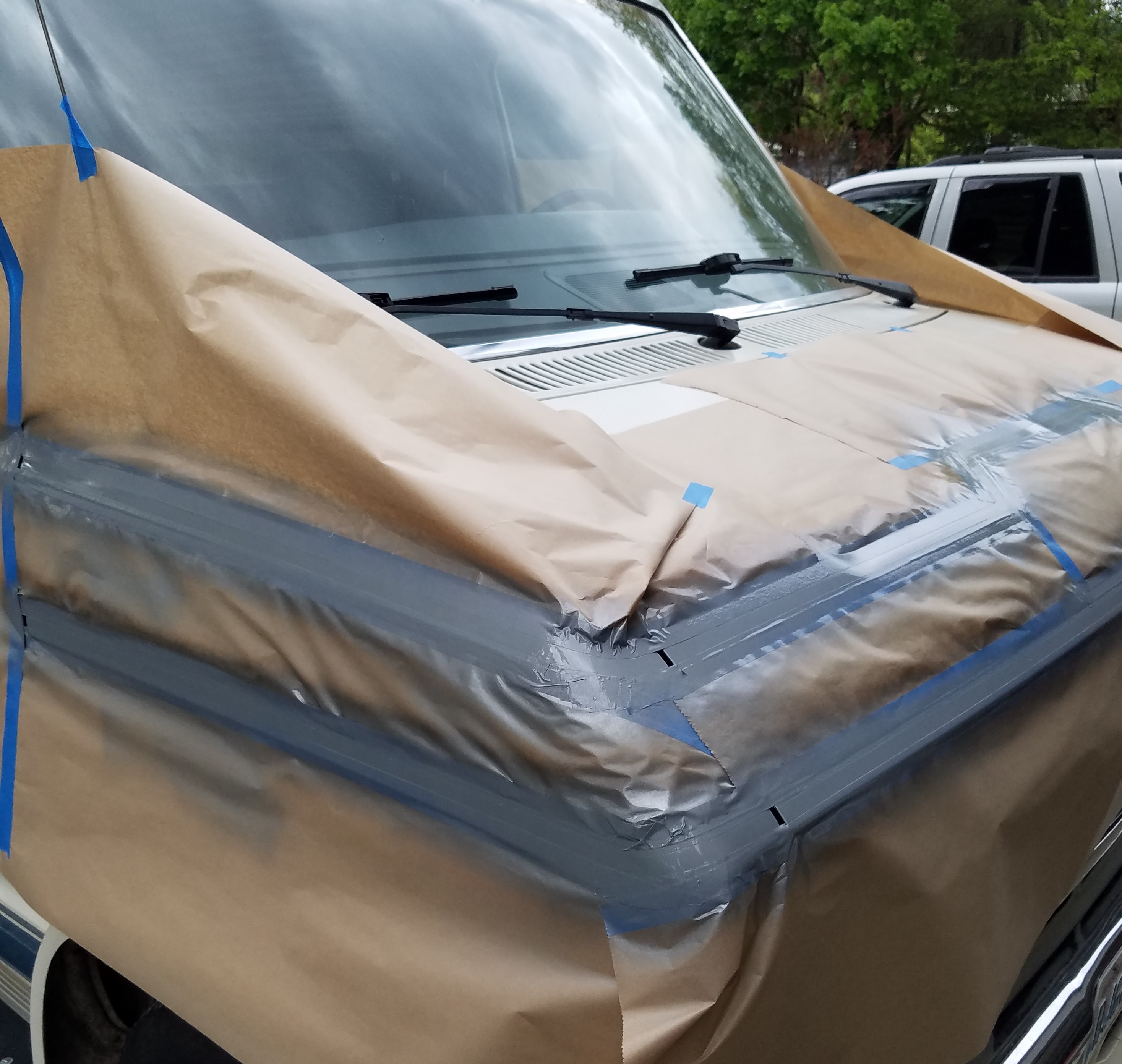

Here's what I did. Bring your Chinook to a paint store with a scanner, and let them scan the color. Then they can put the color in a rattle can for you. Then buy some clear coat in a rattle can. Then have fun!

The reason I used the scanned color, which was scary accurate, was I wanted a match to the aged color of the bottom stripe, which was not redone. My fear was that the original color would be a few shades brighter than the aged color and would stand out.
So, I recommend the scanned color. It was a scaringly perfect match.

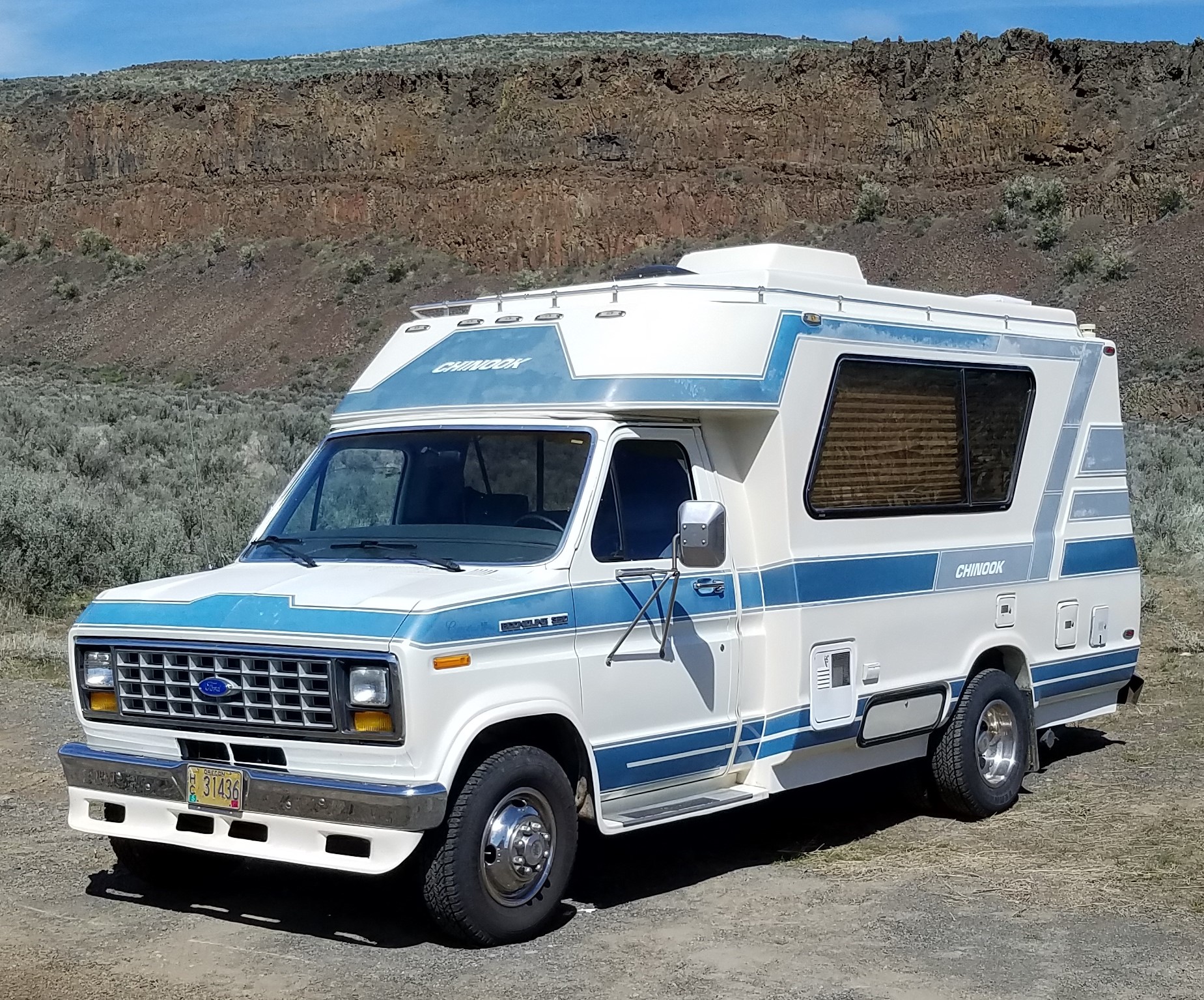

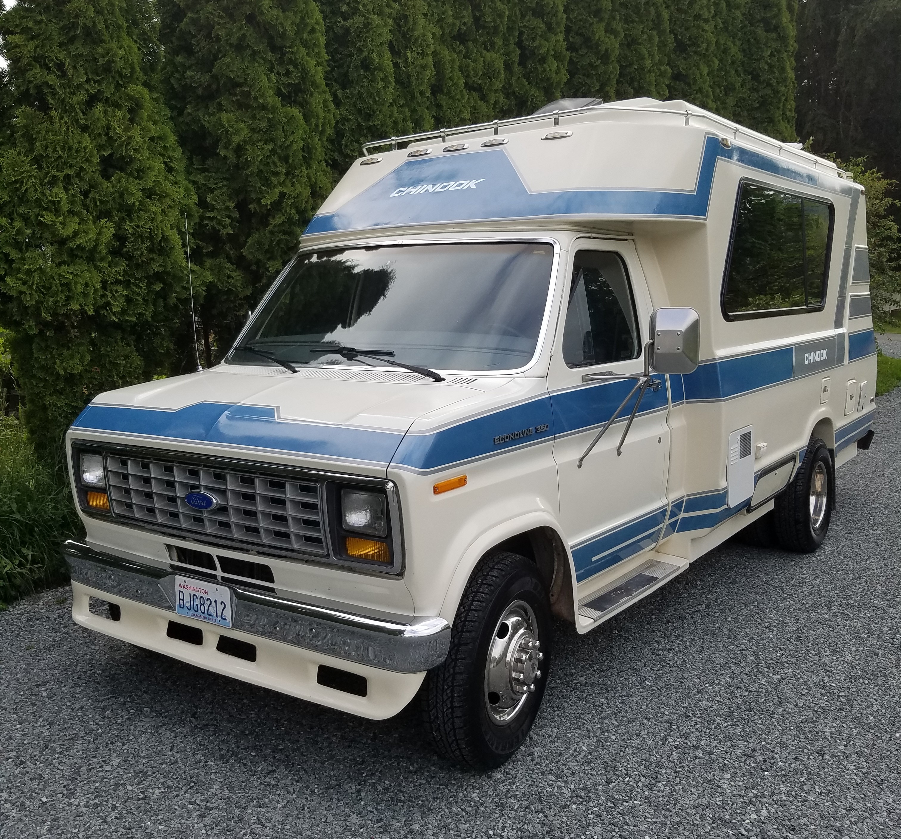

This is the "before" picture. This picture was taken before any buffing or waxing treatment of the cab, or the fiberglass as well. I also had to repaint the hood and the top portion of the two fenders. The hood was in pretty bad shape (corner rusted out not in picture), yet blended perfectly with the rest of the cab.
