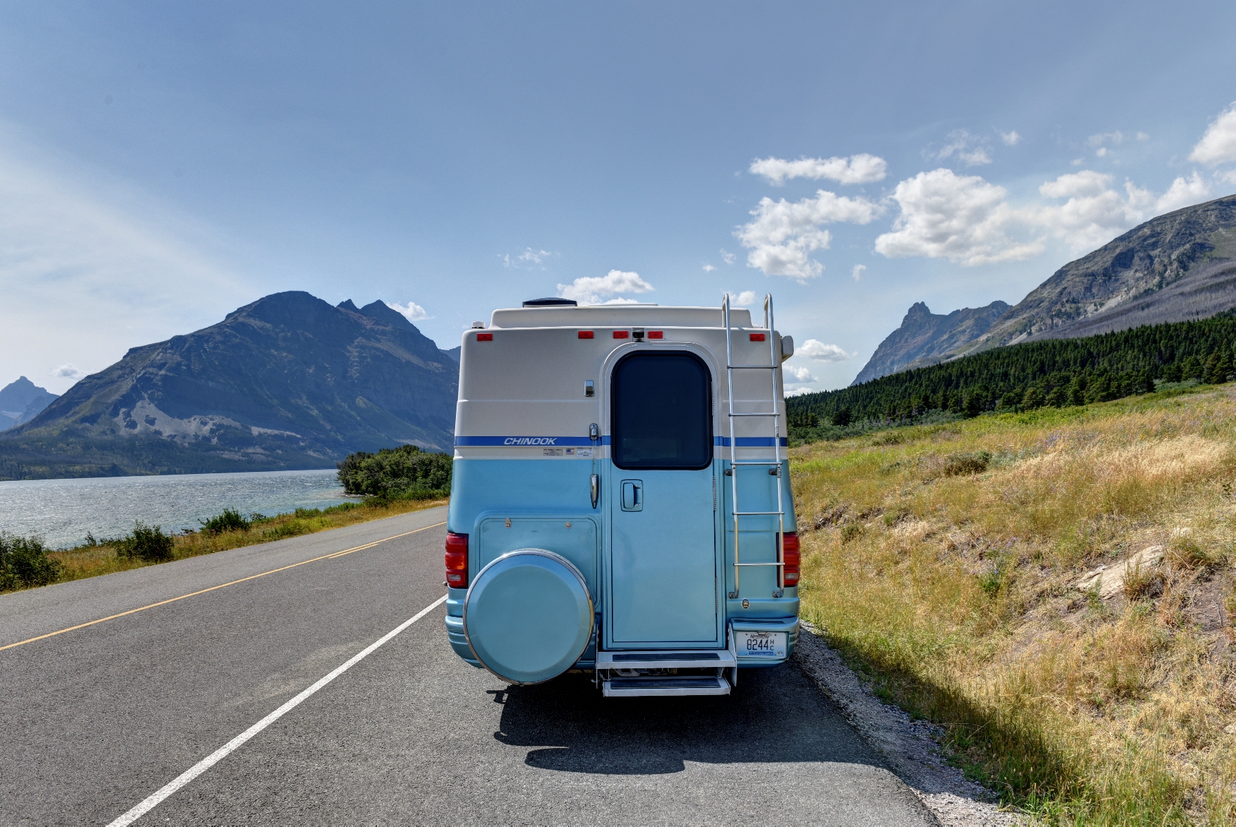

I would LOVE to have a rear awning for my Chinook. Yesterday it rained all day and I had a soggy walk back into the camper after each dog walk. I would like one long enough to extend out over the stairs including a small welcome mat at the base of the stairs. Anyone done this? I know the ladder might be a factor... Here's a photo of the rear of my rig.

Yours looks basically the same as the typical rear door 21-footer.
I have and haven't done a rear awning. Meaning, that there ARE actual, official rear awnings made for truck campers (they usually have a rear door). The ladder would be an issue, but of course one could remove it and carry a telescoping ladder (um... somewhere). Also, because of the "sporty" dip around the edge of the roof, you might have trouble gaining enough clearance for the door to open. I'm sure something could be done with custom brackets and without the ladder there.
I think one might be able to make the 48" ARB work even with the ladder. I say "might" because there is still the pesky need for the poles to reach the ground while the awning clears the door -- and of course on the rear that can be a long way down depending on parking angle. But I have eyed it up and thought about buying one to try. I think there is a reasonable chance it would work.
I have rigged up a temporary "awning" with shade cloth (I was dealing with sun not rain) and extendable poles plus guy lines. It did work, but in the end I don't like things that make it harder for me to move along, especially when it seems like inevitably someone will come along and park 20' away (in a wide-open boondock) and fire up their generator. If it's too hard for me to pack up and move (or if it feels to hard), then instead I stay and get irritated. And just for shade I can simply put my chair on whichever is the shady side of the Chinook.
But it sounds more like you want an entryway "porch roof." The ARB might do that. I like that it wouldn't need to be stowed somewhere (like my shade cloth and poles did).
Lastly, even "real" awnings all say they are not meant for rain though (I know, seems dumb). I do still see people use them and slope them to one side; probably fine in light rain.
So to summarize: Maybe the 48" ARB, even with the ladder. Or a "real" truck camper awning if the ladder is removed and it can be installed high enough up to clear the door when it is opened.

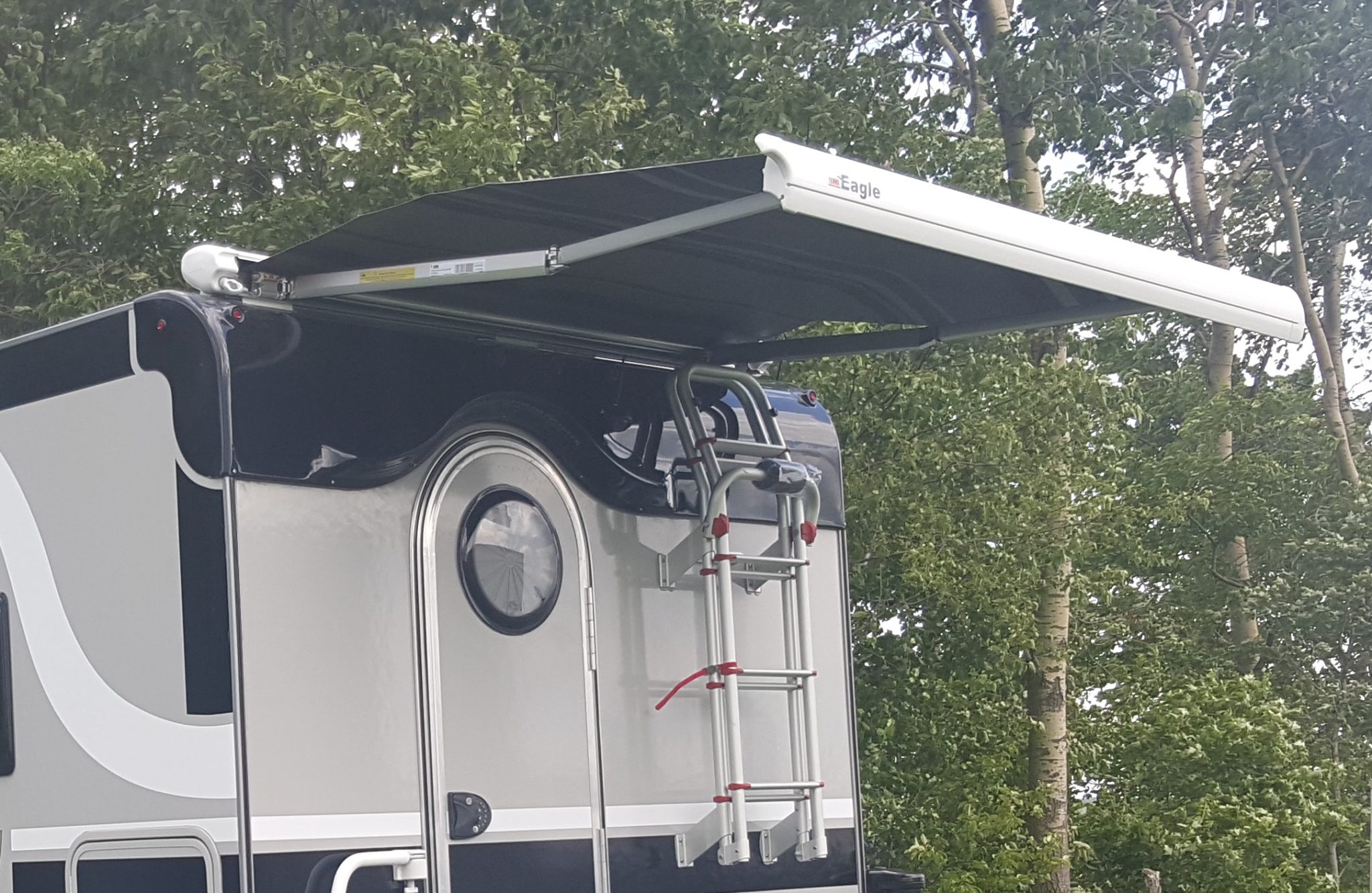

FYI:
The Fiamma F65 Eagle (pictured) is 12v operated, roof mounted using special brackets
33 lbs.
6.6" width
5" projection
approx. $850
I haven't done an accurate measurement, but installing this awning may require removal of the the top curved grab handles of the Chinook's ladder.
I like the convenience factor and "clear" side areas (no stakes to contend with) of this approach.
But from a cost standpoint, the 48" ARB is tuff to beat. I've even seen decent DIY spin-offs made for less than $100.
33 lbs.
6.6" width
5" projection
approx. $850
