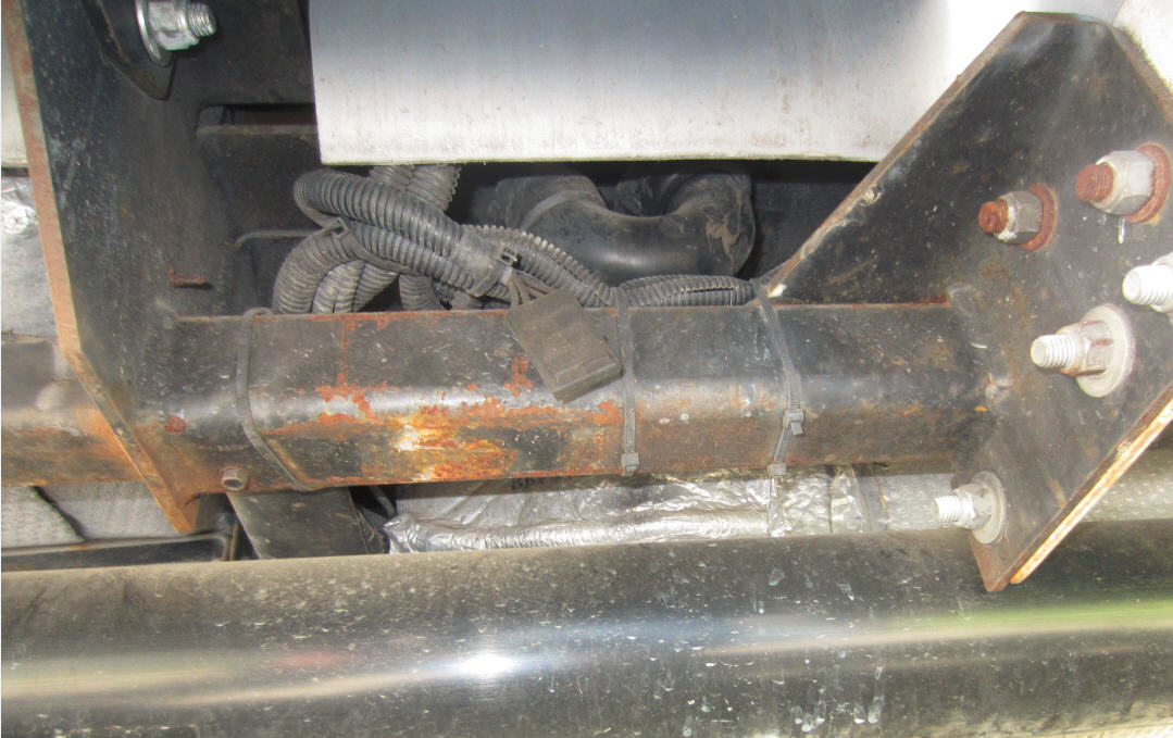

If you're curious, when you look under the coach, the Ford provided connectors (not the direct trailer connectors, but the Ford wiring connectors that one can tap for trailer wiring) are along the driver's side frame rail, around two feet or so ahead of the spare tire. There are two plastic "schnozzles" on the end of wires encased in black ribbed loom. I call them schnozzles - they are shaped slightly like submarine periscopes. The brown one is the four basic trailer wires, and the black one is the "extra three" (reverse lights wire, electric brake wire, and basic 12volt power wire) that you use for trailer connectors that are more than four wires.

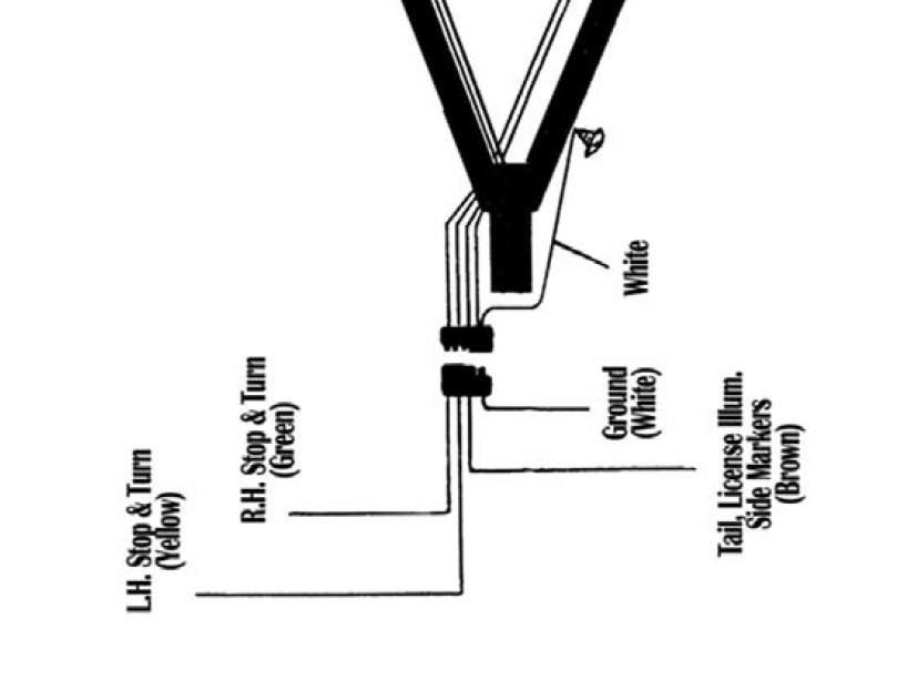

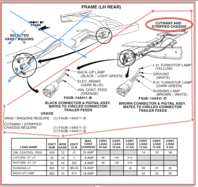

I have attached the Ford Econoline trailer wiring info. Maybe you or someone else reading this in future can use it. If you look on page 4 you will see one area outlined in red plus circled. That shows the "schnozzles" Ford provided (and Chinook also used for taillight type functions on the coach - you can see wires going from there up into the left/rear taillight area on the Chinook).
Whole document as .pdf:
Just that section as .png image (the blue lines are crossing out the non-cutaway van that doesn't apply to us):

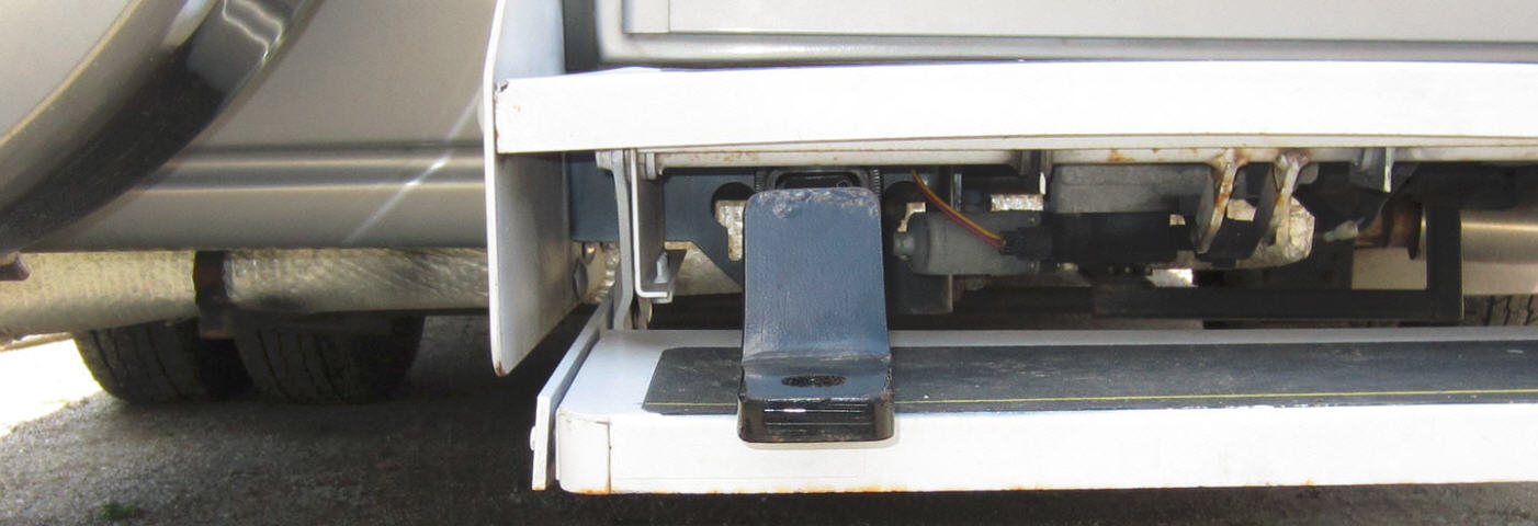

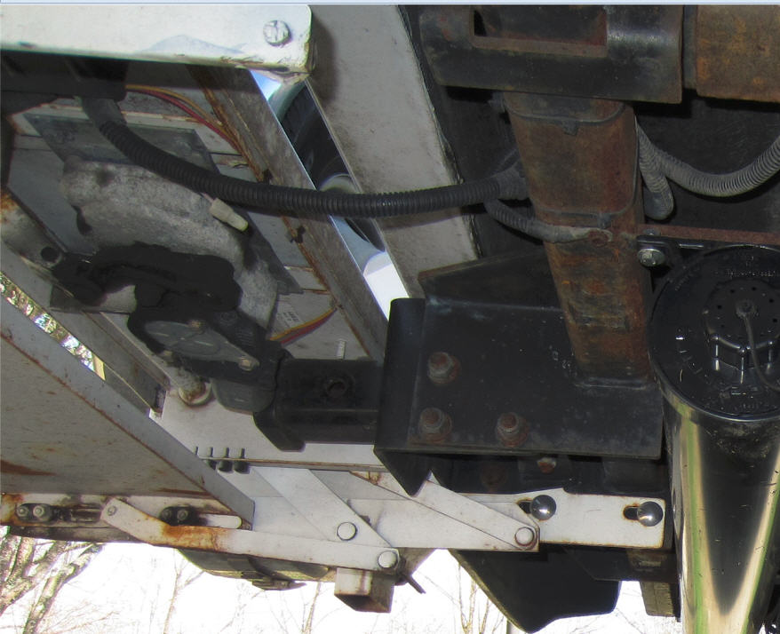

But the flat four wire connector jack is under the frame there somewhere? What's it near? I can't see it in under the Kwikee step from the photos I have which shows an armored harness going to the step with a red and a yellow wire going to the step motor. I'm going to assume the trailer jack/connector is to the left of the steps somewhere.

My four-way flat was just sort of stuffed up by the driver's side frame partway from the "shnozzles" back to the spare tire. Say, forward from the driver's side of the step bracket. Not hard to find at all once you look. And from what I have read that is the standard way. So unless yours has been modified, it's probably there.
BTW, you don't need to find matching schnozzles. Those are there to make it plug and play, but there is no reason one cannot splice wires the normal way. IIRC, that's what I did.

That's exactly it. Presuming you didn't want to keep the four-way flat (and there is no particular need as you can use adapters to go back to that if you need to), you would use those four wires (they are the ones that originated in the brown schnozzle) (they also drive the Chinook stop/turn/tail lights), and you would ALSO add in one, two, or three of the wires in the black schnozzle (backup, which Chinook used for the vehicle backup lights/trailer brake/12-volt power). For example, I needed the backup light wire, so I used that one wire from the black schnozzle, but not the other two. I could add the other two later if I wanted to since I used a 7-way trailer connector.Concourse wrote:So I think what I'm hearing is that Chinook used the cutaway's harness to drive the vehicle/coach lights and there is a standard flat four wire trailer harness. But someone that wants electric trailer brakes would have to change the trailer connector plus tap into the harness that's running along the frame rail.

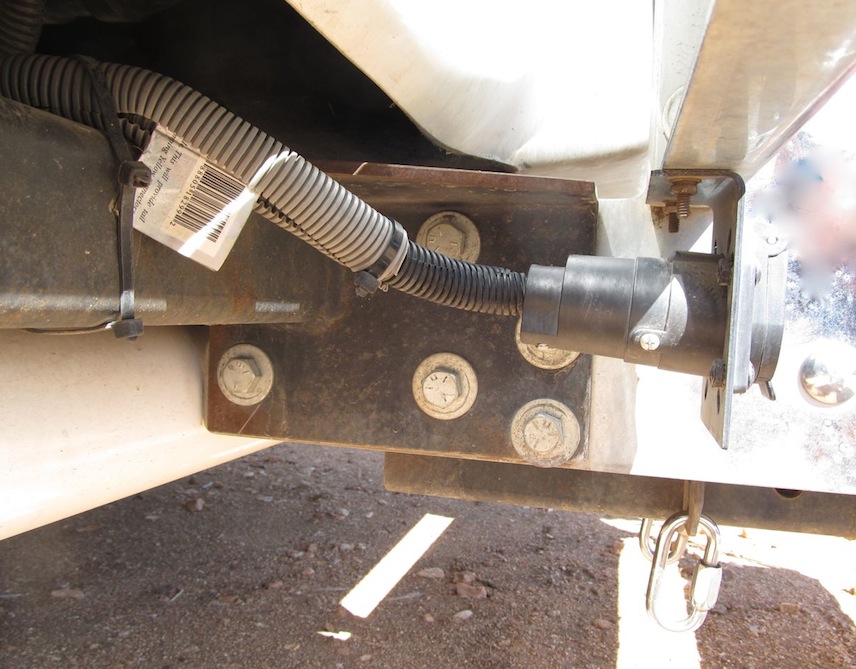

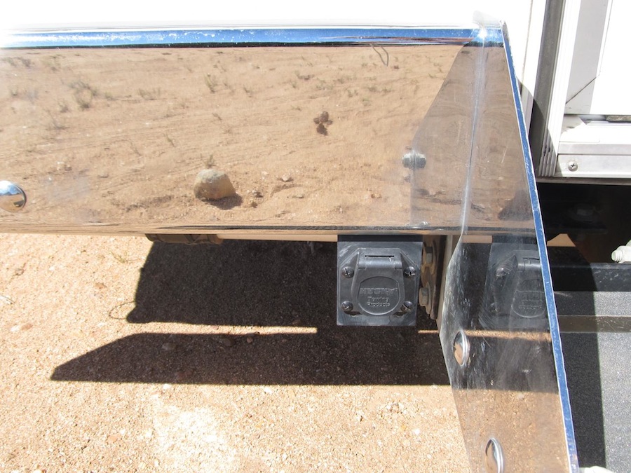

I really like the 7-way connectors. The one that goes on the vehicle is solidly connected (fastened to the vehicle), and the "lid" of it locks onto the part you plug into it (coming from the trailer). As you say, there are adapters. Actually, my trailer is a 5-way flat, but I have that "permanently" plugged into a 7-way round, which then goes into the fixed 7-way round on the Chinook. No more dangling, corroded, hard to plug in, flat connector! (And I can make it a "real" 7-way just by adding those other wires from the Chinook when I want to.)
'course anything like that is for after this weekend, when you just want to plug in and go!
I'll see if I can snap a pic of mine, just for the record.
Edited to add a couple of photos. Noonday sun, so sorry about the quality. You can see where I mounted the 7-way connector. I used two fasteners up through the bottom/backside lip of the bumper, which you can see in the second photo if you look for it. Since the trailer tongue is already to the left side of the step, I ran the wires over to that side. So far I haven't found any particular issue with that location. I like it better than a dangling 4-way.
Re: Trailer harness type?
Thar she blows!
Right where you said it would be, BG!
