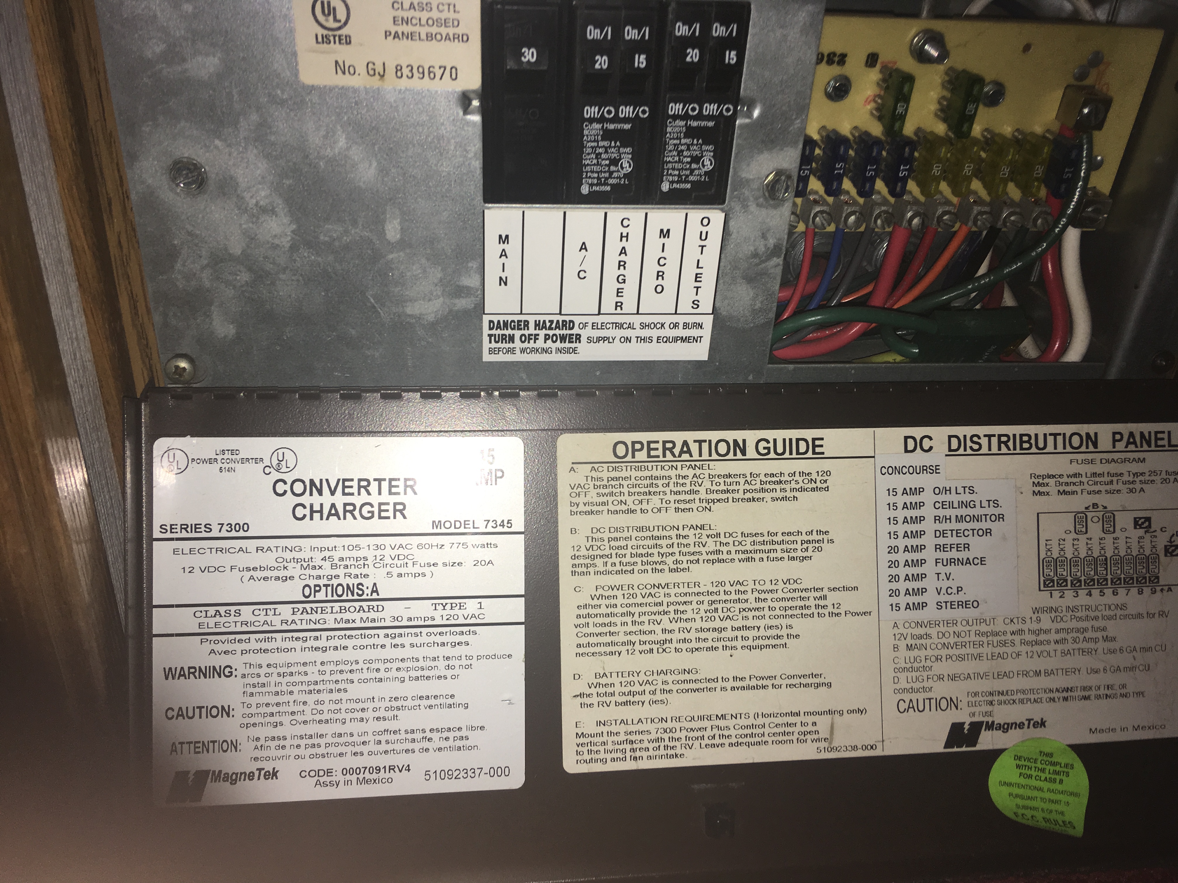

I replaced the Magnatek converter/charger as one of my first and most important upgrades. I left the new-to-me Chinook plugged in for a week, thinking it would keep the (new) batteries in good shape, and the fluid had already started boiling out of the batteries due to overcharging. I got a "used-like new" Progressive Dynamics 4645 upgrade kit from Amazon, and the batteries have been perfectly maintained for the last four years. I also replaced the solar controller/charger which had the same problems.
Here is a link to my blog describing the upgrades and installation instructions:
http://clayrushing.com/2017/01/21/chino ... -upgrades/
Here is a link to the Amazon part:
https://www.amazon.com/Progressive-Dyna ... ds=pd4645v
I noticed they happen to have a "used-like new" one available for $170. These are generally units that are returns, so have to be sold as used, but are usually unused. My refrigerator Dinosaur card replacement was also a used-like new purchase. You can save a lot of money if those items happen to be in returned stock.
Since you have manuals for the Freedom 458, it is possible the previous owner already swapped out the Magnatek 7345 for that unit. The kits are designed to fit in the original housing, so you have to look inside the brown box to see what is actually installed.

caconcourse wrote: December 1st, 2018, 11:20 pm I replaced the Magnatek converter/charger as one of my first and most important upgrades. I left the new-to-me Chinook plugged in for a week, thinking it would keep the (new) batteries in good shape, and the fluid had already started boiling out of the batteries due to overcharging. I got a "used-like new" Progressive Dynamics 4645 upgrade kit from Amazon, and the batteries have been perfectly maintained for the last four years. I also replaced the solar controller/charger which had the same problems.
Excellent info on blog, exactly what I was looking for. as I have your issues you fixed. Below is pic of the 7345, it seems still in-place.

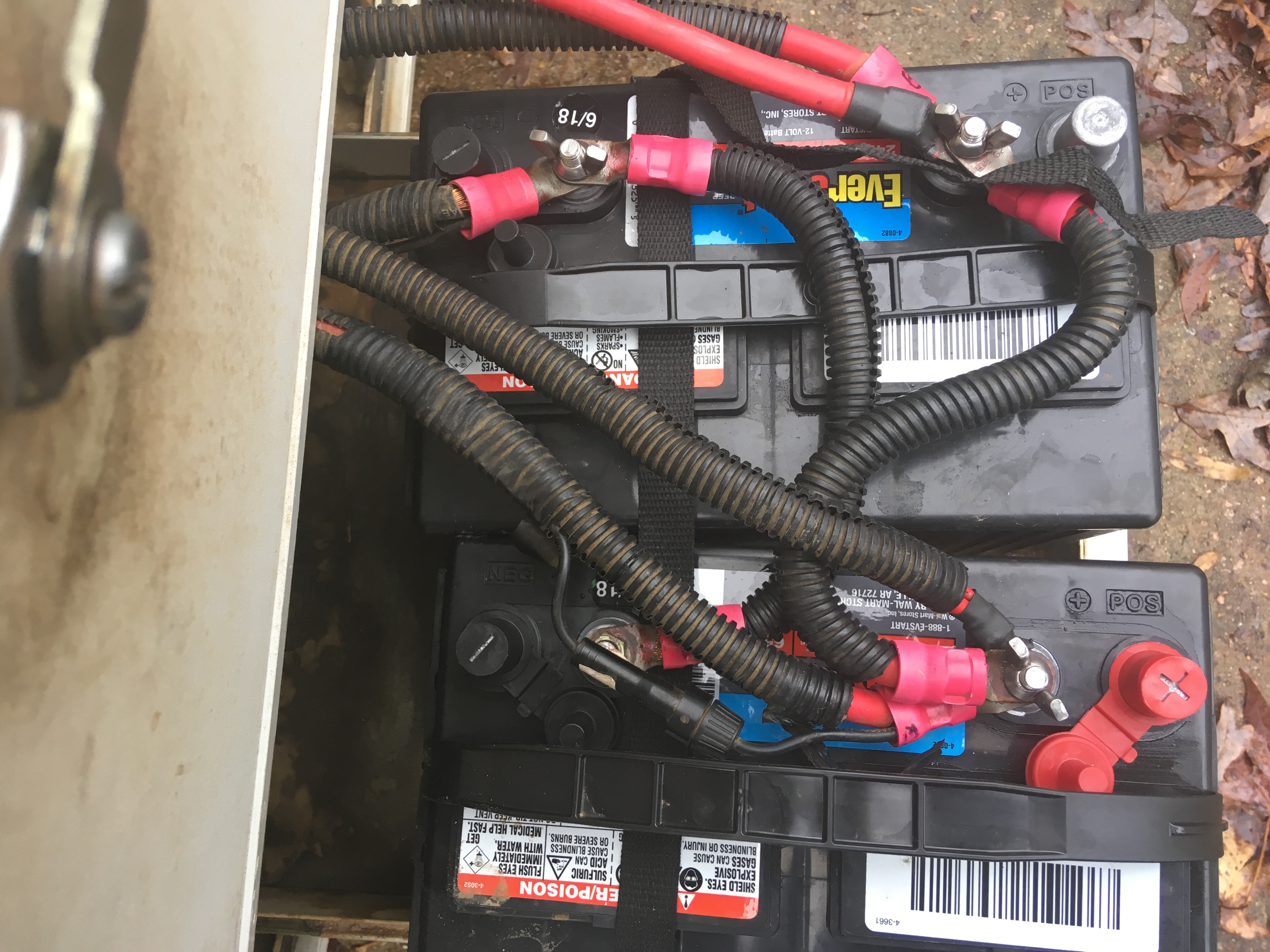

Here is pic of battery cables, not sure if this goves clue to how things are set up...

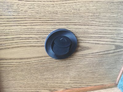

Also, any idea what this is underneath back closest? Is for vacuum?
