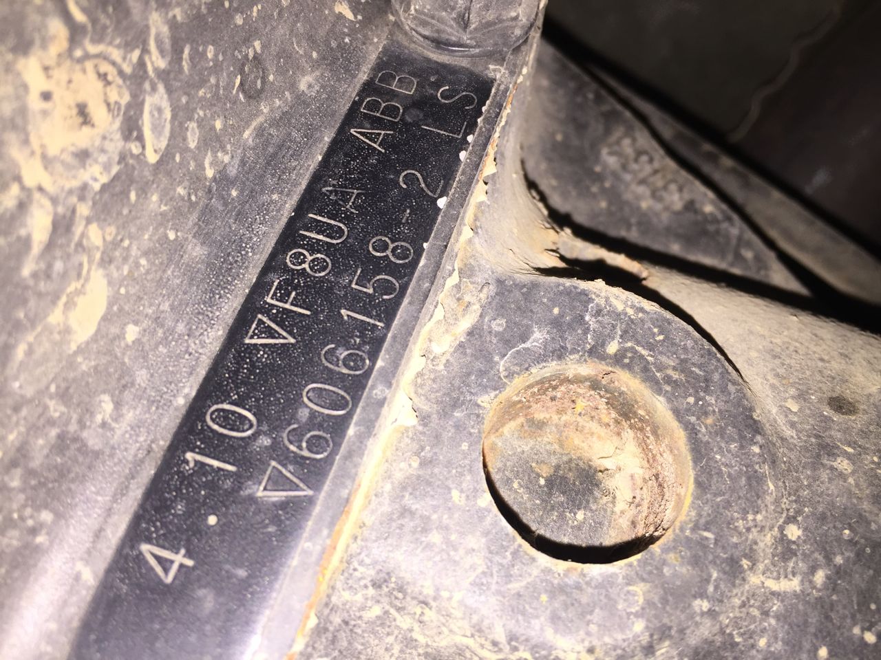

Just so it's searchable, the tag says 4.10 VF8UA ABB V606158 - 2 LS
Is yours the same?

Ok, here's your tag: 4.10 VF8UA ABB V606158 - 2 LS
4.10=Axle ratio
606158-2=Axle BOM ="1998.5-99 E-350 Cutaway SRW or DRW Option - ABS" Powr Lok Diff,

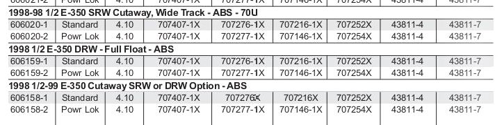

Odd that it isn't specifically labelled as 70U or HD in the catalogs. Looks like it uses all the same parts as the 70U. Dana parts site lists the 2017530 bearings as 70U.
You can put the 6 digit BOM "606158-2" into this table here:
http://www2.dana.com/expertforms/deabill.aspx
And then by looking around on there it seems they went to a 70HD in 1999? Those use the 2017529 70HD bearings.
I think easiest tell is that the 70HD has 4" axle tubes instead of 3.5" tubes?
