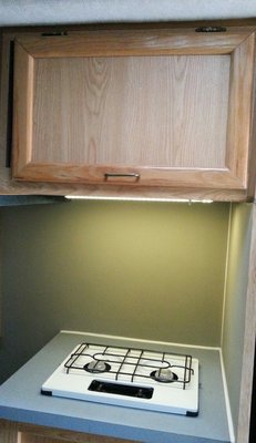

I removed the hood "vent" basically right when I bought the Chinook. It didn't do anything other than make it impossible to see what I was cooking. Probably cooked 500 meals since then with no regrets. There's a roof vent directly over the galley, so in the rare cases that require major ventilation, I just run that fan. It airs out quickly. Bright LED lighting under the microwave cabinet is much better than the stock light.

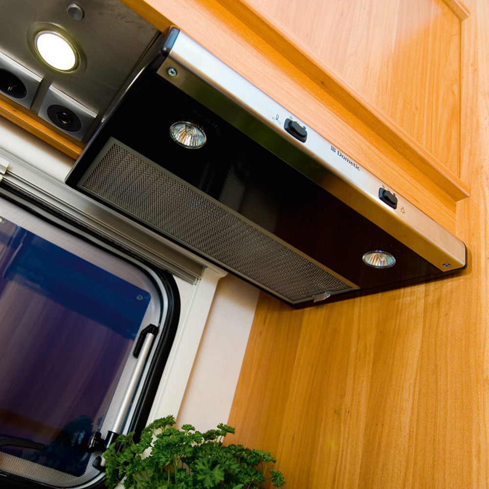

I took mine out three years ago. I did plan to replace it, but had an issue sourcing the really cool Dometic one I wanted to replace it with (not available in the US, but it's flush to the cabinet and the fan is on the roof pulling vs. in the room pushing). That said, as time has gone by I have discovered it is not essential for me. I still may try to get that one...? Possible factors:

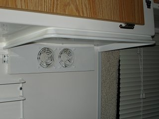

I did find this mod very interesting... a cooking sheet and two computer fans.

Blue...this is what a search came up with: Dometic CK 400 extractor hood vent. Is this the unit you were thinking of?Blue~Go wrote: September 10th, 2018, 9:05 am I took mine out three years ago. I did plan to replace it, but had an issue sourcing the really cool Dometic one I wanted to replace it with (not available in the US, but it's flush to the cabinet and the fan is on the roof pulling vs. in the room pushing). That said, as time has gone by I have discovered it is not essential for me. I still may try to get that one...?
I like it! Uses a simple dryer-type duct hose to vent.

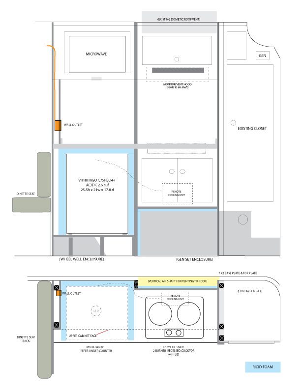

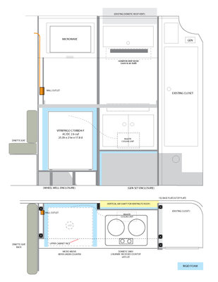

In the meantime, this is diagram of the galley remodel. The narrower depth of base cabinets gain almost 6 extra inches to the aisle! Plus an additional 30" of counter space. The SMEV cooktop is recessed with a flush lid for more surface area as well. I got the idea from Blue-Go's remodel yanking out the old refer. Man, what a difference. The hardest part was locating the last of the "Dusk" Corian (discontinued) to fabricate the matching countertop and then having to do all the construction myself when my "carpenter-guy" moved out of town.

I'm currently placing bulkheads in my rig, and trying to figure out ideal sizing/depths. I don't see any dims on your drawing, but it looks like you have the cabinet/counters in-line with the back door, so ~20" deep at the base? I'm thinking of adding a "notch" into my bulkhead to let a counter span the area, definitely looks like a better setup than another vertical wall.
