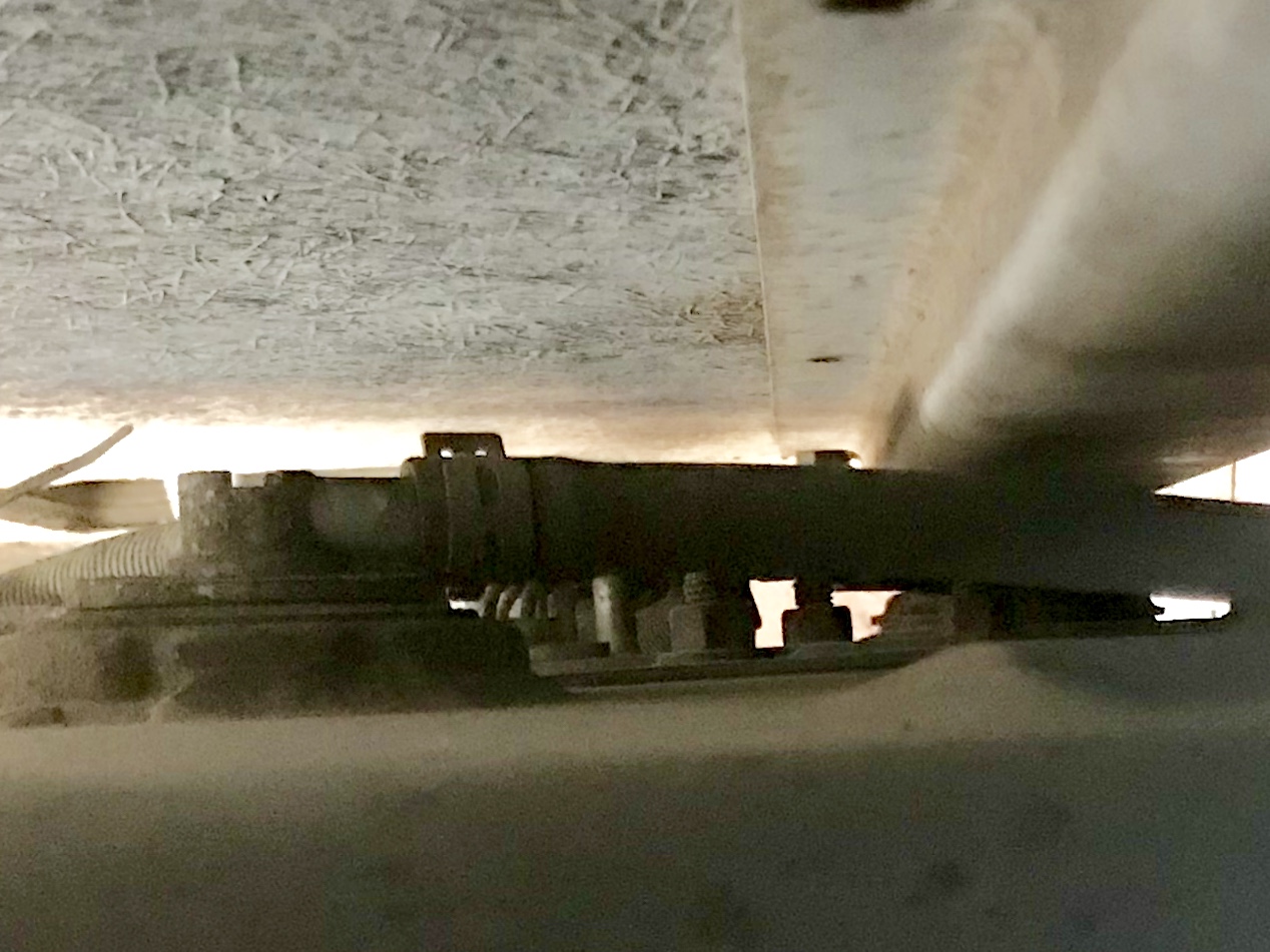

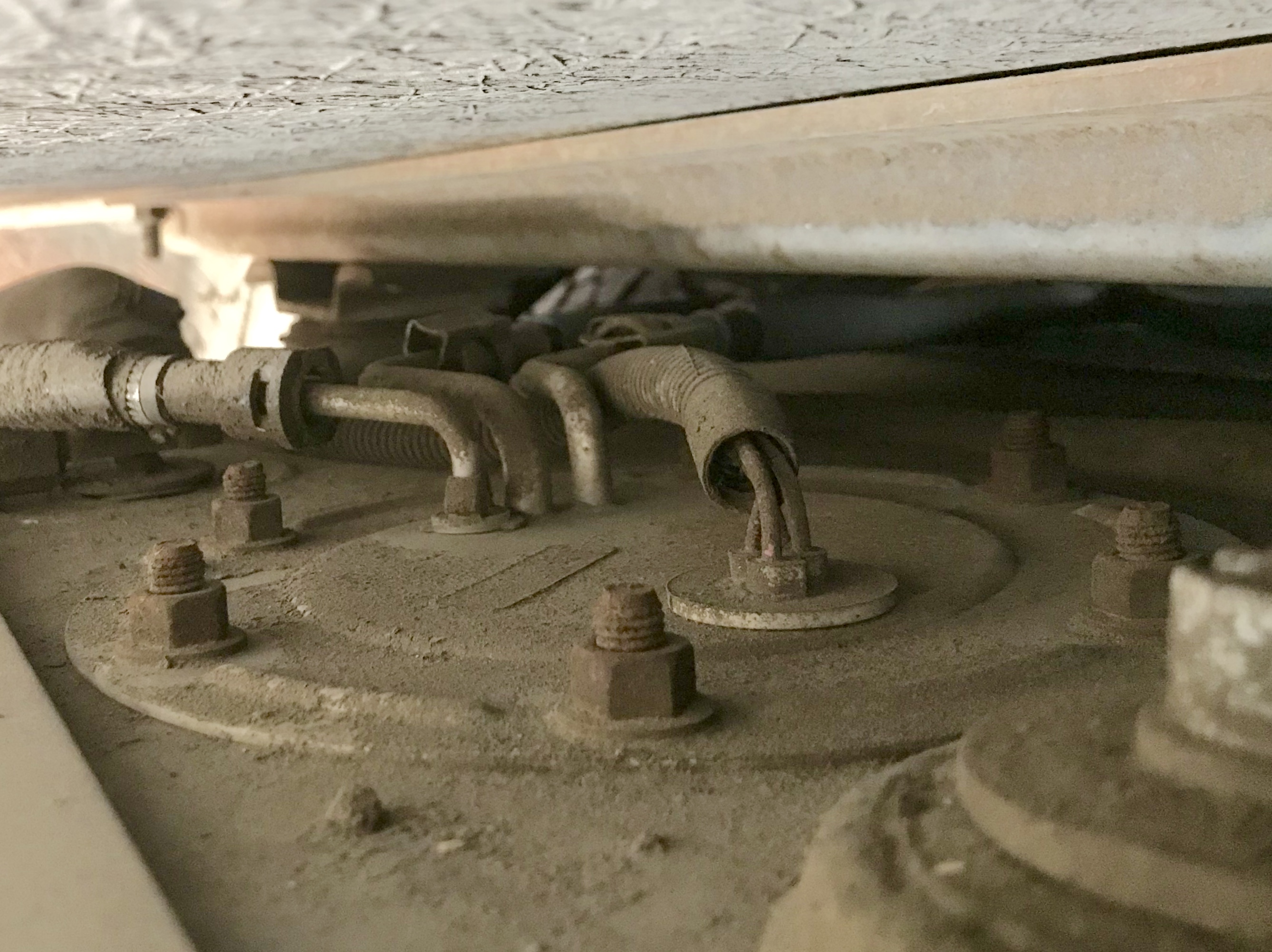

It looks like it might be more of a hassle than it's worth. The fiberglass will likely splinter, and then make it more of a pain to loosen the fuel pump bolts that are under the steel cross member hat-channel.
And with that hole cut, would you be able to lift out/put in the old & new fuel pumps?
First pic showing the area, and channel. 2nd pic showing the side view.

I wouldn't think it is that hard to drop the fuel tank to replace it. I wouldn't want to drill a hole in my chinook although it is not that hard to reglass the section back in.
Re: Cutting hole in floor for fuel pump access?
I wouldn't have a huge problem making a hole, if there were a really good reason. Depending on the year (at least from my era forward; not sure about 18+ etc.), it's either plywood with a fiberglass layer on the underside, or I believe a fiberglass/foam/fiberglass sandwich. Either can be cut fairly easily. Depending on where it comes out inside, you could use a round boat deckplate (if under furniture or carpet); if in the open area you'd likely want to get more fancy (or go for a nautical look
But that said, would I? Probably not. My buddy with an E-450 other-brand Class C had the fuel tank dropped (to repair/replace a generator fuel line) and also had the fuel pump done just because they were in there. It wasn't cheap, but it also wasn't ridiculous. I guess I'd classify it as an "ouchy" maintenance bill but I'd only expect to do it once if at all.
OTOH, if I were driving to Panama... maybe? But maybe not as from what I've seen auto repair folks in out-of-the-way places can pretty much do it all. I'd likely have it done the "regular way" before leaving and then see how it goes.
On the (this must be the fifth) other hand, since your rig is completely gutted anyway, maybe make a hole, change the pump, and then permanently repair it. That would be much easier than making a concealed access plate to use over and over. Just a bit of core and some fiberglass (cheapish), patch, fair and go on.
Good point on the crossmember though. That might mess up the whole plan anyway. Maybe someone who has done the job will let us know on that.

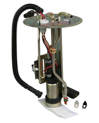

Out of curiosity, I see three nipples out of the fuel pump assembly. One probably goes to the fuel filter, but what about the other two? Anyone know where the generator get the fuel from? I there a separate and dedicated hole for the generator?

I believe the tubes are Supply/Return/Aux (goes to a hose that goes to the generator.) I believe the generator pickup tube only lets you draw the tank down to ~1/4 full. My gen. hose has a bolt in the hose, and a hose clamp around it.

I just had my fuel pump replaced by mechanics. Dropping the tank allows best access to replace the pump, but the tank needs to be in-place to reattach the fuel lines. As you can see there is little clearance. In our case it took many attempts over several hours. We weren't sure they would be able to do it. One reason for an access hole is to reconnect the fuel supply tubes.

Ah, good point on the reconnecting with the tank raised. I’d think Ford would’ve left some slack in the fuel hoses for that. Maybe it’s harder with the generator line and other Chinook stuff in the way? I’ve read up on some other RV makers that make an access hole from the factory.
