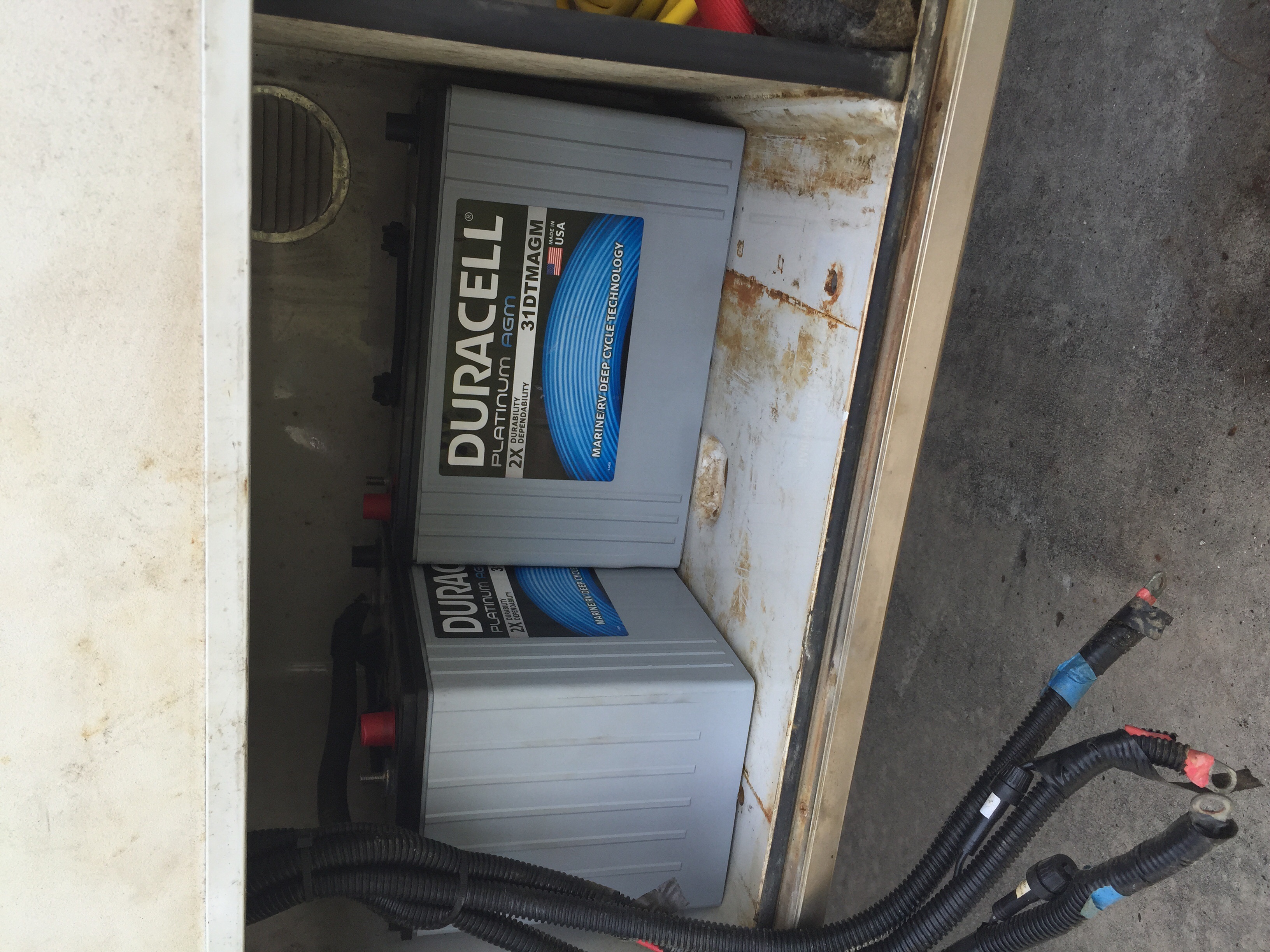

Pic is after removing the slider tray. Seems like we could fit even taller batteries though? Maybe there's a group 31 "tall"?
Removing the tray is 4 bolts. Those bolts were very rusted on mine. I think some of that was due to Battery acid. All 4 broke pretty easily with a socket and socket wrench. Then a couple pound hammer sled thing beat them out with 1 wack each.
I took the chance to clean up the compartment. (Dust pan/broom and then a wet shop towel).
Pic shows the battery orientation I used with 1 battery missing from the pic still. You get the idea.
