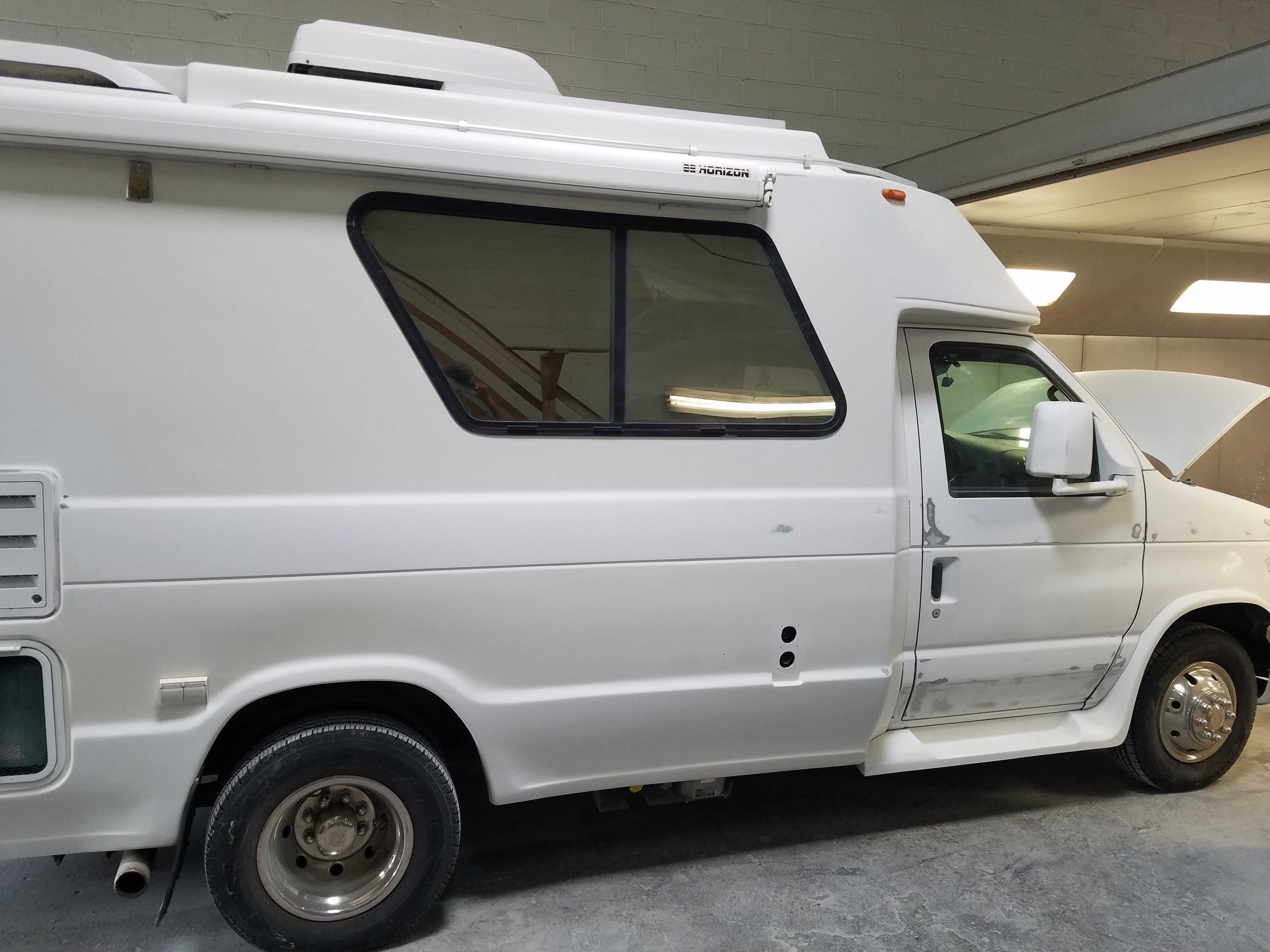

Search for "Paint Job" in the Projects/Mods section. You can read Skillet's thread and see some photos, including one of his handsome rig.

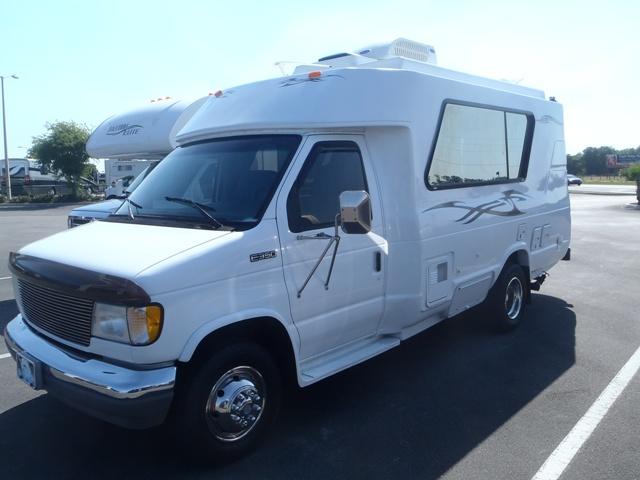

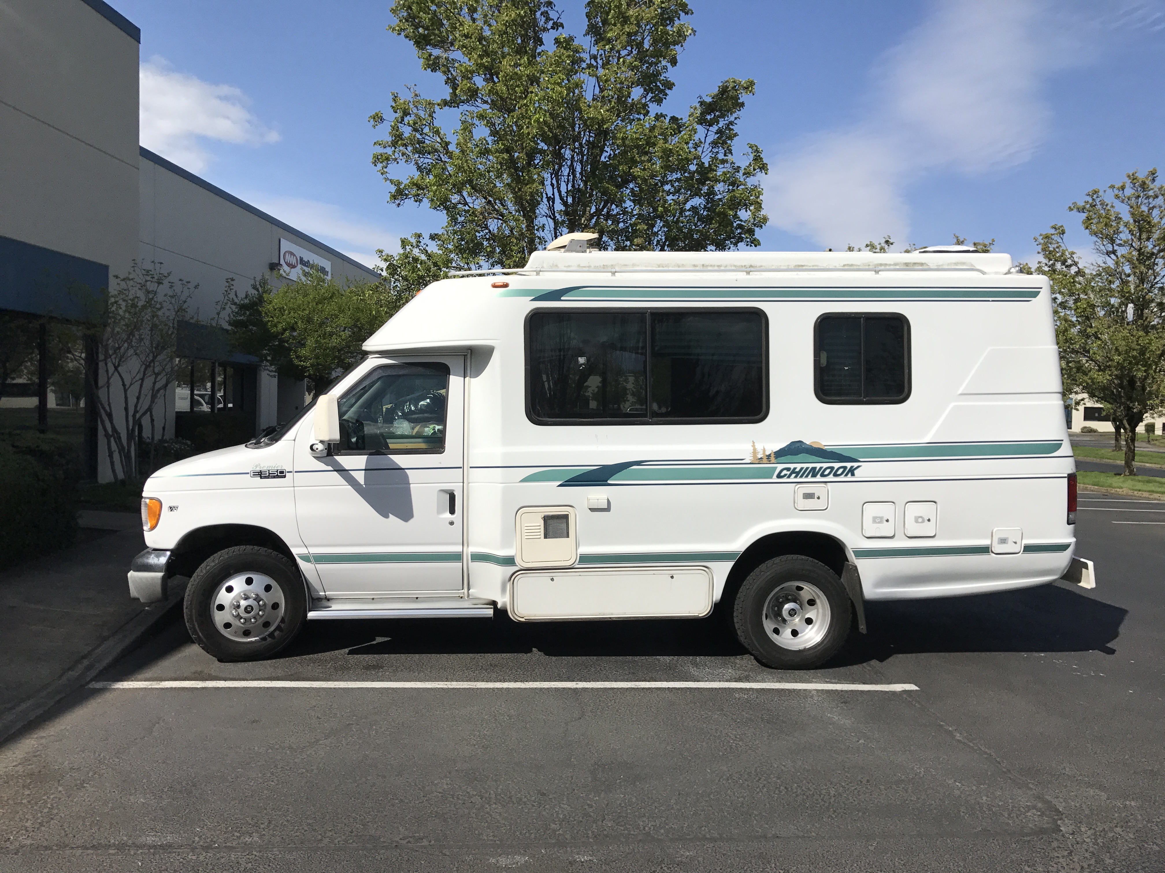

I have a Premier with the millennium paint scheme which I like but that is dated as well. (Its the picture that is on top sometimes with my Jeep Wrangler in the snow) I would think nothing is too little but have seen a Premier with a simple side striping that looks nice. I will look fore it and post if I find it. Nice to be able to do things in house!
EDIT here's the one I was thinking of
