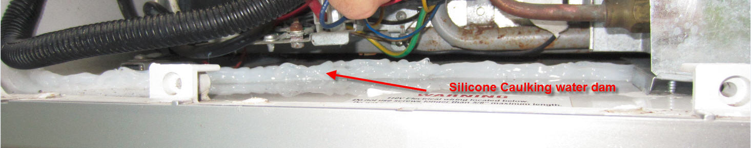

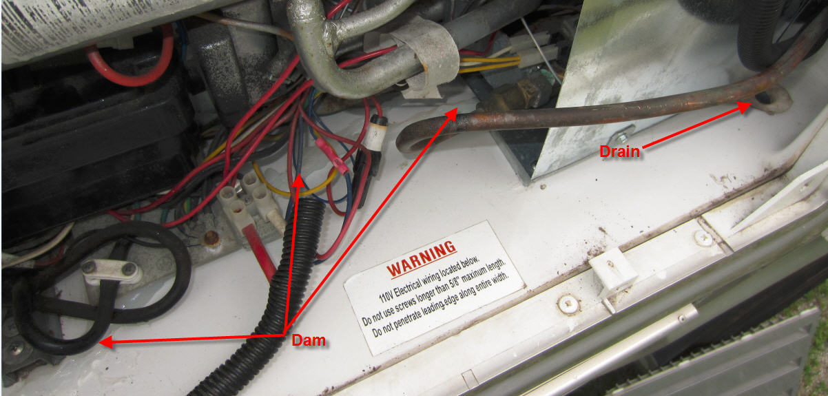

Bummer. Its my opinion that it's only a matter of time and conditions before this happens to any Concourse. There is a modification to the fridge mechanical room floor (outside RV, open access door, look down at the area's white fiberglass floor) to help avoid this issue. The floor has a built in water trough with a drain at the far right end near/under the heat shield of the propane burner tower. The trough and drain are a good idea but heavy rain and winds can overwhelm this drainage system and then the rain water will drain elsewhere like inside the coach which then gets drawn into the MDF wall panel like a sponge and swells the wall. Even a slight tilt to the left side of the coach will aid in the water running inside instead of out through the drain hole. The modification is to build a water damn using silicone caulking left to right on the fridge mechanical floor behind the trough so that the water won't be able to flow to the inside of the coach but will still be able to enter the trough and run out of the drain hole. Also as preventive maintenance chase the drain hole all the way down through its drain tube to make sure there isn't a blockage in the drain system.

Thanks for that tip. Mine appeared to be the actual flange on the outside of the RV. Hard to explain.. Should take a pic.
