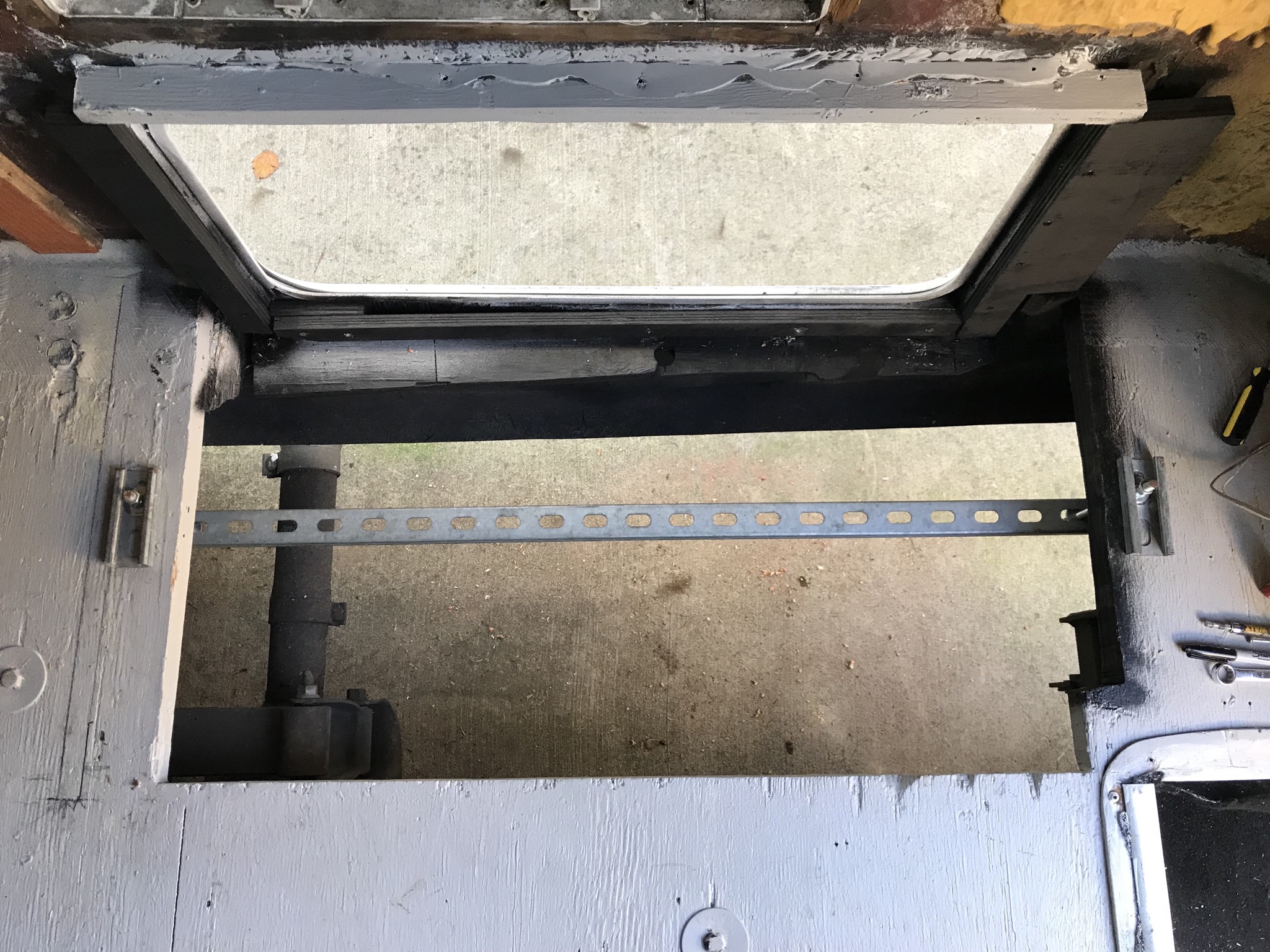

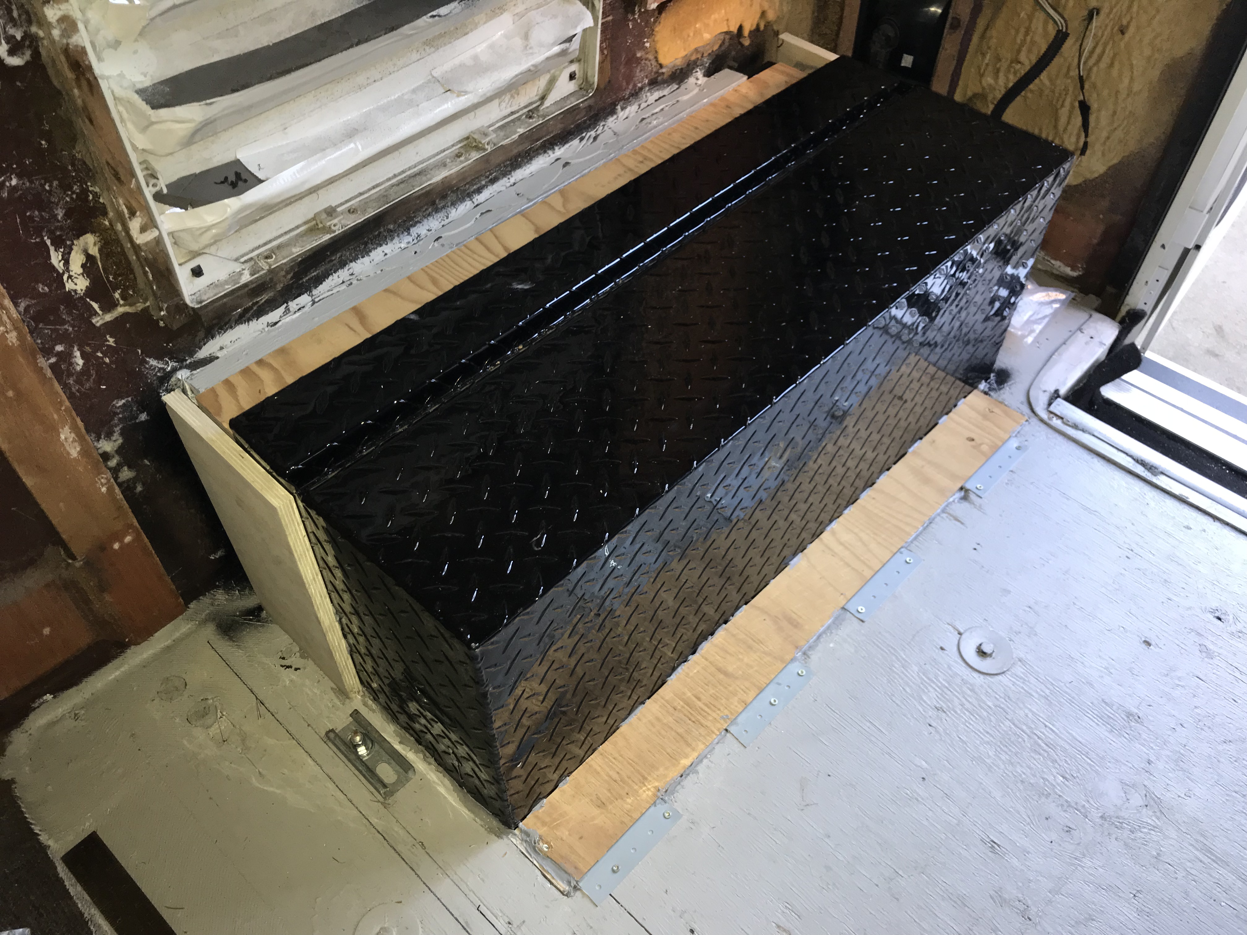

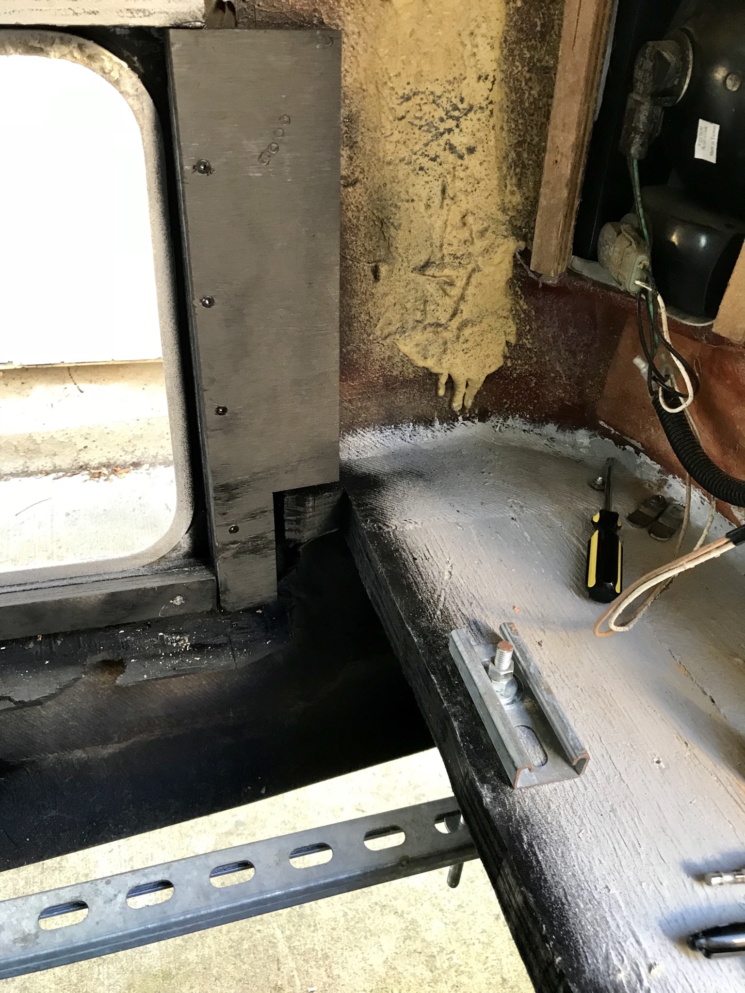

Well, I finally got the box anchored in. Super solid.
It’s supported underneath by unistrut and an old one way street sign. The idea is to be able to hold a generator, gas, propane tank and drive down a dirt road with no issues...! Or a bunch of water jugs, etc. Just didn't want the bottom falling out.
Then there are big HeadLOK structural lag screws running horizontally into the floor fore and aft. Sheet metal screws down into the existing lower pass. side plywood support lip/shelf. More screws sideways into plywood pieces that help close off the opening to wall gap. Finally a big, doubled up ply filler strip that closes the remaining floor hole/strip. Some brackets on that and then screws from inside the box to the filler strip. AND a whole tube of Loctite PL MAX construction adhesive for good measure... Still need some random filler strips and caulk to air seal.
Phew, amazing how complex things can get...!

Nice solution. Looks strong. Just made me think: I've used just about every construction adhesive on the market, and the Loctite PL line is the best when used in the correct application. Loctite products are pretty amazing apart from their silly expiration dateseporter123 wrote: November 19th, 2018, 11:15 am Well, I finally got the box anchored in. Super solid. .. AND a whole tube of Loctite PL MAX construction adhesive for good measure...
