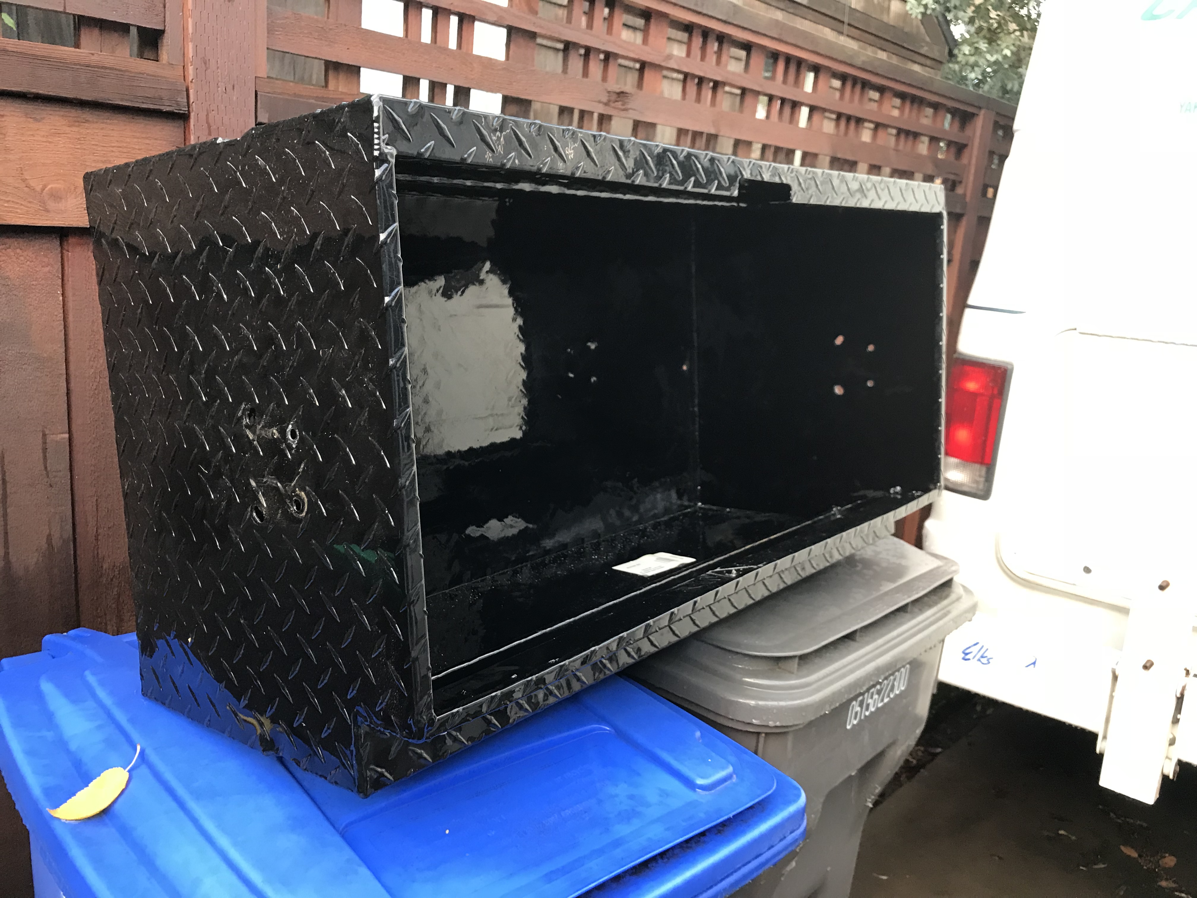

Well, I've made a little bit of progress. I got stalled out trying to figure out a good solution for the missing generator box. I really like the idea of an externally-accessed storage box for a generator, gas, propane, etc. I didn't want to just build a wooden box there. Sure, a custom-made metal box would've been nice, but spendy. I learned awhile ago that sometimes the best thing to use is something that's already made.
So, after a couple months of looking on Craigslist, I found this 37" wide Deezee 8537B storage chest. It's made of ~1/16" welded aluminum. Super light, fairly strong. It fits into the generator "hole" fairly well, and leaves a small gap inboard. Just had to cut ~1" out of the side of the hole. It's all laminated plywood back there, no foam core.
It is kind of a black hole in there, plain aluminum would've been easier to see things in, but it's all I could find without spending a ton of $$. I'll be putting a piece of plywood in the bottom to add some strength and spread the load out. I'll add some through-bolted angle brackets that attach the chinook floor to the box sides, and maybe some that strengthen the box sides to the box bottom.
Re: Project "Shell" nook
Posted: October 30th, 2018, 9:02 am
by eporter123
I had to drill out some rivets to take the lid off the box, then removed the handles and latches. The box sits in the chinook flipped 180-degrees from this picture, with the offset lip/step/opening at the top. It all lines up surprisingly well with the lower support lip on the Chinook Shell, and the top of the hatch opening. I'll have to frame the door with some 3/4" plywood to make up for the curve of the shell, then follow the RV manufacturer method of using lots of screws, adhesive, and caulk to make it all look good...

Well that was clever! Good use of existing product.
My original box is made of galvanized sheet that is "folded together" at the joints to make it airtight (there is probably a better official term for that). Probably easy to make if you have the tools and skills (I don't). Also helps if that is your only project (which, ha, who only has one project going?!)
I totally get how one particular facet of a project can bring the whole thing to a halt. Good on you for getting your momentum back.
For awhile I considered just doing away with most of that compartment so that I could have a flat floor there for more refrigerator room inside. But I quickly decided that more outside storage was more important to me.

Will you be installing a drain tube inside to prevent it from holding water from outside elements?
Posted: November 1st, 2018, 8:55 am
by eporter123
I think I'll be adding some holes in the bottom, and some vents down low on the sides. That will hopefully let any water, and any propane/gas fumes vent out.
These louvered/screened style vents just snap into a drilled 1" diameter hole. Looks fairly simple.
