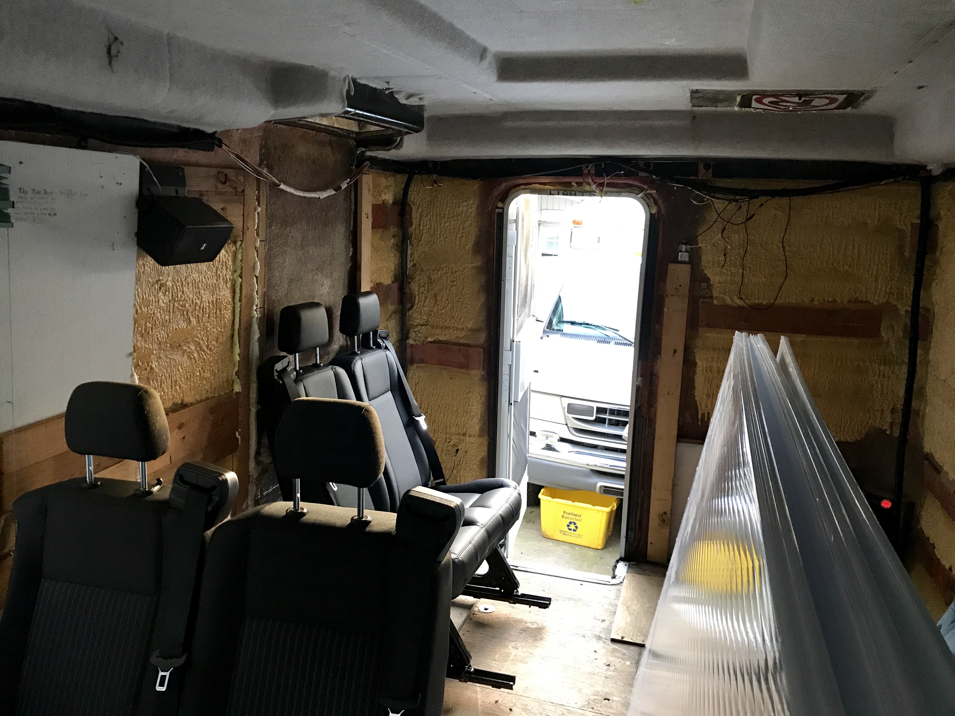

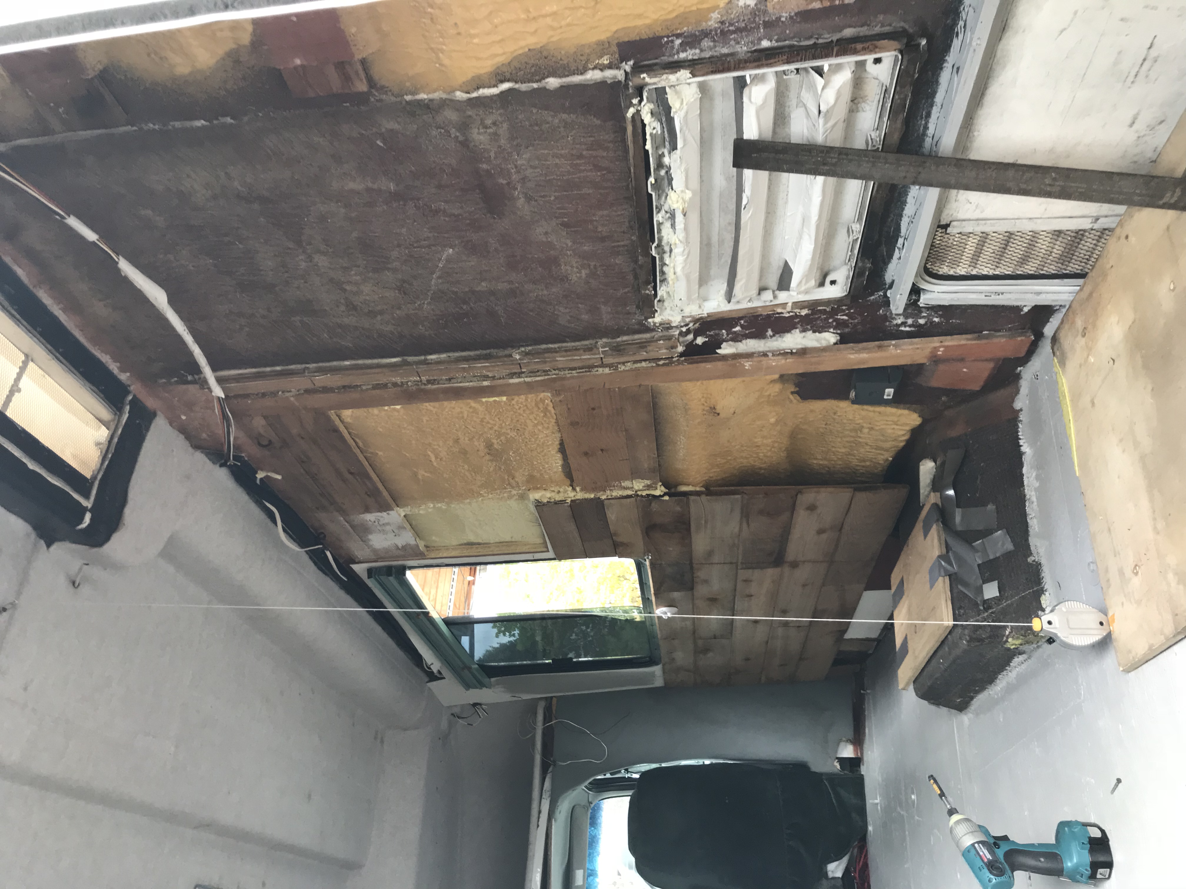

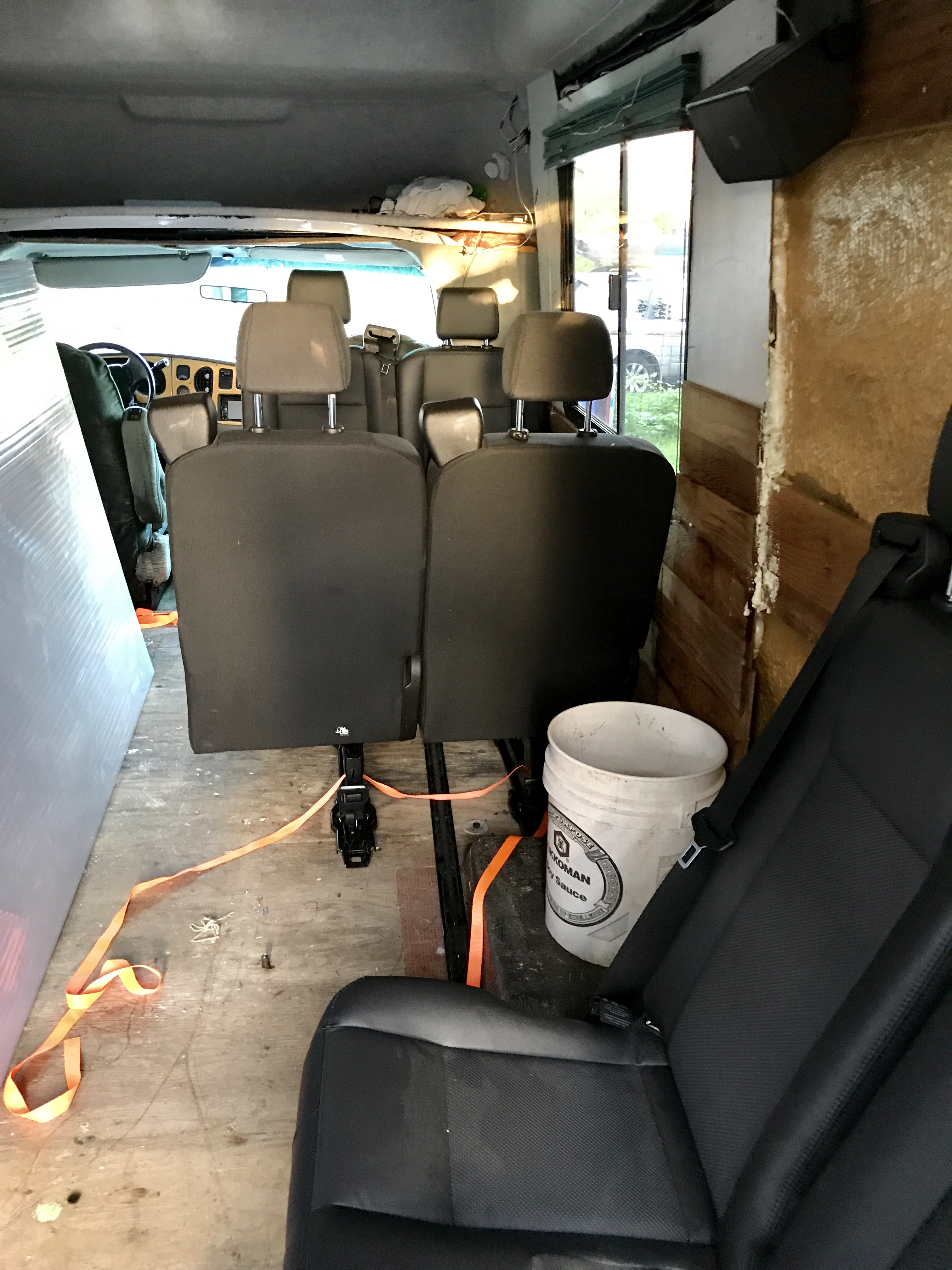

Not a whole lot of updates, mainly been cleaning out the 'Chinook and trying to figure out how best to mount some seats. Here's the current setup with Transit Van seating for 6... Not going the shuttle bus route, but it sure looks like I am!
Re: Project "Shell" nook
Vehicle seats are usually pretty comfortable. I used a Stow-n-go seat for awhile as a club chair replacement for my dinette.

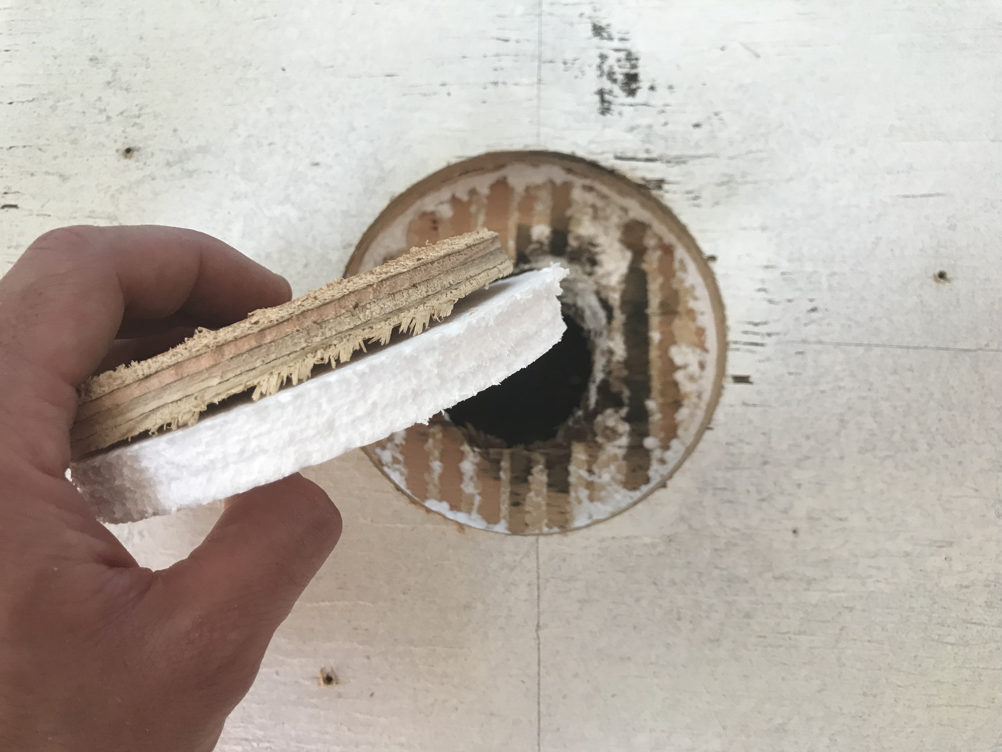

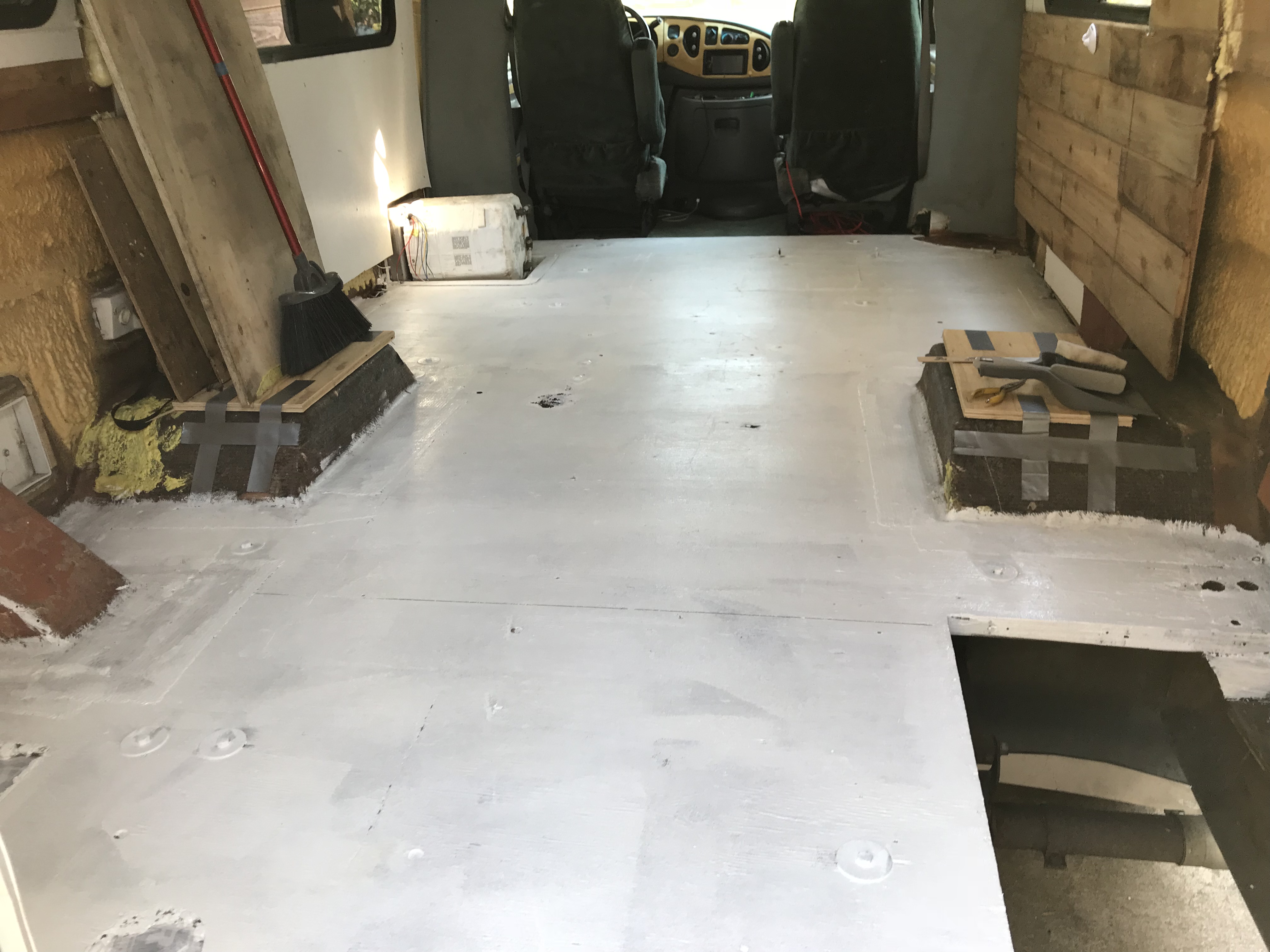

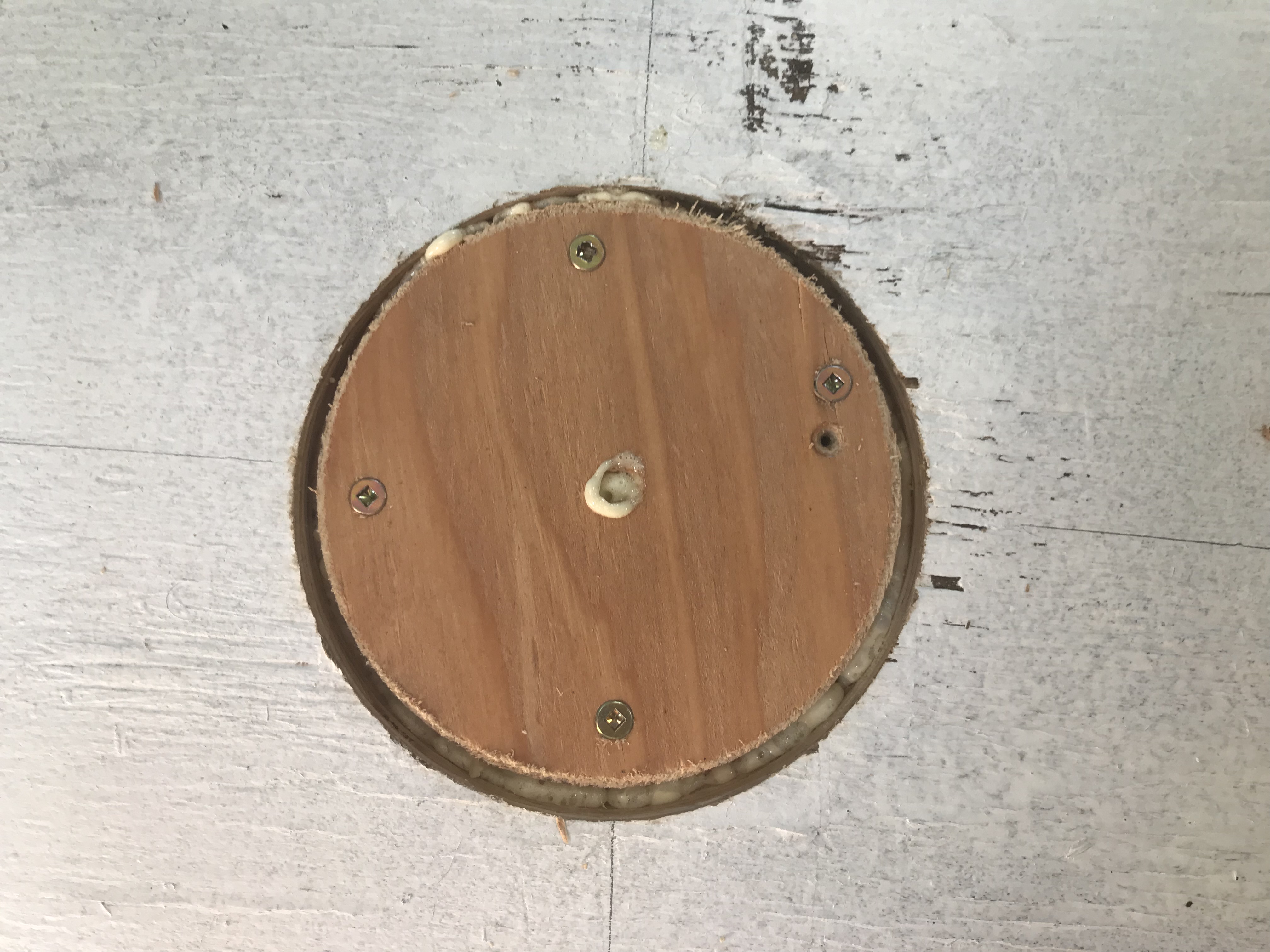

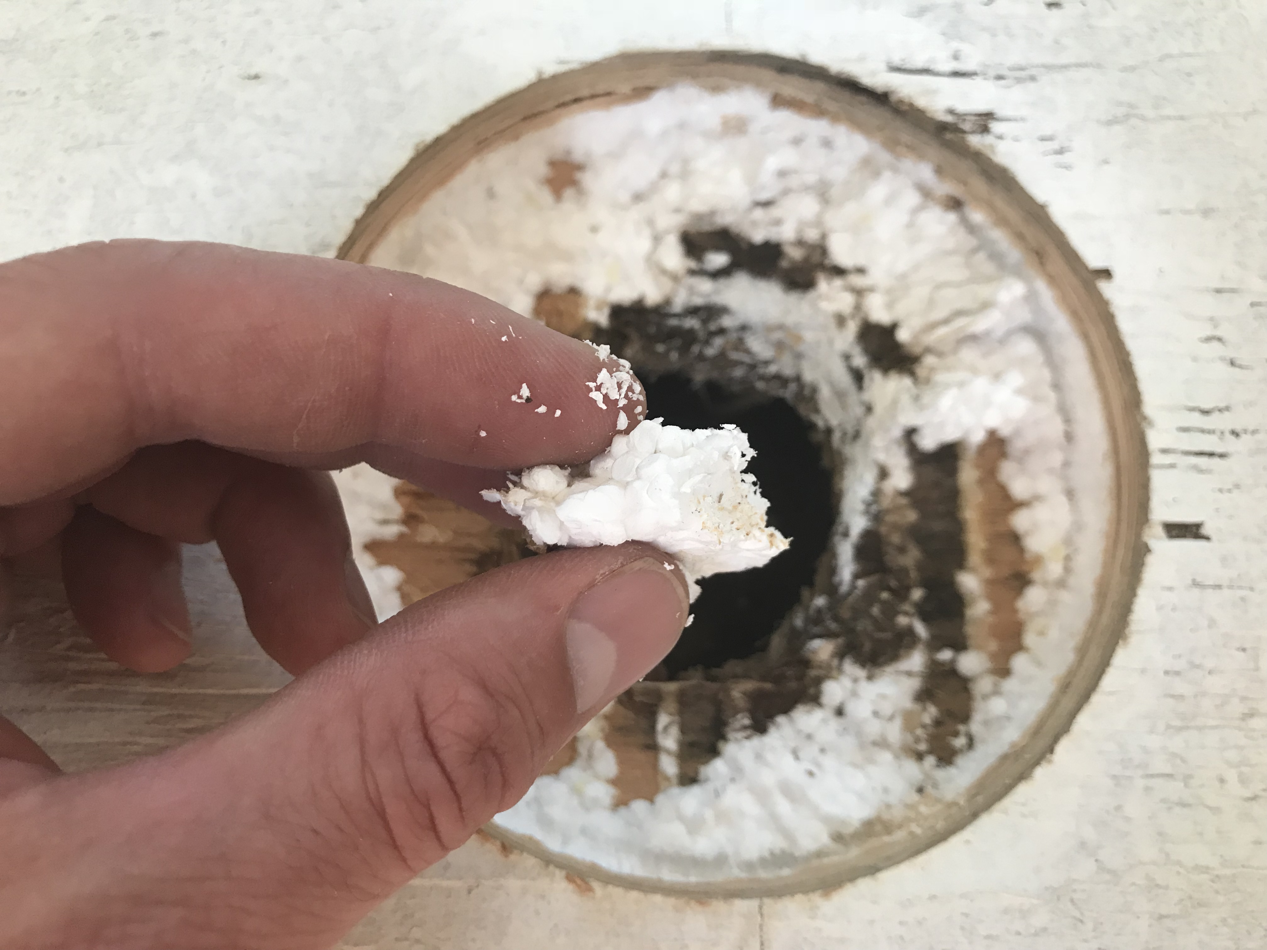

Worked on getting the floor all sealed up and primed for some paint. I’ve used great stuff foam for the varied wire/propane holes.
I patched a larger hole by cutting out the top layer of flooring plywood with a large hole saw. I then cut a new disc of 1/2” foam and 1/2” ply. I glued them in with wood glue and expanding foam and added some screws to hold it all flush. I was surprised to find that parts of the floor are an ice cream sandwich glued up with plywood and styrofoam.

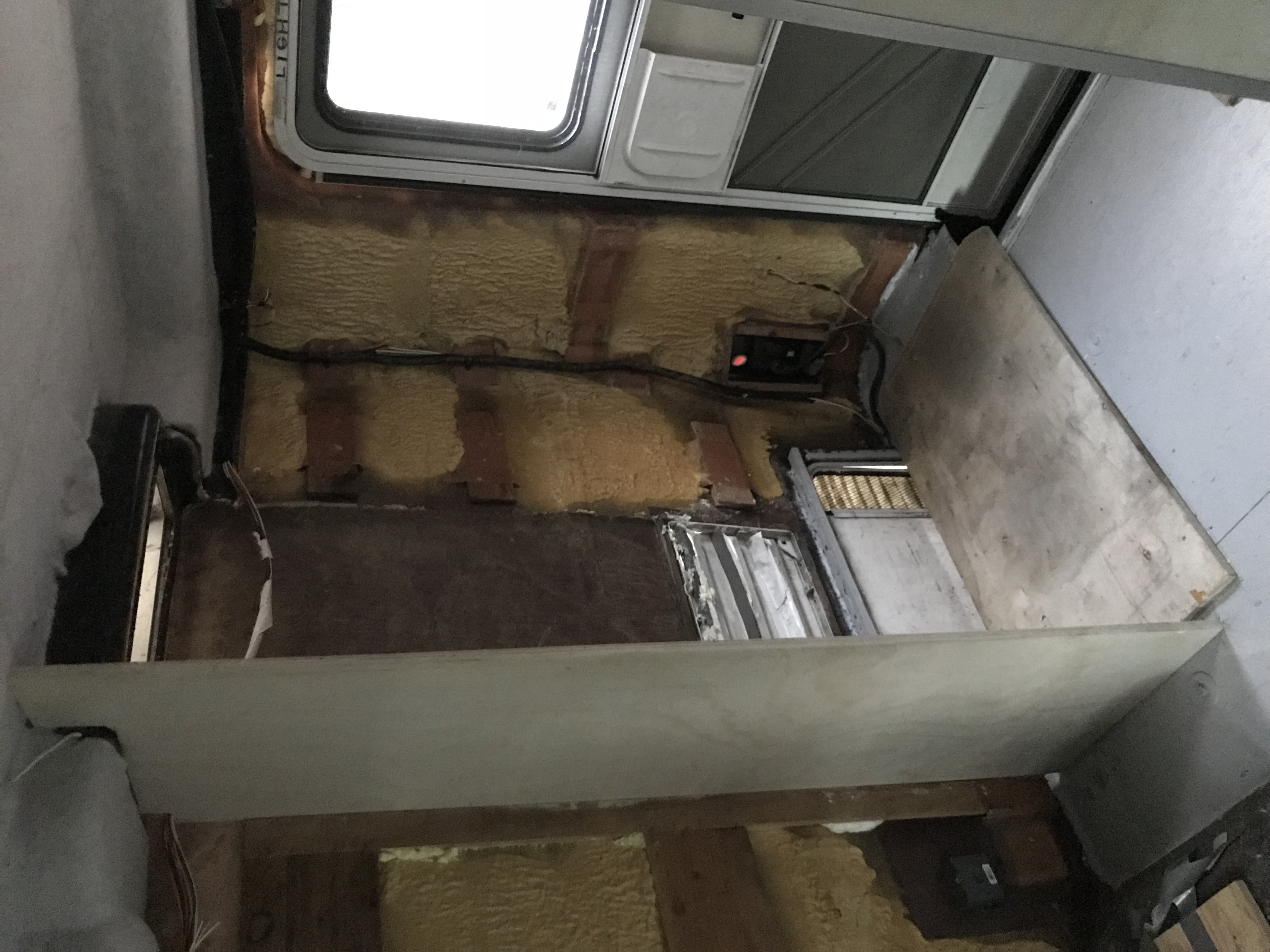

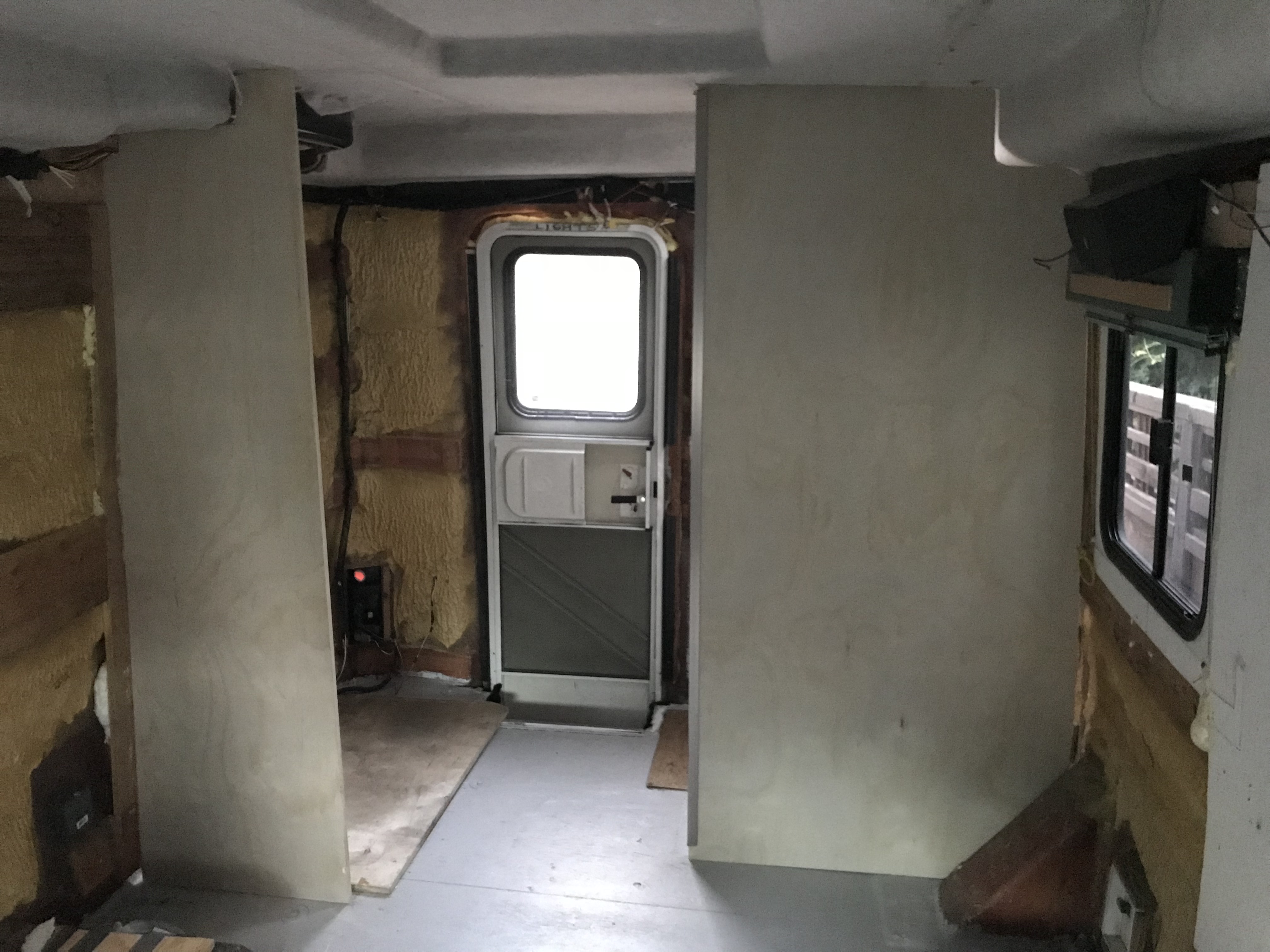

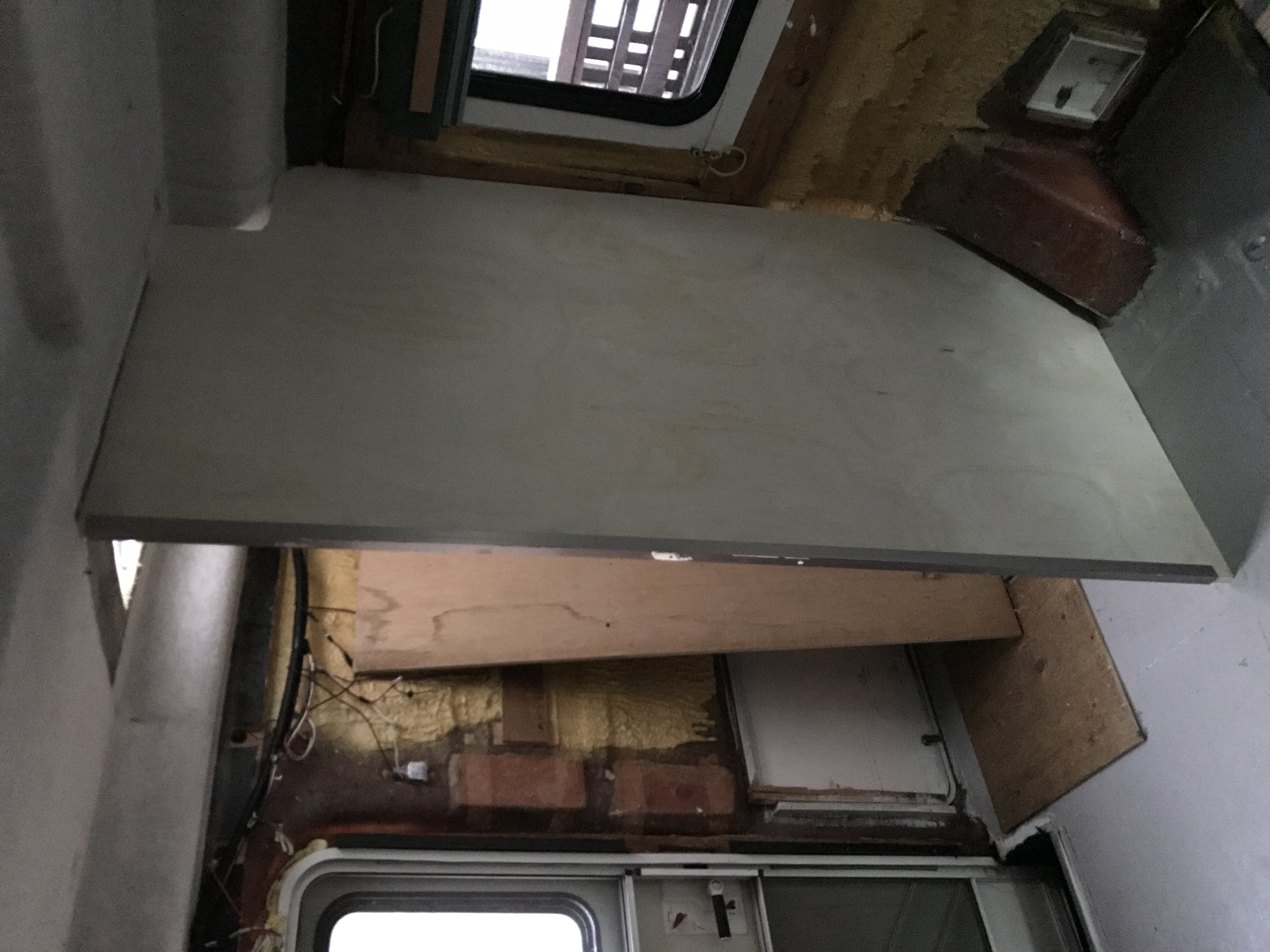

Well, I finally got some nice 3/4” plywood and spent the time to figure out the profiles for the left and right bulkheads. Took a lot of back and forth, but managed to get both sides close enough on the first jigsaw cut.
Real nice how they firm up the walls just wedged in place. It’ll get a lot better once they’re attached and more cabinets/walls/etc. are tied into them.
I went ~20” wide at the base on the passenger side, and ~36” wide on the drivers side. Both were about 75” tall. I needed two 4x8’ sheets of ply.
NOTHING is square in here! Even the whole floor is tilted forwards with no weight in the back. I’m using a big rectangle of plywood on the floor as a builders square for fore/aft. Then using the seams in the floor plywood to get square. And finally a regular level for left/right vertical. Tricky figuring out how to place these bulkheads.
