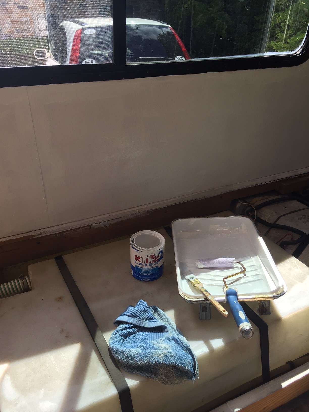

I have a question on your painted walls: You mentioned priming the luaun.... did you paint over the bare luaun or over the "wallpaper" that comes bonded to the luaun base? I ask because I have considered painting the luaun that is beneath the removable fabric on the living room walls in the Concourse (kitchen has the bonded wallpaper like the entire Premier), but the luaun is of course very porous and painting over it like that looks horrible. I was wondering about filling the grain so wondered if you had done that.

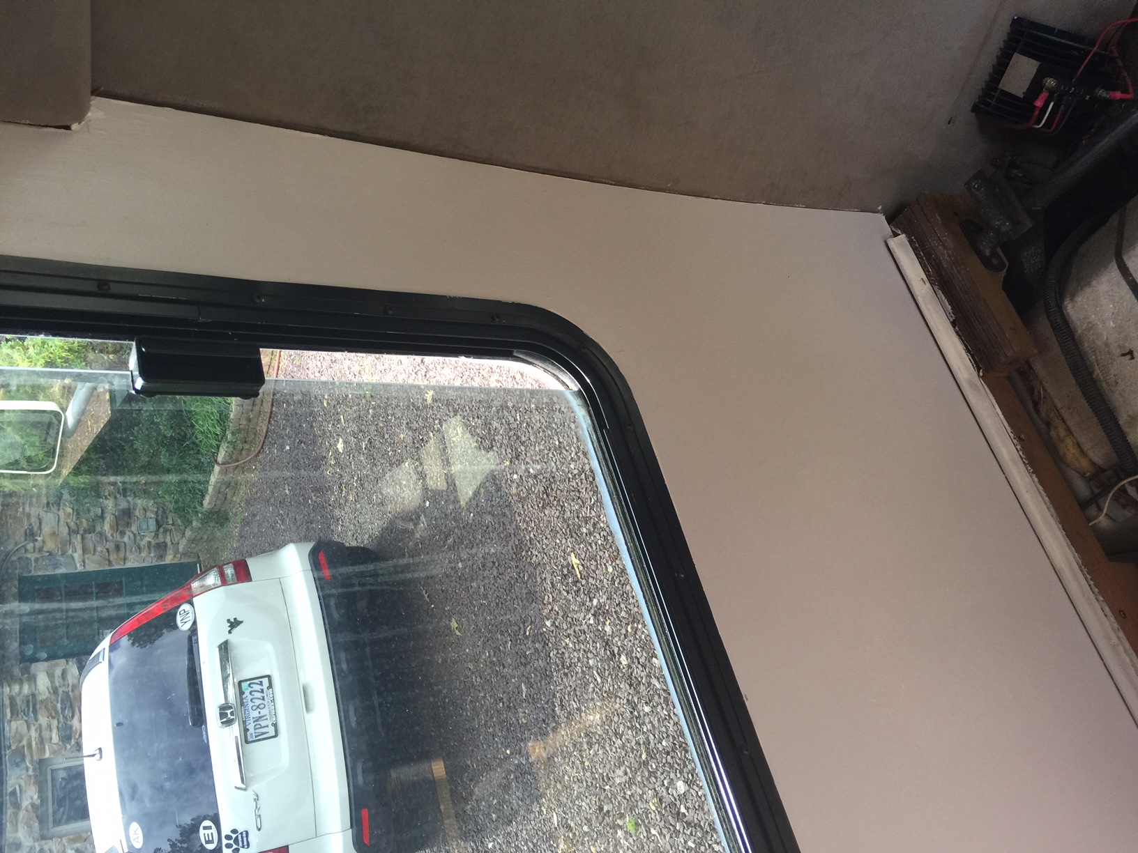

I painted both the new luan that we installed and the original wallpapered luan paneling. I wanted the walls to match. I did not paint any of the cabinets though. The new luan was fairly smooth with few noticeable grain and knots. Still, it did require 2 coats of primer. As I said, I used the latex KILZ, but oil based would probably be better if you have the time and can stand the fumes. The wallpapered walls only needed one coat of primer. Both were lightly sanded and washed after sanding to roughen up. In the two photos above, you can see how the new luan looks after one coat primer - not great. The other photo shows the finished luan - primed and painted.Blue~Go wrote: I have a question on your painted walls: You mentioned priming the luaun.... did you paint over the bare luaun or over the "wallpaper" that comes bonded to the luaun base? I ask because I have considered painting the luaun that is beneath the removable fabric on the living room walls in the Concourse (kitchen has the bonded wallpaper like the entire Premier), but the luaun is of course very porous and painting over it like that looks horrible. I was wondering about filling the grain so wondered if you had done that.
I like the painted walls so much that I am considering painting the rear hallway walls as well. This would be the fake wood laminate closet wall and bathroom wall. I think it would really open up that back area, but am still not fully convinced if the oak closet door and oak finish bathroom door would look okay against the silvery walls.

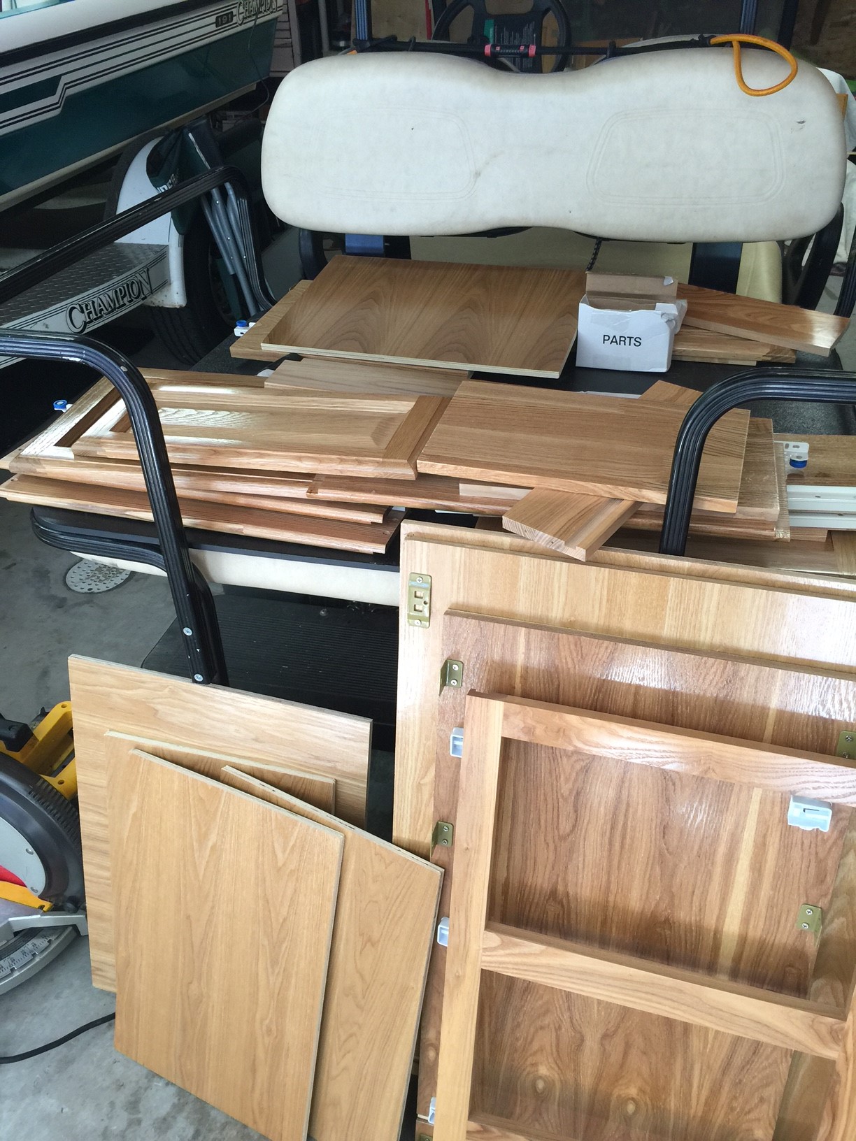

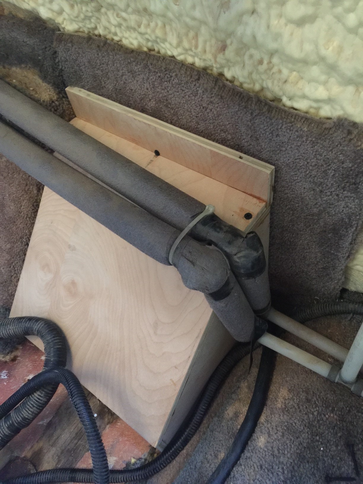

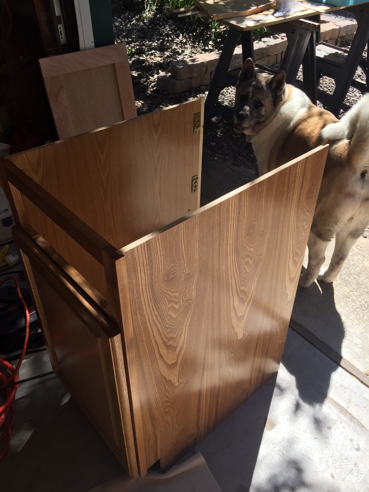

Okay, so the kitchen cabinets are actually installed! It took my husband and our carpenter friend from 11-4 on Saturday to get it done and to re-install countertop and sink - water is not hooked up yet. The cost of the two cabinets was around $280, but we had to pay $100 !! shipping. I looked and couldn't find the right configuration/sizes that I needed at Home Depot or Lowes. I ordered these online from Stock Cabinet Express.
I mentioned that I polished the sink earlier, and we removed the old silicone from the corian counter before re-installing the sink onto the counter.
I have to take pictures and will post. I wasn't out there the entire time, but I know that they had to cut and modify nearly every single piece of the two cabinets. But they look fantastic! If my husband and I did this without the help of our friend, it would have taken twice as long or three times as long I assure you! I don't doubt that we would have been able to complete it, though certainly not as efficiently as someone who oversees the building of houses everyday!
The mouse highway that was only partially covered by the old cabinet configuration is fully enclosed as well.
In the attached pictures, you can see the unassembled kitchen cabinet pieces too. Unassembled is the way to go if you have to do as many mods as we had to make in order to get them to fit and structurally sound.
