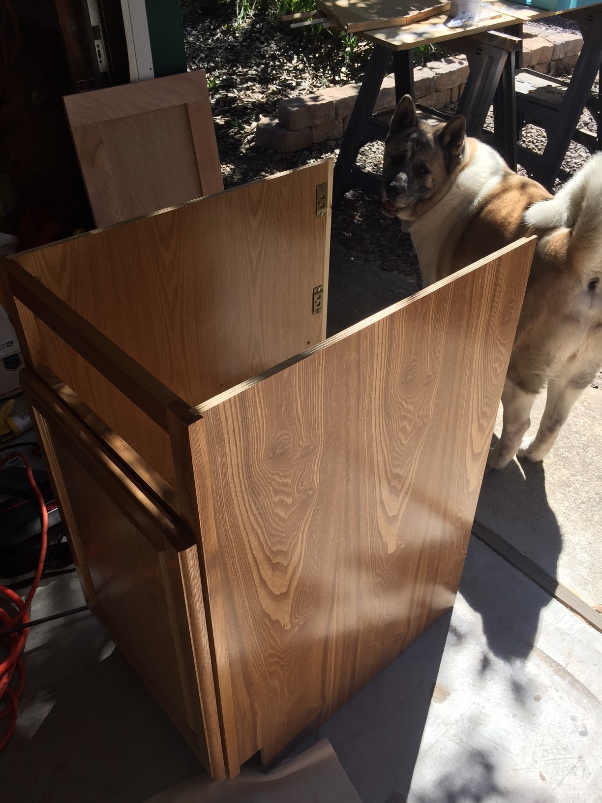

Okay, so the kitchen cabinets are actually installed! It took my husband and our carpenter friend from 11-4 on Saturday to get it done and to re-install countertop and sink - water is not hooked up yet. The cost of the two cabinets was around $280, but we had to pay $100 !! shipping. I looked and couldn't find the right configuration/sizes that I needed at Home Depot or Lowes. I ordered these online from Stock Cabinet Express.
I mentioned that I polished the sink earlier, and we removed the old silicone from the corian counter before re-installing the sink onto the counter.
I have to take pictures and will post. I wasn't out there the entire time, but I know that they had to cut and modify nearly every single piece of the two cabinets. But they look fantastic! If my husband and I did this without the help of our friend, it would have taken twice as long or three times as long I assure you! I don't doubt that we would have been able to complete it, though certainly not as efficiently as someone who oversees the building of houses everyday!
The mouse highway that was only partially covered by the old cabinet configuration is fully enclosed as well.
In the attached pictures, you can see the unassembled kitchen cabinet pieces too. Unassembled is the way to go if you have to do as many mods as we had to make in order to get them to fit and structurally sound.
A lot of pieces!  mostly for the drawer cabinet.
Partially assembled just to get a feel for where the cuts would be.
