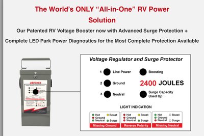

Would like to again throw in a good word for the Hughes Autoformer, now with surge protector and wiring diagnostics.
https://www.amazon.com/Hughes-Autoforme ... B06W55ZKB6
Hughes Autoformer
Hughes Autoformer
An autoformer is a transformer with multiple taps, that boosts the voltage if it goes low enough (below about 105) to harm appliances like the roof aur conditioner. Very helpful in parks that brownout with too many users, or even on a home 20A line like my remote garage.
When my roof AC compressor kicks in, I can sometimes watch the incoming voltage drop from 120 down to 105 for a split second before the autoformer kicks in and boosts it back to around 113-115, safely above motor killing level. (It used to stay at 105.)
I’m sure it will add to the AC’s longevity. I got the autoformer after blowing the start caps last summer. Starts and runs much smoother now. Higher voltage makes it draw fewer amps as well.
Although usually placed (under a bucket in rain) between the power pedestal and RV, many people permanently install theirs internally. That’s what I plan to do too.

Kev, I'll have to take a look at the Autoformer, sounds interesting.

kdarling: The Autoformer is still on my list, but I have concerns with using rain buckets and remote viewing of diagnostics. Wasn't aware it could be installed internally (hardwired?).
I did see where the Autoformer can be used in line with the PI EMS surge protector to protect it (pedestal–EMS–Autoformer–RV).
Bob: Thanks for the heads-up about not be able to close the compartment door. That is a concern for me.
updated edit:
Found this on another forum...
"Hughes tells you in their documentation that hard wiring is not allowed and they will void the warranty if you open one up to do so.
The installation instructions also tell you that they can only be installed in well ventilated outside compartments which really don't exist on most motorhomes.
Other members have had the internally installed Autoformer overheat when the fail safes failed so I am going by those first hand accounts from the past about overheating".

kdarling, regarding the fact that the compressor draws lower amp with the autotransformer... it is definitely why it is better for the compressor, but it is not going to save you any electricity. The autotransformer will draw a higher current that it puts out as it increase the voltage.
Re: Hardwired surge protector
Posted: February 22nd, 2018, 4:31 pm
by kdarling
Yep, I know it doesn’t save electricity, but it does save my roof AC :)
As for interior installation, well a coupla things. First, I bought my autoformer used off eBay for about $200. Well worth it and I’m not worried about warranty.
However, I don’t plan to open it either. Instead, I’m simply going to put it in the shore power cord storage bay. I’m also going to cut the stock power cord and separate it into a plug and socket combo... a long pedestal cord, and a short coach side.
That way if I wish, the autoformer can plug into the long pedestal cord, amd then the coach can plug into the autoformer.
OR the coach can plug directly into the long pedestal cord and bypass the autoformer if I ever remove it.
