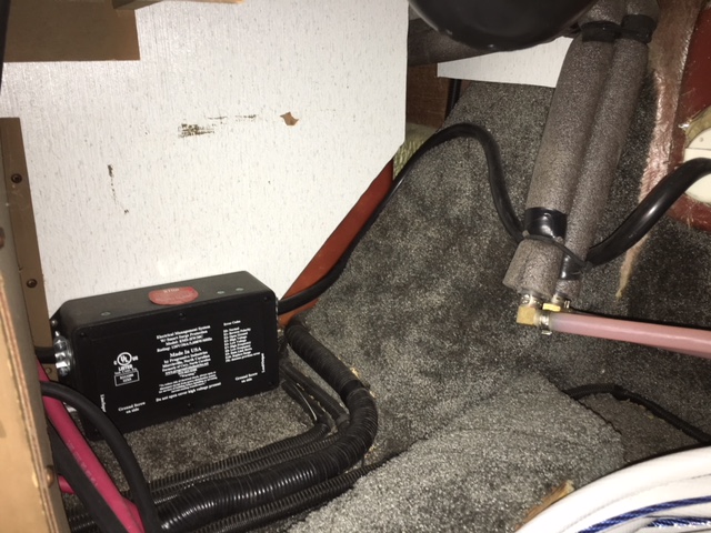

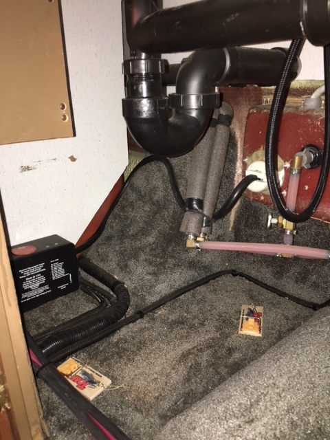

Here's a couple of pictures under my sink. The first shows the far-away view. I removed all the walls and dividers under there my first winter and never replaced them (I keep under the sink clear in the winter so I can aim a fan/heater under there, to get warmer air flowing behind the shower to keep the pipes from freezing).
Like BG's 1999 Concourse, mine had the shore power cable attached, and you just pulled it out from the outside when you wanted it, and the stuffed it back in through the slot when you were leaving, and it would 'self-roll' under the sink, behind the thin walls/dividers. But as you might be able to see in the photo, my pipes under the sink were pulled away from the wall and slanted - that was before I got it, when it was probably cold and the cable was stiff, or it wrapped around a pipe a bit. Seeing that the first time I opened those dividers made me decide to cut the cable and replace it with an outlet on the outside that I now just plug the free-cable into (same cable, just cut it and added a plug on the end).
Bob

Thanks!!!...to Blue~Go and Bob for the great pic references and details!
