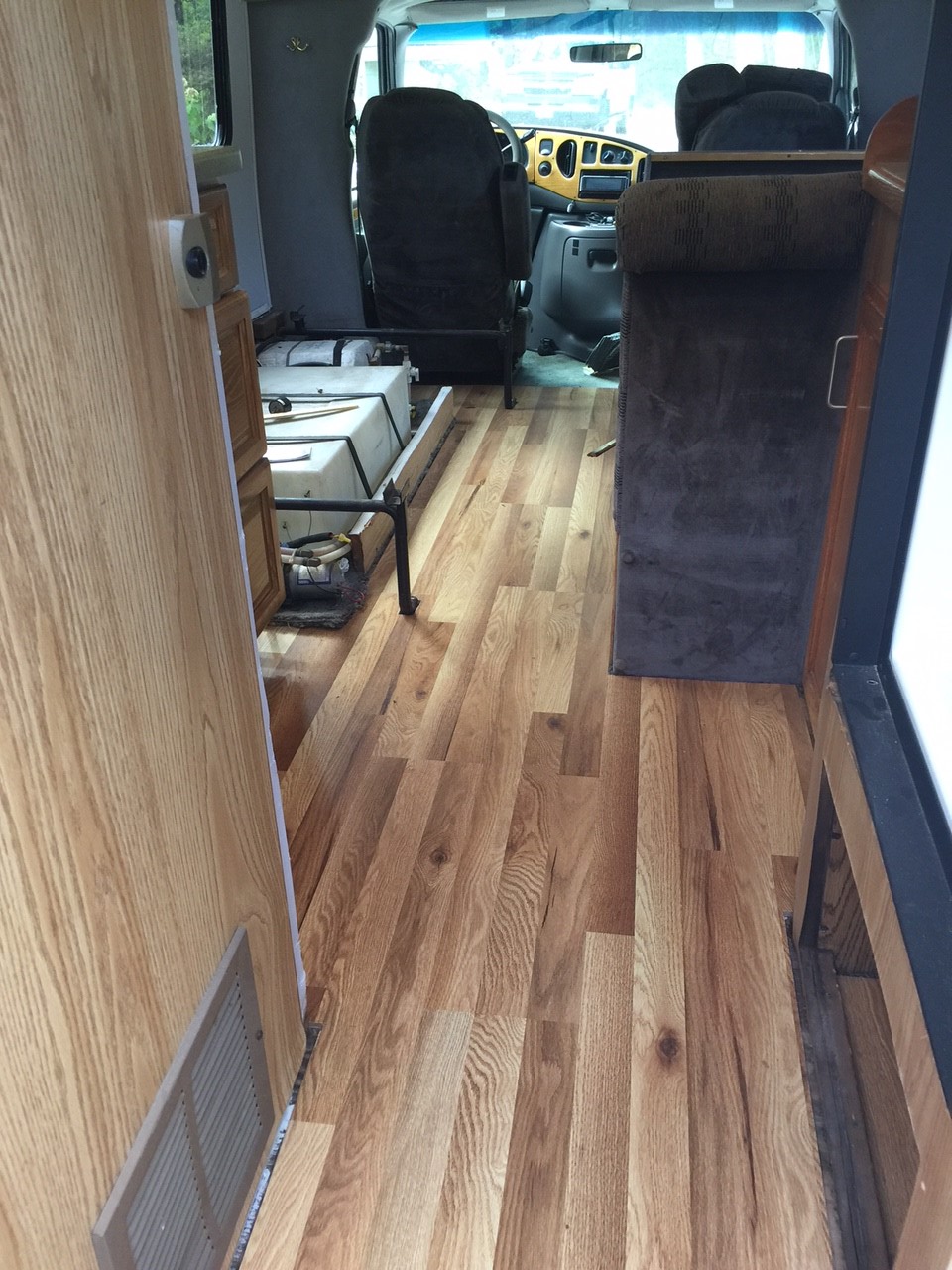

We have Pergo laminate in our basement kitchen and we just finished installing Pergo laminate in the Premiere. We know it is not totally waterproof, but, short of a flood, they can withstand some small spills if wiped up quickly. We did have a flood in our basement, and the Pergo did indeed swell, but most of it also went back to nearly normal after a few months - not perfect though for sure. It goes down very easily, just click and lock. The previous owner of our fifth wheel also installed Pergo throughout the living and kitchen area, and it looks great and has held up very well. I've spilled more than a few things on it, including dog water bowls, but I have also cleaned up the spills quickly. No noticeable damage that I can see.

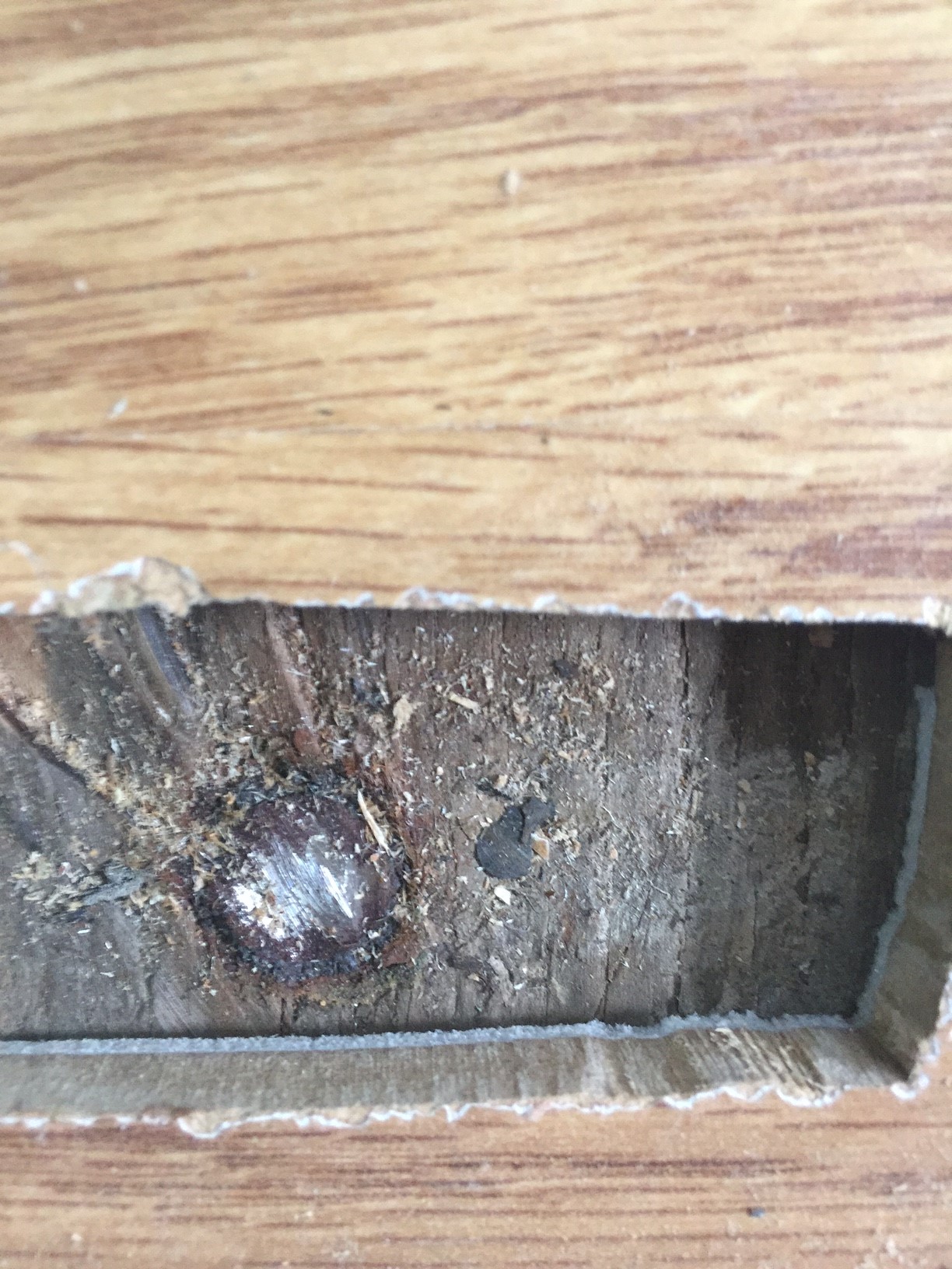

When we removed the carpet from the Premiere, my husband initially wanted to lay a new subfloor, but he later decided against it because he was afraid that the floor would then be too high for the lower floor cabinet hinges (under dinette and fridge area) to function correctly. So, he took a grinder and ground off the part of the bolts protruding from the couch bracket and then cut around. Because we have to bolt the couch bracket back in place, his plan is to simply install a new bolt next to the old bolt - there is enough "wiggle room" in the bracket to do this. For the other bolts, he chiseled out the back side of the Pergo planks with a 1 1/4" round drill bit, not all the way through, just enough to clear the bolts.Colorider wrote: Because of protruding bolt heads, less-than-stellar plywood, holes, seams, humps and other issues, I was forced to install a new subfloor on top of the old one. I used 3/8" particle board made for underlayment. I'm going to seal it with latex Kilz to keep water from puffing it up. Once sealed, my life will get much easier since I can then install just about any floor that I want.
