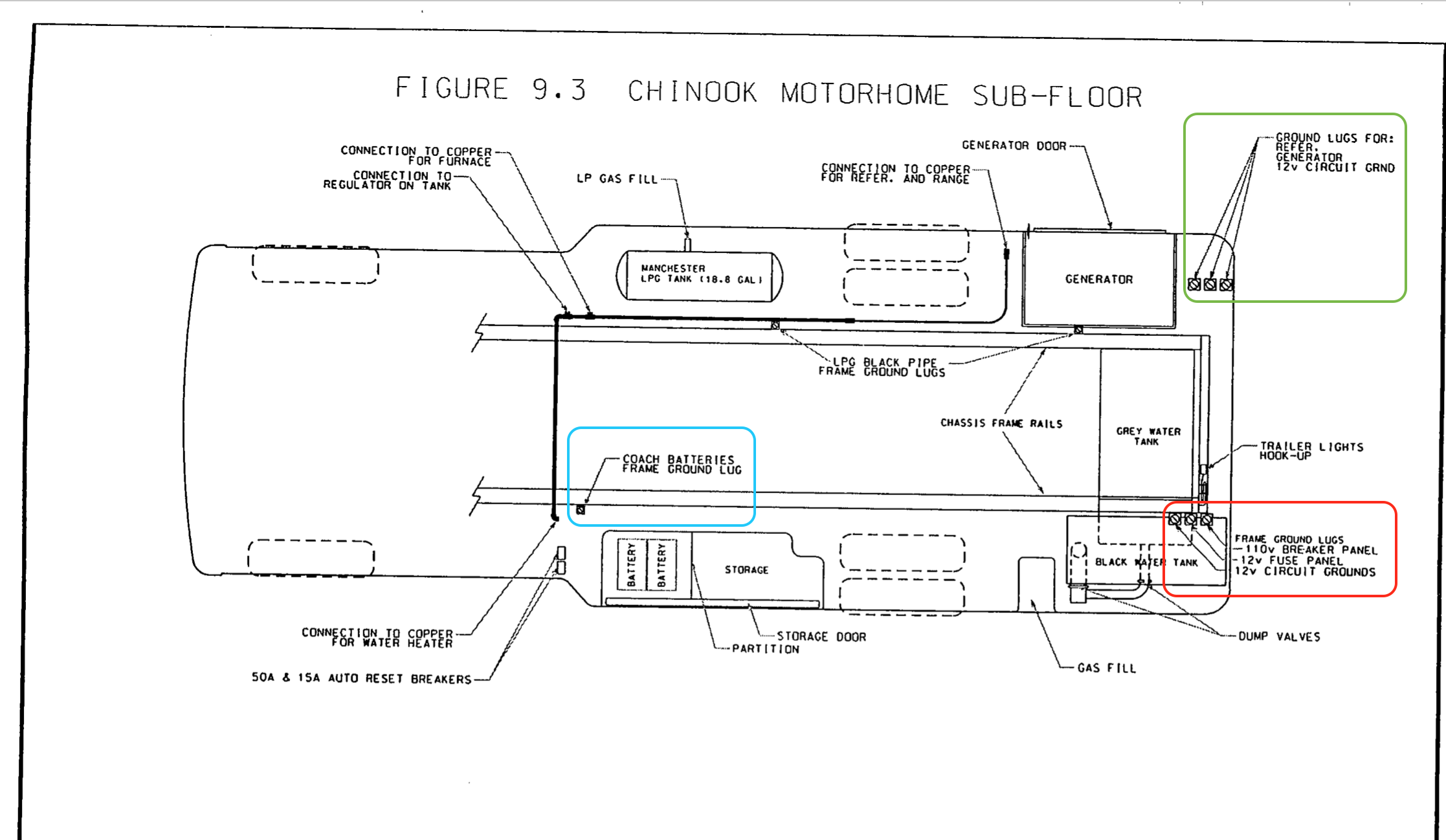

Yes, that is the white wire I am referring to - it connects to chassis somewhere, but I haven't found the pathway yet.
The only substantial negative wire in the battery drawer (except a small accessory one) goes straight to chassis, not up into the coach, it's independent, and easily replaceable - but this one doesn't go to the DC panel directly, based on visual inspection.
I am on the fence about disconnecting the old white wire in the DC panel, as the new run to battery, behind the couch, will replace it - but I may leave it connected in case there's something else that uses it, behind the walls, if that all makes sense.

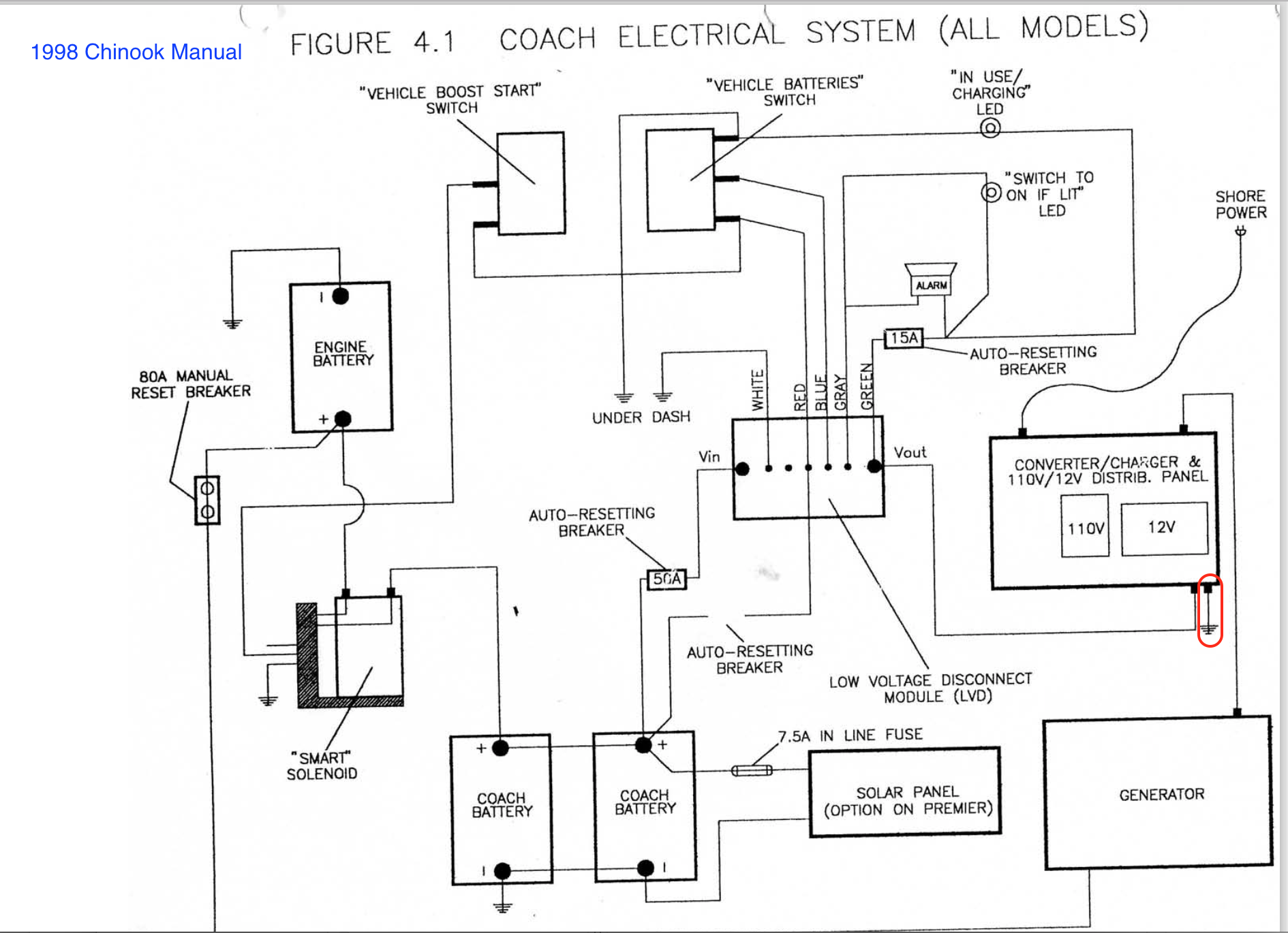

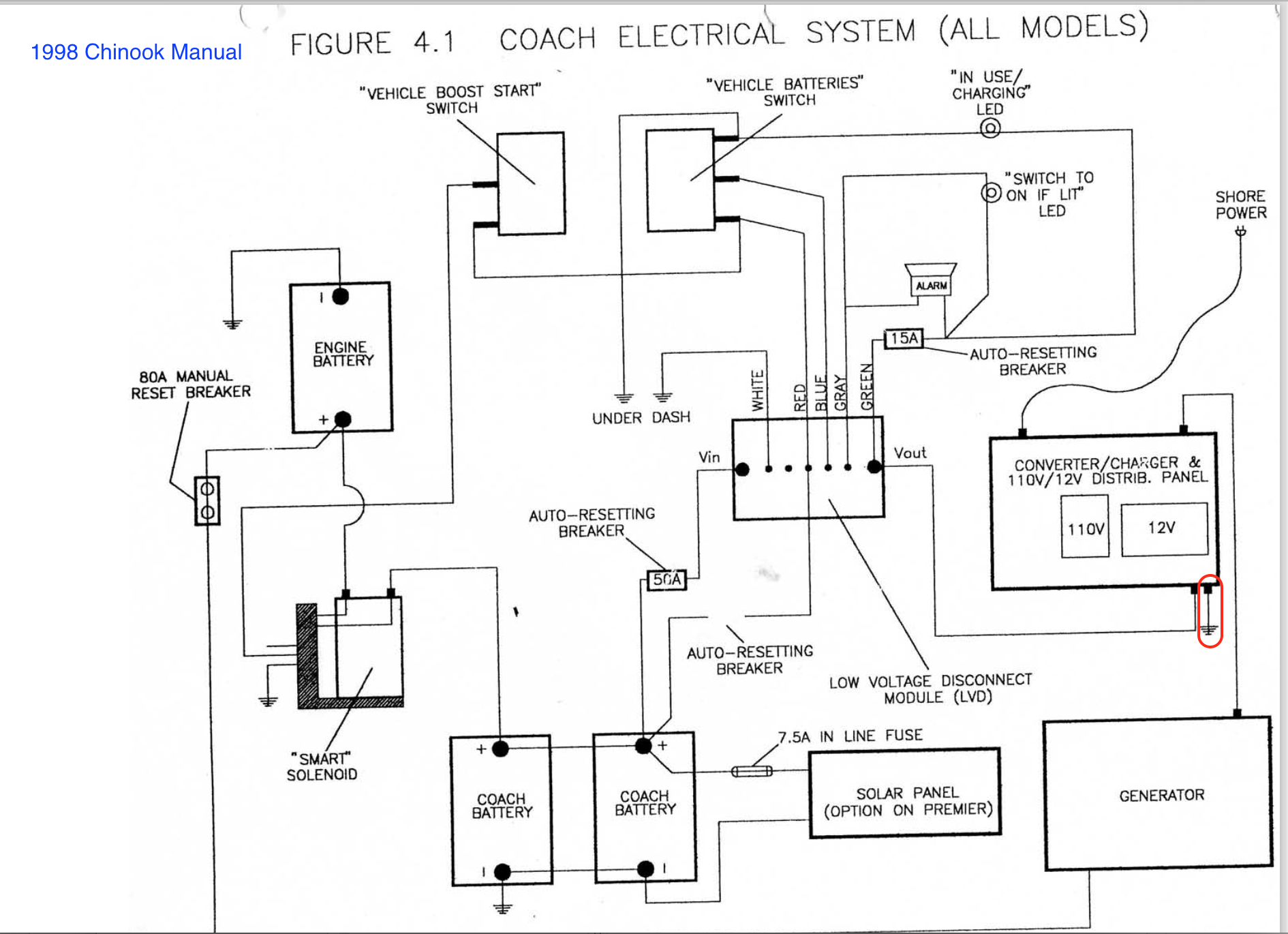

I believe that runs to the frame in the rear driver's side. I circled it in red in this excerpt from the 1999 manual. Chinook ground wires have all been white in mine (except certain purchased components that had other colors in their own pigtail).Rhythmtone wrote: February 9th, 2025, 12:34 pm Yes, that is the white wire I am referring to - it somehow makes it to negative terminal, but I haven't found the pathway yet
Usually you can click to enlarge:
There kind of is no "after" in the negative circuit. I mean, it's all one common ground. You do still have to have a full circuit, somehow, for each size of wire, but there is no "after" to my mind.Rhythmtone wrote: February 9th, 2025, 12:34 pm- I can upgrade battery drawer negative to chassis ground wire easily, which seems to be "after" all of these DC runs
I would leave it in place and just add another/beefier one from the house negative post/busbar to the frame.Rhythmtone wrote: February 9th, 2025, 12:34 pm - I am on the fence about disconnecting this old white wire, as the new run to battery will replace it - but may leave it connected in case there's something else that uses it behind the walls, if that all makes sense.

Okay, so stepping back a little, any device has a "loop" or circuit. So let's take a TV up in the overcab for example. Here is the path:Rhythmtone wrote: February 10th, 2025, 1:36 am But NOW, going the other way, powering DC loads, I'm now debating whether is it necessary or prudent to also run new DC wire back to the panel with this layout - it seems that I will be limited by the size and length of the existing WHITE wire at the DC panel (if it's in use), and/or the size/length of any small ground wires at the loads, let's say the fridge or a DC TV, for example. I could upgrade the wire size from battery to panel, and it would be shorter, both things provide better voltage at the panel, but I'm not sure how much this will matter, especially if few or zero loads are grouned to the panel.
--House battery positive post
--Looooong skinny positive wire to DC distribution in brown box (fuse panel)
--12AWG orange wire that runs (ha ha, back along the SAME path) through the wire chase above the driver's side cabinets up to the overcab
-- TV ITSELF
-- white negative wire that runs back through the driver's side overhead cabinets and eventually down to the frame rail sort of under the shower (at some point a number of small white wires join up).
-- "through" frame rail up toward battery bank
-- thence through the negative jumper from frame to battery negative post
So does the negative path take a side jaunt up through the white wire to the brown box? It has no reason to. In fact, why is that 8AWG negative jumper even there? (Between the brown box and the frame.) I believe that's only the charger's (PDXXXX) negative return. I mean, you don't need to rip it out, but I don't believe it carries any circuit grounds. Negatives in general don't have any reason to return to a positive fuse block. They just need to get back to the battery negative to complete a circuit.
This is why I upgraded (size) the negative jumper from the house negative battery/bus bar to the frame. It's really ultimately carrying all negative loads.
Have a look at this diagram showing all the chassis grounds (from the 2000 manual but my early 1999 is exactly the same): Click on it to make it larger and more focussed.
Teal colored box:
-- that's the main jumper from the frame to the house battery negative.
Red box:
--110v chassis ground (I forget what this looked like on the brown box end so suss this out. It may be bare copper? At any rate as long as you are not changing the brown box ground wires -- and I don't see that you need to -- it should be fine)
--the 12v fuse panel ground (I believe this is the white 8AWG you see on the front)
--the 12 volt circuit grounds (basically all the driver's side Chinook loads come along the upper cabinets then go down the rear corner and end up here)
Green box:
-- Refrigerator chassis ground (8AWG)
-- Generator chassis ground (I think this is 6AWG)
-- 12 volt circuit grounds (like in the red box above, but this is all the passenger side loads that run along the upper wire chase, down the corner of the closet, and to the frame)
See above, but I don't believe they do. I think it's only the charger in the DC circuit. That said, you can just leave that wire there, as it's not like a positive wire where you don't want to leave any extra "live" wires danging around. (If it were like that, your whole frame would be dangerous.)Rhythmtone wrote: February 10th, 2025, 1:36 amTo clarify, if any of the DC loads DO use the white wire at the DC panel, I'll be limited by gauge and length from panel to the load, because I'm not replacing that.
Right, so as you can see above, all the Chinook loads have their own ground wires that go directly to the frame (some of them combine a bit before they go to the frame - in the rear corners on each side). So the important wire to enlarge is the jumper that goes from the negative house battery to the frame (luckily that's an easy one).Rhythmtone wrote: February 10th, 2025, 1:36 amIf they DON'T use the white wire at the DC panel, then I'll be limited by whatever small ground that they do use, elsewhere in the coach. I see why moving the battery and/or running a new DC pair makes sense in theory, but I thought that all loads got negative from the DC panel, which was wrong.
The only other time you would have to think about this is if you were adding NEW positive wires to NEW loads. Then you need to think about hmm but my chassis ground wires are still only the same size as original. What I do is I just don't add any new chassis grounds. Anything new that I run has a positive/negative wire pair, and that negative wire goes right to the negative bus at the house batteries.
Exception would be if, say, I used the original 8AWG refrigerator power wire. I'm not using that for the refrigerator anymore, but I left it over there to possibly use for a new item. No real need to do that on the driver's side, but it's pretty difficult to get wires around the back of the shower and over to the passenger side. So, if I reused that wire for something else, I could also re-use that 8AWG white wire that goes to the refrigerator chassis ground, because Chinook already has that "pair" in place.
So to summarize:
**New charger's AC wires (or the wires to the receptacle you are going to plug the charter into) go to AC section of brown box, to "charger" breaker and other appropriate ground busses (copy existing charger wires).
**You can leave the brown box chassis ground wires in place.
** Enlarge the chassis ground wire that goes from the house negative battery post (or actually this would go to the incoming side of the BMV's shunt, marked "load.") to the frame.
Make sense?
