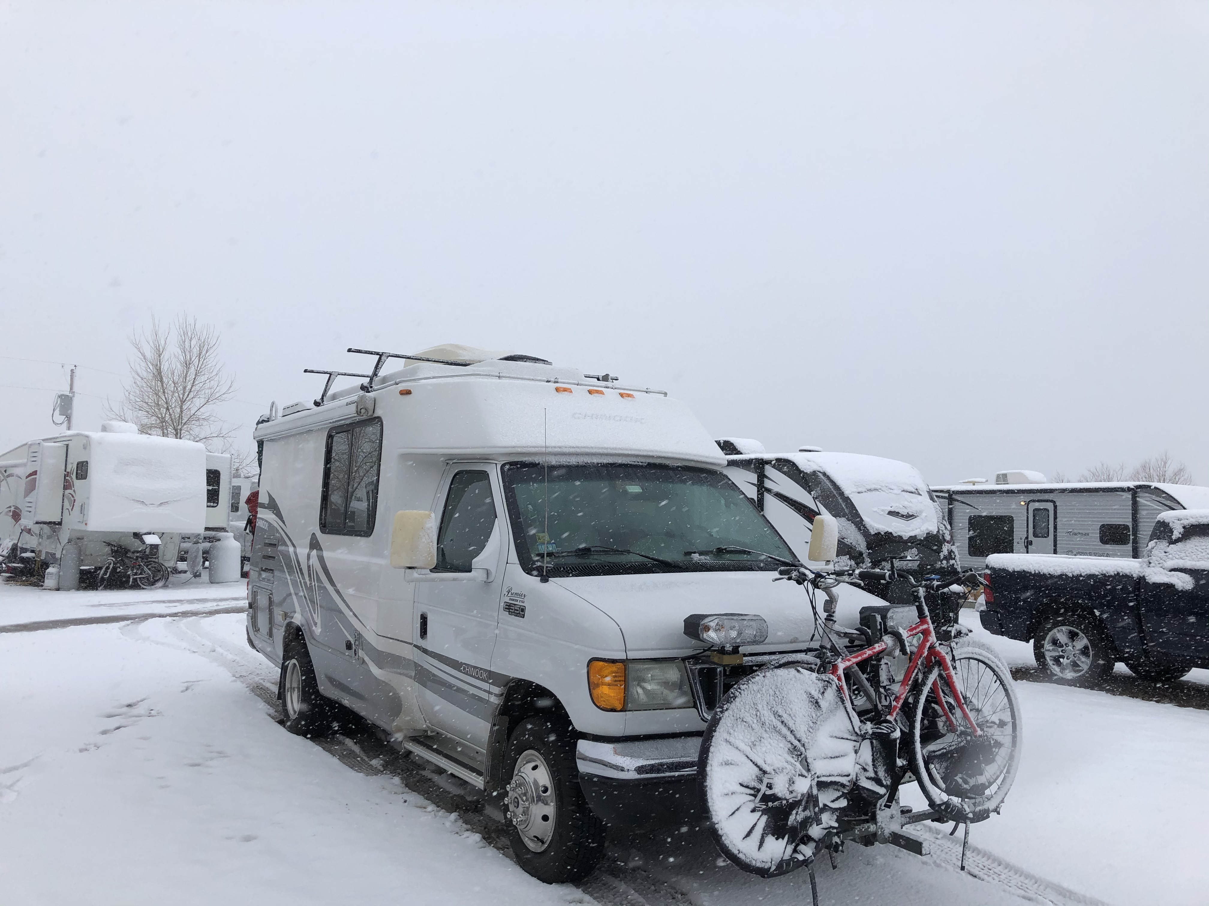

The Rig was terrific...I had replaced the water pump (original was still working, but seemed to have a slight diaphragm leak) and purchased two new Group 31 deep cycle batteries (old ones were beginning to not hold full charge) before setting out. The only issue we had was on the last night in Wyoming...we hit a snow storm, so sought refuge in a funky RV park that had electrical--which worked for a while (we used it to run our small electrical heater which is quieter than the regular RV furnace, with the added advantage of not drawing down battery power)...until the GFI outlet near the back door tripped and would not reset. Got through the night in good order by using the furnace a couple of times (thank goodness we had those new house batteries!). I checked the shore power as soon as we arrived in Longmont the next day, and all was fine...so I'm figuring/hoping it must have been something in the shore power post at the RV place. But just in case, I think I'll order the new PD converter charger you all recommend and install it before our return trip just to be safe.

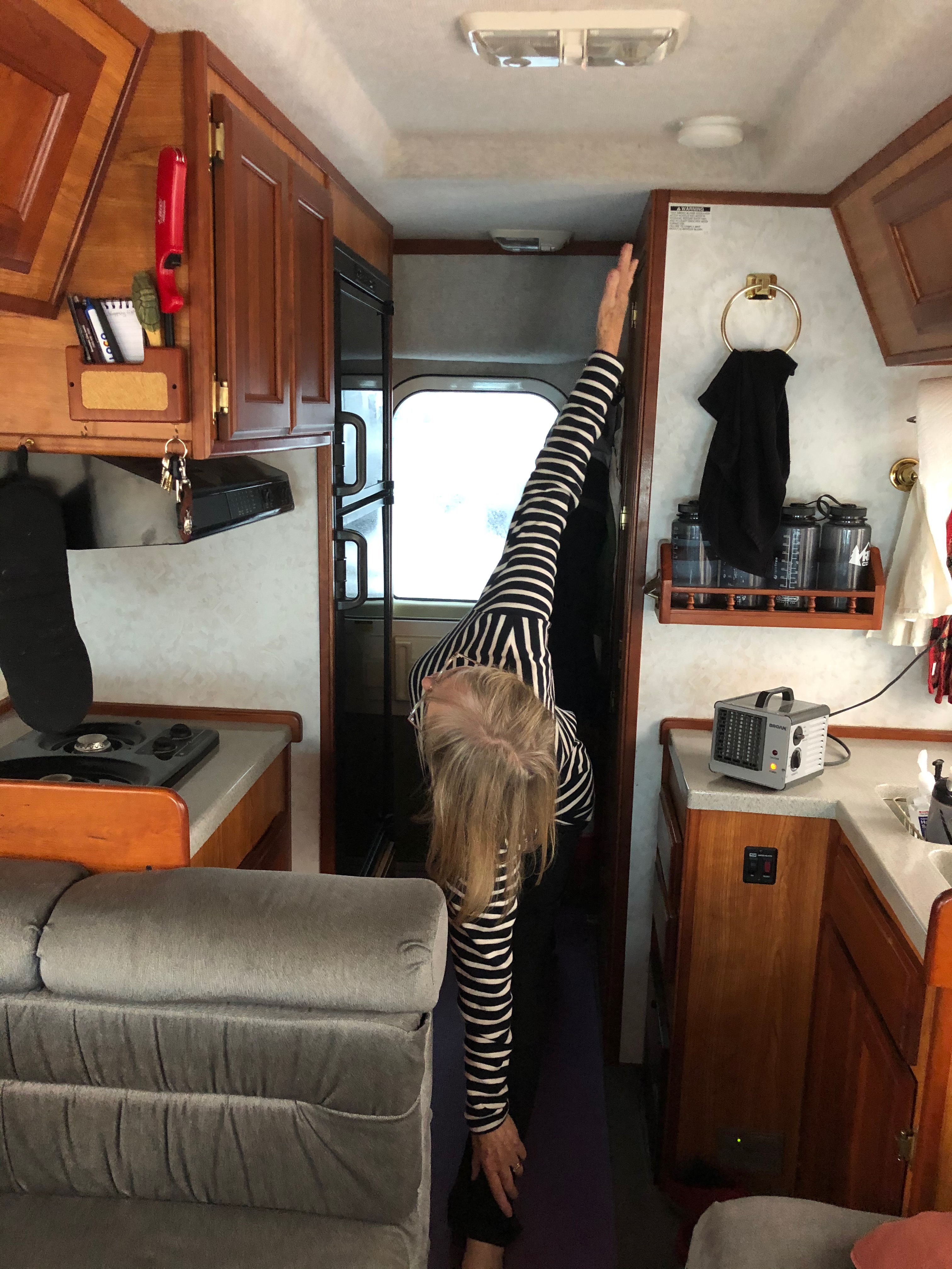

Chin_k....I should have clarified a bit more about the heater I was using when the power crapped-out in the snowstorm. I had a small portable electric heater plugged into one of the AC outlets (one near towel rack above sink). It was set on the low setting, so not drawing more than 900 watts. We pulled the microwave a long time ago...finding the space able to be put to much better use as pantry storage for our longer trips (we cook outside on fire grill at campsites, or with our camp stove on picnic table most of the time). So can't tell if microwave was affected by the AC power failure. I also did check the circuit breakers in the brown box and none of them had tripped. Does that change your analysis, or what I should be looking for? If that were to happen again, I could try plugging the portable heater into the power outlet in our "microwave panty" to see if that still has power running to it when the GFCI trips the other outlets. Maybe it was just a matter of the electric heater tripping the GFCI circuit...I have used it numerous times in past without issue, but...who knows
