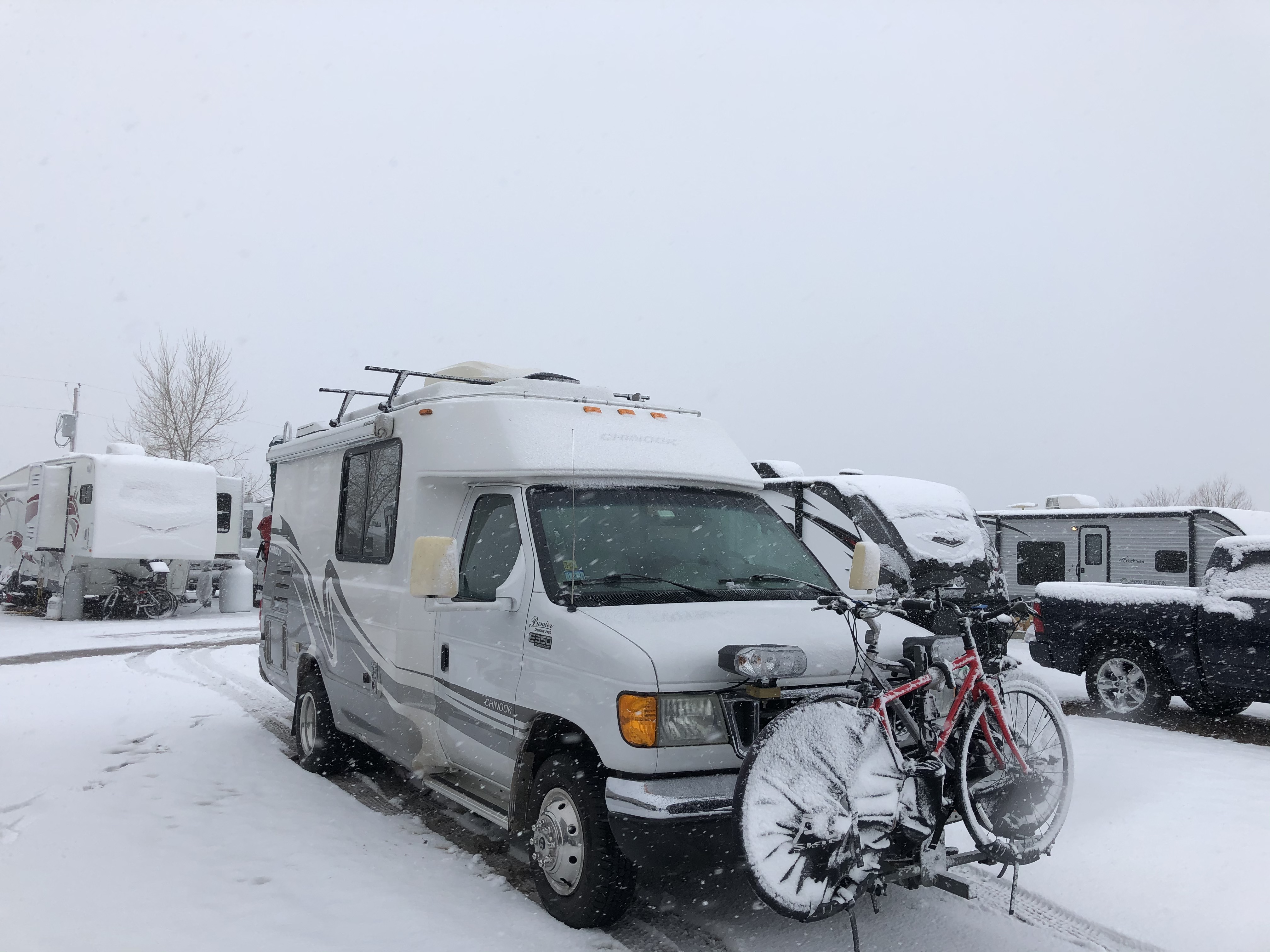

Thought I would give you all an update on our trip across the country in Turtle (2004 Premier) during this Life of Covid19. We left Boston on Sunday 3/22, headed for Longmont CO to be present for the birth of our first granddaughter. We didn't dawdle, nor set out to break any cross-country speed records--made it out here in six days...on the 80 for the vast majority of the time. We stayed in a combination of RV parks and State Campgrounds (in states where they were still open--one really nice ranger at West Branch State Park in Ohio took pity on us and let us stay the night despite the fact that he had been ordered to close the park just as we arrived), and one Walmart (nothin like a Walmart when you have no where else to land). The trip was a bit surreal, but uneventful for the most part. It was only us and the truckers out on the roads--literally...no passenger cars to speak of, and hardly any other Rigs. We successfully executed a plan of self-isolation the entire trip out...had our own food (no restaurants, no take-out), no motels, no bathrooms. In the State Parks we maintained the 6 ft rule of social distancing when out walking. The only real highlight of the trip was the night we spent at the Fort Kearney State Recreational Area Campground adjacent to the Platte River where we got to witness the Great Sandhill Crane Migration--450,000 cranes at one time. They stop over on their flight north (Siberia and Alaska!). We watched them return to the river at dusk, after foraging for corn in the fields all day. It was unbelievable!
The Rig was terrific...I had replaced the water pump (original was still working, but seemed to have a slight diaphragm leak) and purchased two new Group 31 deep cycle batteries (old ones were beginning to not hold full charge) before setting out. The only issue we had was on the last night in Wyoming...we hit a snow storm, so sought refuge in a funky RV park that had electrical--which worked for a while (we used it to run our small electrical heater which is quieter than the regular RV furnace, with the added advantage of not drawing down battery power)...until the GFI outlet near the back door tripped and would not reset. Got through the night in good order by using the furnace a couple of times (thank goodness we had those new house batteries!). I checked the shore power as soon as we arrived in Longmont the next day, and all was fine...so I'm figuring/hoping it must have been something in the shore power post at the RV place. But just in case, I think I'll order the new PD converter charger you all recommend and install it before our return trip just to be safe.
I've included some pics from the road for your edification and delight.
