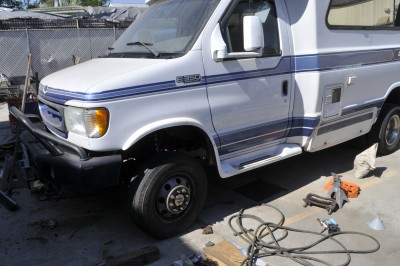

Did you complete this swap Mark? Did you have to modify the exhaust Y pipe? Which transmission is in your rig, did you have to gut it to install the new output shaft? I know on the 4R100 you have to gut the tranny to install the 4x4 output shaft. The others they claim can be changed without yanking the transmission. Did you have to change out the transmission x-member? How much lift did you opt for?

The Quigley lift is not really very much. It's probably only a couple of inches. It's not really being made with the idea of heavy offroading. It's more for snow country, or sand in Baja. I call it a gentleman's 4x4 chinook. Also dramatically reduces the chances of death wobble. If you stick with the standard Quigley geometry, you will have a better result. Big lifts create problems. However the front crossmember has to be trimmed significantly so when you hit a bump, the front axle doesn't crash into the crossmember. That is why the Quigley reinforcement brackets need to be welded in. (see pictures) The 4R100 transmission will be removed and a 4x4 output shaft and 4x4 tail shaft will be installed while the tranny is being rebuilt. They are sourced from a used F350 4x4 or can be purchased new. I have the Quigley transmission lowering brackets which lower the rear transmission mount to the correct level or you can buy this part from Ujoint offroad if he will sell it to you. The 4r100 will then be mated to an NV (new venture)271 transfer case. You can also use a Borg warner transfer case. I prefer the nv271. You will also need to carefully cut a hole for the 4x4 shifter. Then new driveshafts will be made up (shorter). Not sure yet if I will need to have the diesel exhaust modified but probably yes. I definitely had to modify the exhaust on the gasoline V10. The rear leaf springs are already installed. The chinook was ass high when I bought it. I think prior owner was towing something heavy. Currently the front end is completed. Need to pull the tranny next
