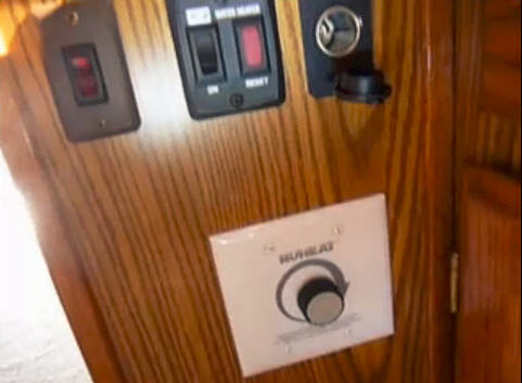

In some of the Chinook manuals they show two different electrical sketches for the Concourse. One "with Nu Heat" and one "without Nu Heat." So I would think if the breaker is there, you should have it (when new at least).
Heated floors are of course wonderful, but I'm thinking you would only be able to use them either when plugged in or with the generator running. If you are normally plugged in, then no prob.

Well that would be awesome if I had it. There's no dial to active the feature though. I wonder what I'll find when I rip up the carpet.

Manitou wrote:I recall seeing a breaker for "nu heat" the floor heating system. I've never found a switch to activate such a thing, so I assumed my rig just had the breaker
See attached pic - that's the Nuheat control knob. The Concourse's in 2004 were likely wired at the panel for a breaker but if you don't have the knob you don't have the floor. It should also be listed on the build sheet in the closet.

Yea, I don't have that
I had no idea there was a build sheet in the closet. Thanks for that. (Always had at least 1 shirt hanging up covering that back left wall.
