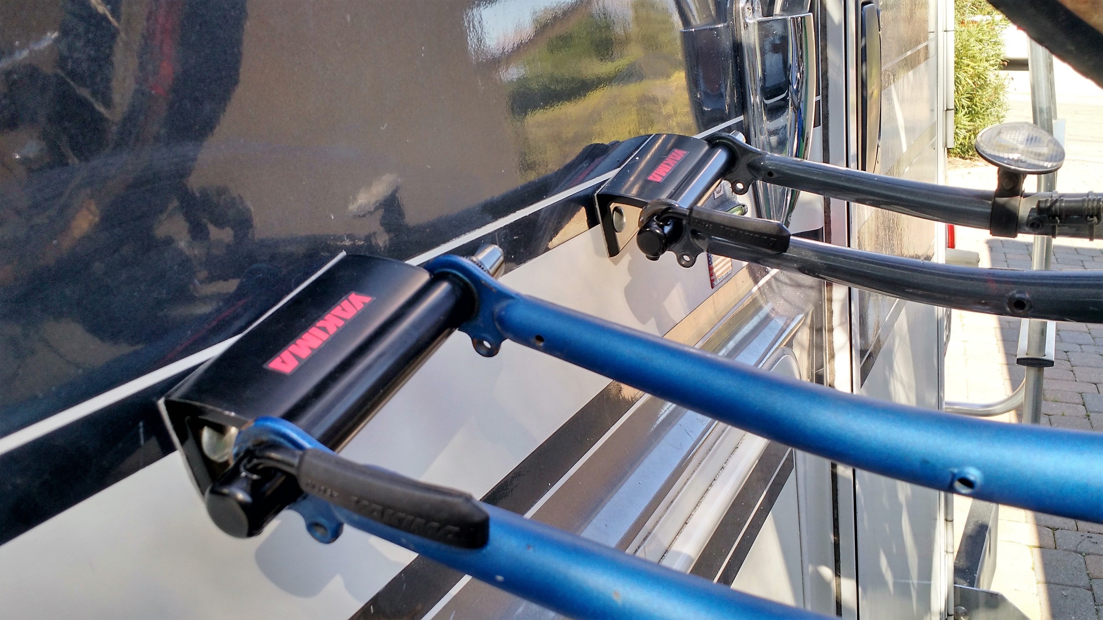

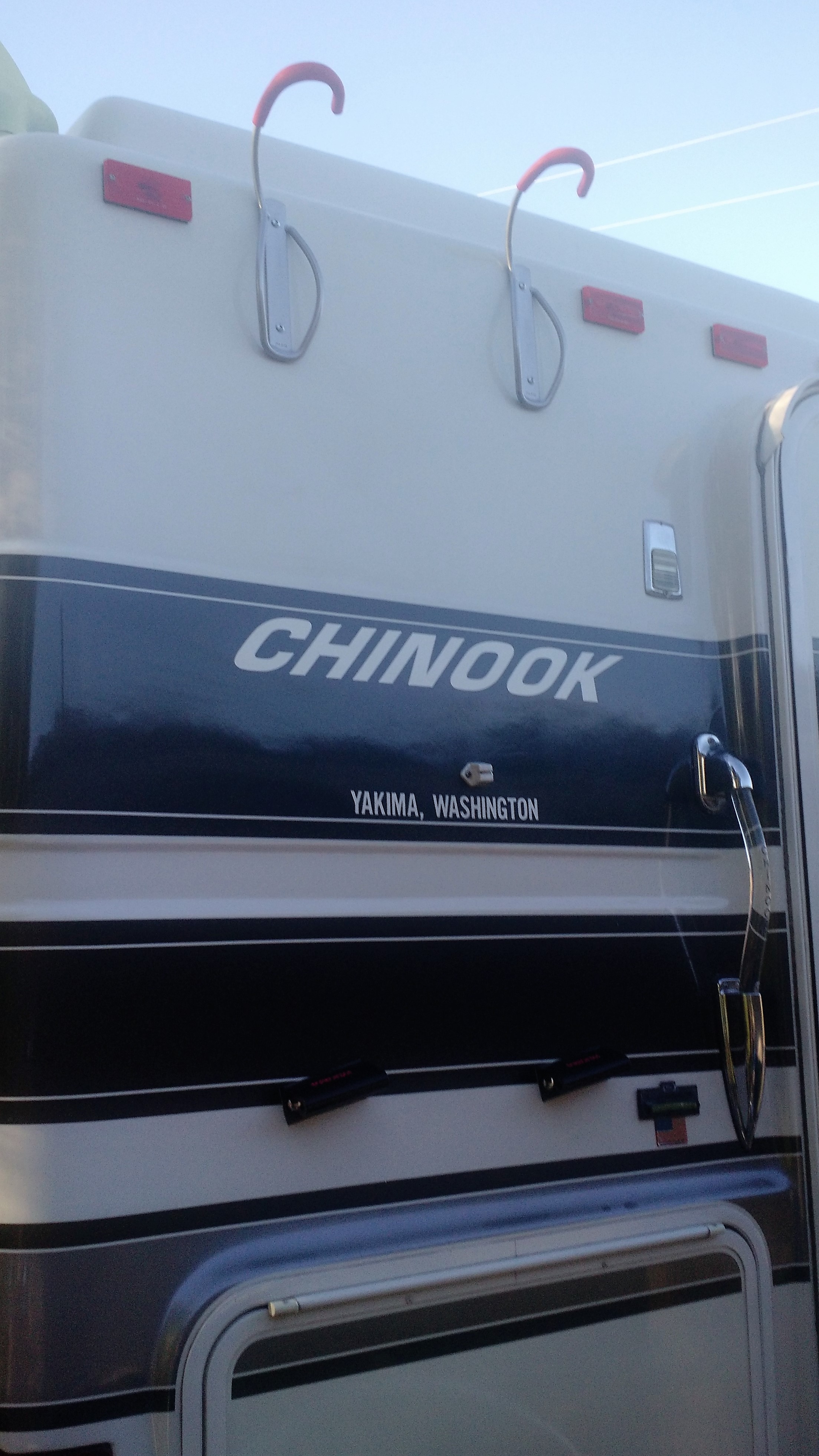

This is where we carry our bikes with the rear door (shown open).
I made the racks using a pair of bike wall hangers and a pair of Yakima fork blocks. We tuck the front wheels in between the bikes and hold everything with velcro straps. The forks are tilted slightly so the two bikes can be mounted closer together since the handlebars don't interfere.

That is a nifty solution! I've never seen garage bike hangers like that - only the screw in J style. And you can even probably make (or have made) something to hold the tire locker door up to the handlebars when accessing that
(Later tire lockers open down but our era have the hinge on top.)
Could you elaborate slightly on how you mount/hold the front wheels?
Also, did you make an access plate in the shower to get to the backside of the upper hangers? Or?
Glad you showed that. Now maybe grantcln can go with a rear door as an option.
PS: Came back to add a question: Can you get the rear wheel up to the hooks from the ground? Or do you stand on the step or a stool? (Or are you 7' tall...)

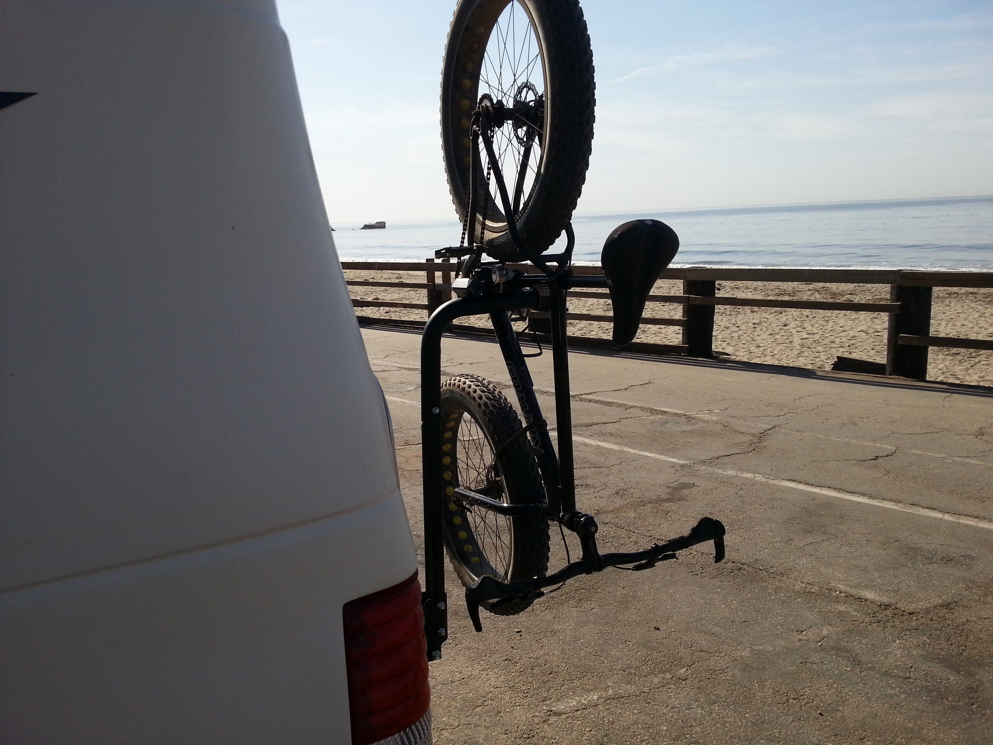

Here's what I do. When mounted vertically, I can slink out the back door. Also can remove the front tire and rotate the bars to shorten things up a bit.

What brand/model rack is that, Scott? Always nice to have a modular option (presuming that's off the shelf and slides into the hitch receiver).

The top hooks are mounted with 3M very high bond (VHB) adhesive tape and the supplied screws. The tape provides the bonding and it is incredibly strong. We snagged the bikes on a dump water hose once (ouch) and pulled so hard, it bent the hook and broke the bike wheel. The bond was not affected in any way. When I had to remove the bent hook, I cut the bond with a razor, but got impatient and pulled the last bit, and it actually pulled off some of the gelcoat! (ouch again). I repaired the gouge with marine epoxy, but it is hidden under the replacement hook. the bent hook was so strong I could not straighten it, even with a vise!
The fork blocks are also mounted with VHB tape, but also have carriage bolts with washers and nuts inside. The forks are turned inward and mounted "upside down" in the blocks, which makes the mounting much more compact by reducing the height. There is a cavity formed above the handlebars and between the rear wheels where we stuff the front wheels.
We use Velcro straps to tie the front wheels together at one point (the top), and then strap the bottoms to the handlebars and frames. We strap the two handlebars together, so both bikes and front wheels all act as a single mass attached to the wall, so it is very stable. We carried the bikes for over 20,000 miles with no troubles, other than the aforementioned water hose snag, and a couple of fabric covers shredded in the wind. We also strap the pedals to keep them from rubbing against the walls (lesson learned).

I can mount the bikes standing on the ground (I'm 5' 10") and it's not difficult. There is a twisting motion to get the tire on and off the hook, which is a little tricky at first. I have more confidence in the top hook holding the weight (after "the incident") so I don't worry so much about getting the forks in the block before releasing the weight from my arms, which makes it a little easier to load/unload.
More pics:
More pics:

That's a Husky 81146. 2 inch mount, very sturdy, it's lock-able, it has the swing down feature, even has a reflector. When the bike is there, I can get in and out. It's not ideal, and I don't want to mislead anyone since it's probably not suitable for many, but I don't mind slipping in/out now and again because I usually unload it right when I arrive at my destination; it's basically my dinghyBlue~Go wrote:What brand/model rack is that, Scott? Always nice to have a modular option (presuming that's off the shelf and slides into the hitch receiver).

Clay: Wow, I'm impressed with your system, and how well it held up to "the incident." Thanks for the details on how you mounted it, the links to the parts, and the photos.
Scott: Thanks for the rack info. That sounds like a good "off the shelf" method. Always a bonus not having to remove the front wheel. And ha ha about getting it dirty on the trail. But that's not quite the same as having it covered in bug guts and blood (well, depends on where and how you ride I guess
Good point too about how if you are going to basically stop and remove it, it's not so bad having it on the rear hitch (plus you can skinny in and out).
