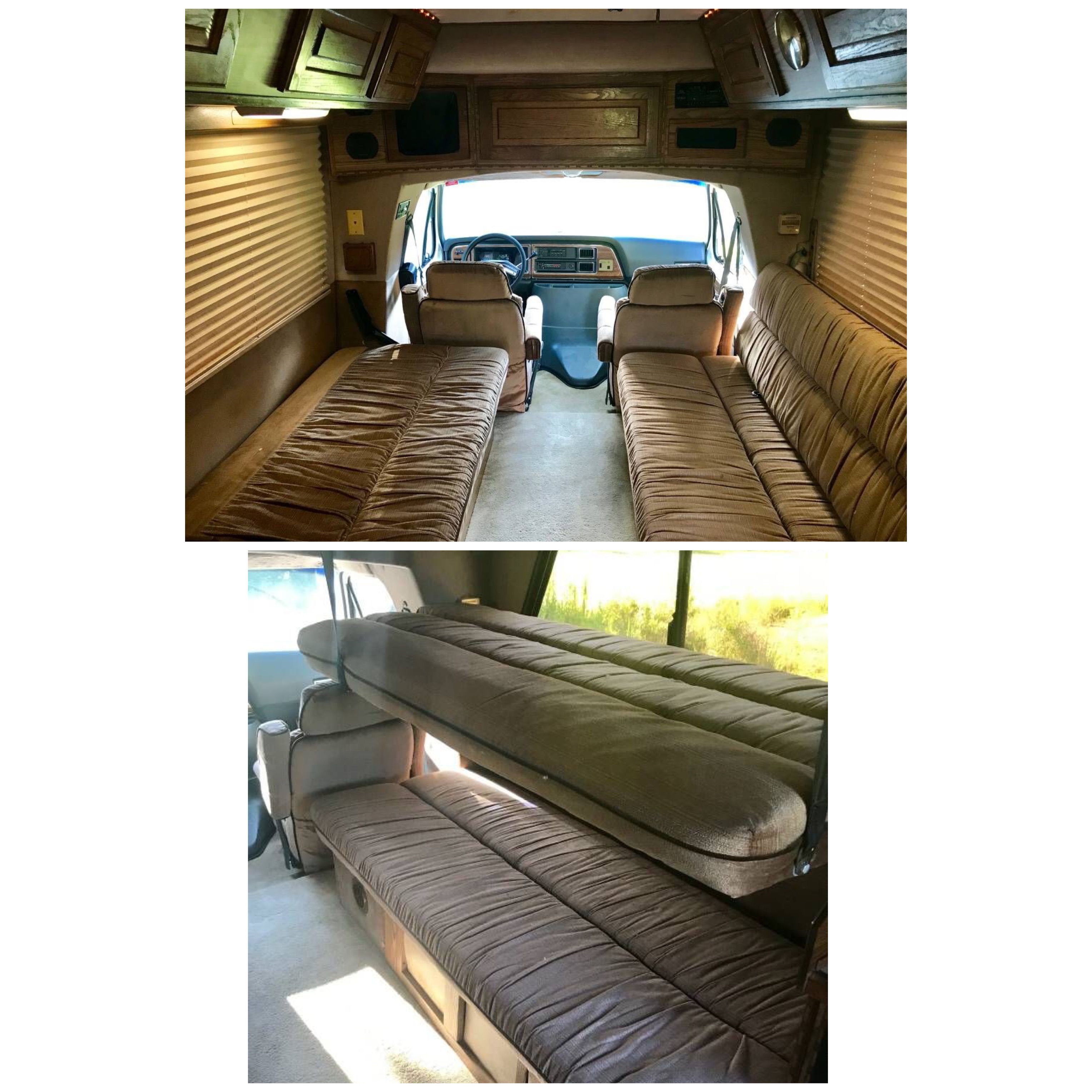

chin_k wrote:Another option that I thought about, but never actually see, is the bunk bed Chinook. I think the bunk bed is over the dinnette, but it maybe possible to add another above the sofa.
The Chinook bunk bed model had dual sofas. Because of the shorter window, the passenger side was able to have a hinged seatback attached to the wall on either side of the window.
The seatback rotated up and was secured to the ceiling with seatbelt like straps and hooks.
(Oops just noticed in the first pic that the driver side seatback pillow is missing.)
