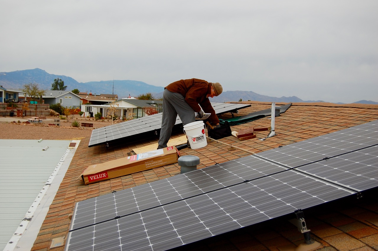

‘She who must be obeyed’ insisted the leaking home skylight get fixed before Christmas but local roofing contractors were of dubious reliability. No problem, thinks I - should just be a bigger version of my Chinook projects.

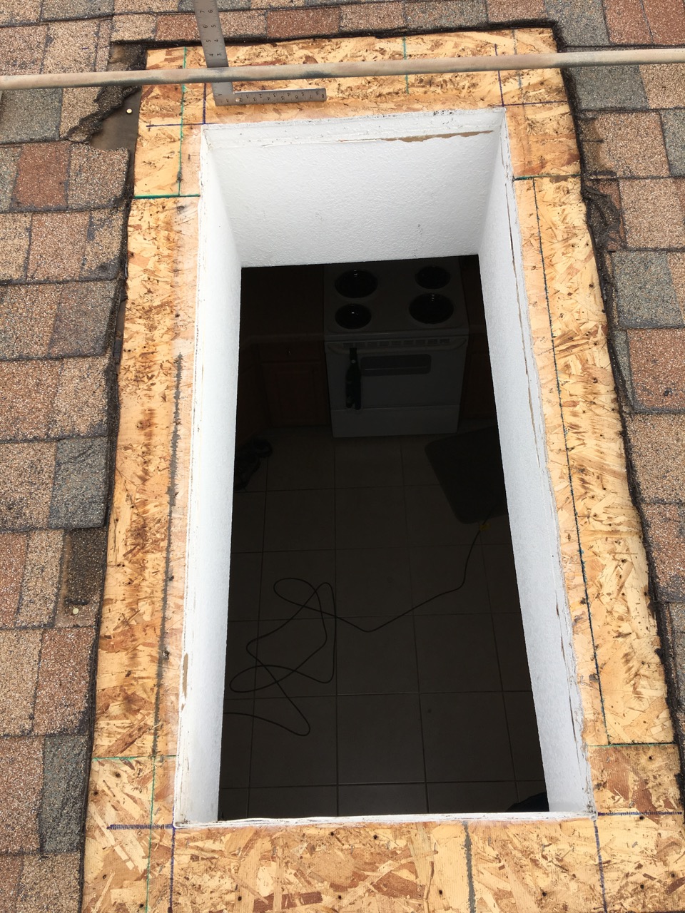

Home Depot sourced a nice new double-glazed Velux skylight for me to replace the existing plastic bubble and there was no more excuse to procrastinate. I pried off shingles down to particle board and prepared the 4’ x 2’ opening. Naturally the only rain in months was forecast that evening to increase my stress factor.
The tricky part was stair-stepping new shingles to fit the ragged opening with sufficient overlap for a leak-proof seal. To this end I applied roofing tar in vast quantities and naturally created a heinous mess on clothes and tools. My timid “Honey, I have some items for the laundry….” was not well received.
